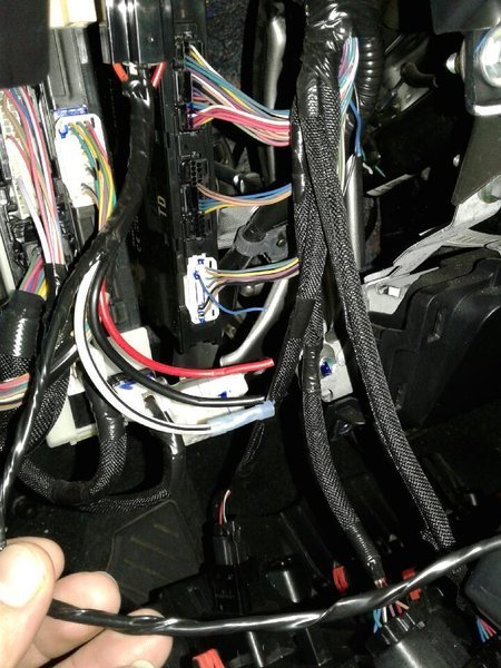

    Something was definitely installed. This is what it should look like from the factory.

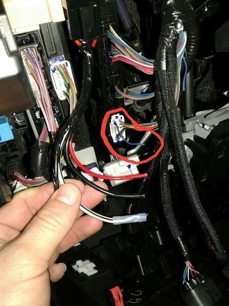

    Look at the poor blue Guy all cut and hanging solo!

    I suspect that's no Bueno either since it's factory wiring. I'll have to peak at the FSM to see what it is unless @gpb knows it off the top of his head. The dealer it was purchased from would be getting a visit.

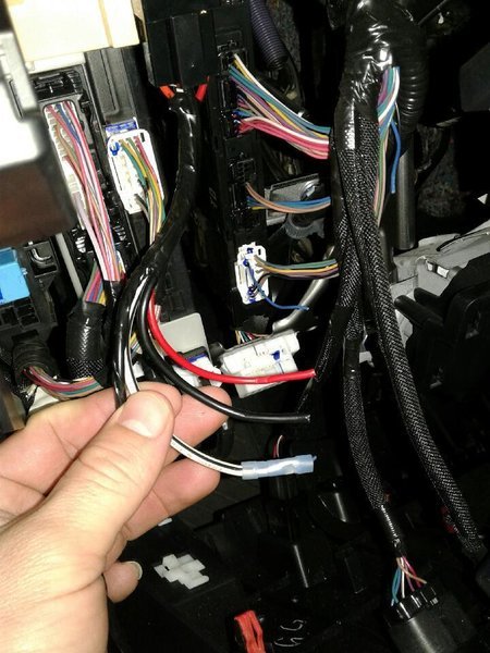

    There was a thread here a few months ago where a guy was asking about port installed options and the wire and butt connectors in his pics look very similar to yours if I remember correctly

    I'd have to look it up in the FSM too -- that's not a connector specified by either the DEI DBALL or the Fortin EVO units in their Remote-Start-Ready configuration as best as I know.
    Also there's a relay in the picture in the upper middle; neither unit uses one for this PTS tacoma either.
