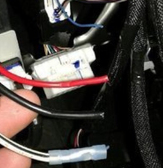

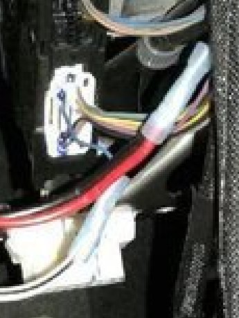

    Posted these earlier in the thread but looks like the blue stoplight switch (brake) wire is connected to the white/black and red wires in the last pic. Looks like they cut it at the butt connector at each end which explains why the wire had a clean cut. Wonder if the pothole the op hit jarred something and caused the butt connector to lose connection?

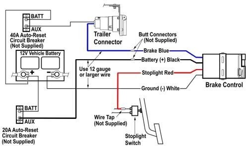

    From etrailer:
    Obviously the specific wire colors will depend on the particular brand of brake controller. The point is to illustrate that the connections seem to match up with what the OP discovered.

    Brake controller makes sense. When the 16 came out no one knew that the Tundra brake controller sub harness plugs into the Tacoma. It took 6 months for that information to spread There was no help from Toyota to hook up a controller. Nothing in the owners manual to help you either. Take the truck to u-haul or some other trailer sub contractor and you would get a cut in job rather than a plug in connector that didn't exist at the time. No one knew there was a connector in the wiring harness behind the drivers kick panel.

    Not all of them,if you don't have the jumper harness people will splice in the wires or if someone installed a used one where it was previously spliced in.We remove them all the time when trucks are traded in and we see them all the time spliced in instead of having the jumper harness.

    yeah, would make sense for it to be a brake controller. Been trying to find one that requires cutting the stoplight switch wire but I'm drawing blanks.
    hmm...different vehicle but wonder if it's related to something like this. https://www.etrailer.com/question-70945.html
