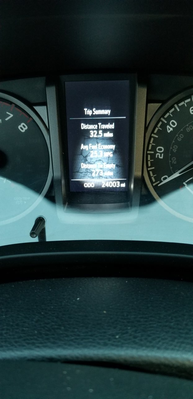

    So, as a test last night, I put 93 Octane into the truck, using Irving as the fuel company. The 40-65 hitching is almost completely gone, and to top it off, better fuel mileage also. Not quite sure what's happening now. Guess I'll be calling Toyota again today with an update and see how they explain a fuel octane change effects my lift kit.
  8. Sep 27, 2018 at 3:40 AM
    Mack7n
    Mack7n [OP] Well-Known Member
    Oct 12, 2017
    #232767
    600
    Josey
    Old Town, ME
    2018 Tacoma TRD Sport DCSB 6M BBP/2018 T4R TRD Pro Calvary Blue
    Normally get 23mpg on this trip.
