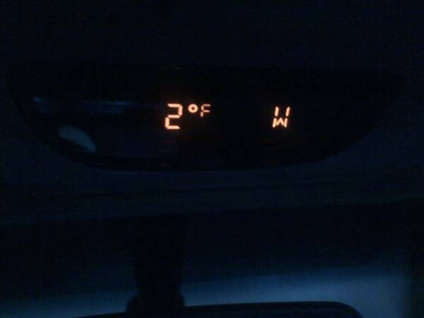

    I just talked with Toyota and they are going to look at it tomorrow. I had this thing fail on my today. I also put in LEDs for both my map and dome lights. (The problem did not coincide with the install). Thoughts on switching them back for the trip to the dealership?

    What happened with the overhead? Mine has acted up a couple times. But then all of a sudden, it will set itself right.

    Yep...it was all better this morning. But thanks to my pics the dealer trouble shot it and it is a faulty sensor. Part on order...It should be done this week. Sucks I think I will wait to put the leds back in.

    If you can get the part number and location of that sensor, i would much appreciate it. Mine always reads really high, when its 85 for real out, it reads 101.

    Sorry the part number was not on the sheet. I will post when they do the install. I believe the sensor is located near the grill. I remember hearing that somewhere on here.

    Ok the part number for the thermistor is 88790-22131. it is in the front bumper cover. I looked them up...they are cheaper than I thought.
