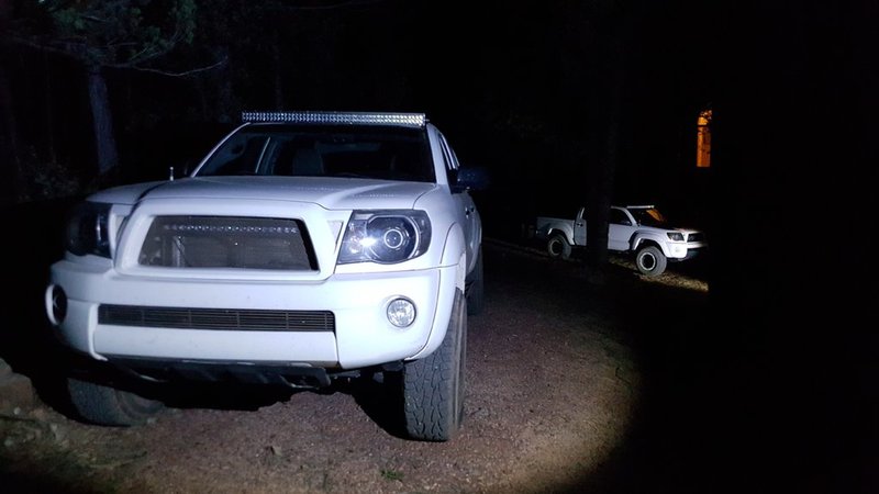

    This is my temporary LED bar mounting. I will move it underneath the rack very soon. I want to finish up the wiring while I figure out the details ...
    top front view - as you can see, the X-Clamps will not work.
    drilled a hole:
    mounted the bar
    weather strips are back on
    I will get to wiring soon.
    Next on the agenda: mount the bar underneath the rack. Any ideas? products? please let me know.

    Here's what I was thinking if you're brave enough: since your LED bar has the "locking" mounting tabs (that clock the bar in position when you tighten the bolts) you could consider radiusing the mount itself to the contour of the tube on the front of the rack and drilling holes for hardware that go through the bar diagonally from the rear of the front tube (similar angle as the windshield). That should position the top of the light just underneath the roof rack and allow for things to be carried on the roof rack that may need to extend past the forward tube and not interfere with the light. (Not sure if I'm making any sense). This is what I'm planning for my roof rack project. I'll see if I can sketch up something to give you a better idea.
    Or you can skip all that, ditch the mounting tabs that came with the light and weld new tabs in the lowered position. This is easier and would look cleaner, but understandably most guys don't want to cut, drill, or grind on fresh powdercoat. I figured since you drilled a couple holes already, you got the cajones.
