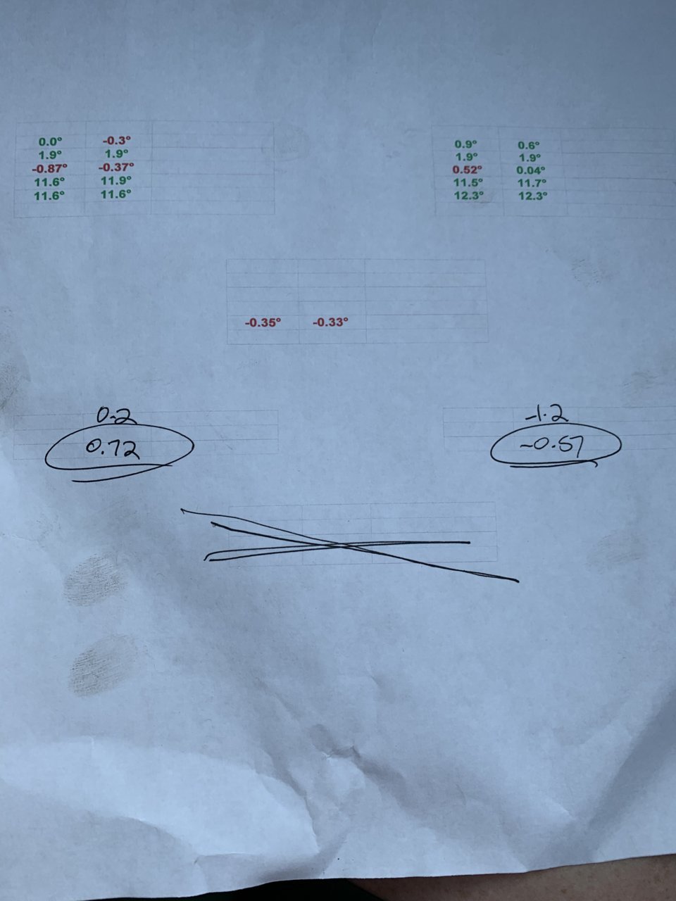

    Here’s the expert report. Lol .52 off. The lines at the bottom are supposed to show how the axel is off. Picking it up now haven’t checked anything yet.

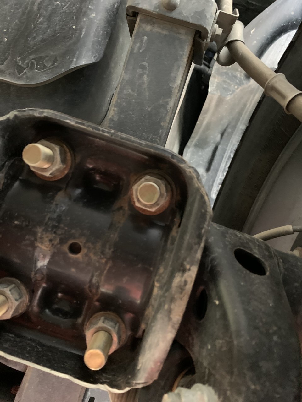

    Just did a a quick glance and couldn’t find anything obvious. Husbo will drop the springs this week. I’m frustrated. I hate it when I can’t fix my stuff.

    2017 White SR5 DCSB V6 4x4
    Take a look from the top, where the leaf pack rests on the axle.
    rimfire7[QUOTED][OP] likes this.
  20. Jul 27, 2021 at 9:55 AM
    #40
    rimfire7
    rimfire7 [OP] I'm here for the tacos
    Dec 13, 2020
    #349474
    794
    beth
    2021 army green taco
    Toytec lift, old man emu springs, Victory 4x4 front bumper and skids, light bar
    OK, what should I look for? uneveness and broken components?
