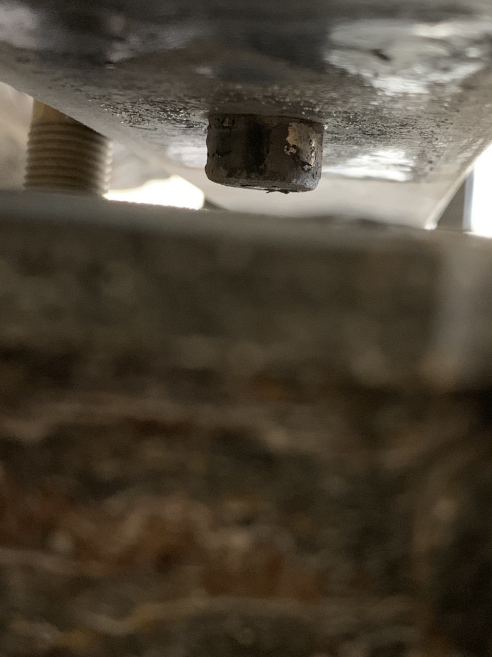

    Here is the leaf spring pin on the drivers side. It’s banged up and scraped up. Got some jagged metal at the bottom.

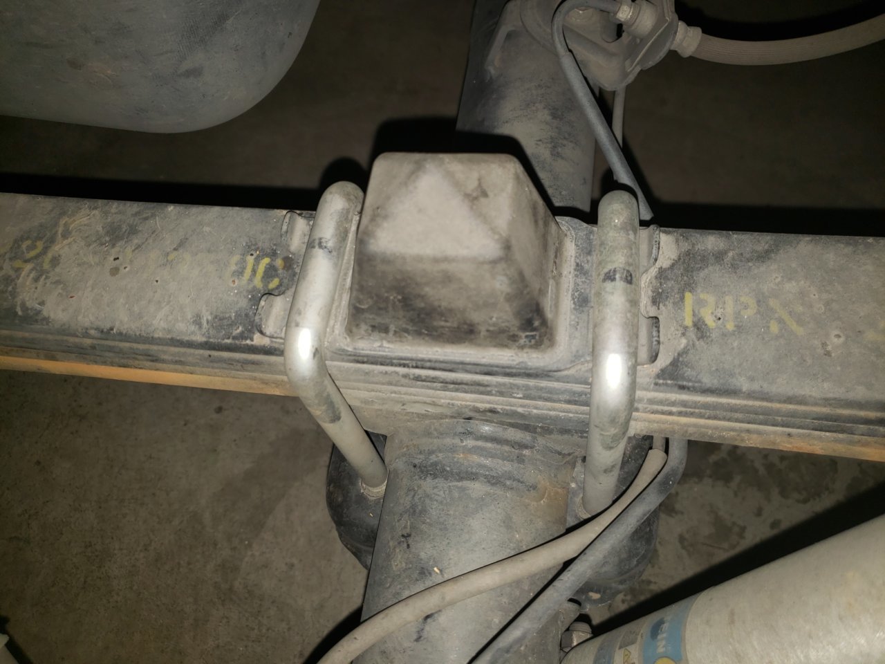

    Current situation. Putting the passenger side together now

    You should be able to measure from the center of the front hub to the center of the back axle hub from side to side. That should give you an idea if the axle is square.

    Pics of the driver's side clearly show a gap between axle and spring.
