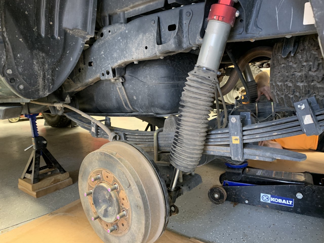

    Husbo and I put the suspension on and then got it aligned. Nothing back then but I’ve had it wheeling since then.

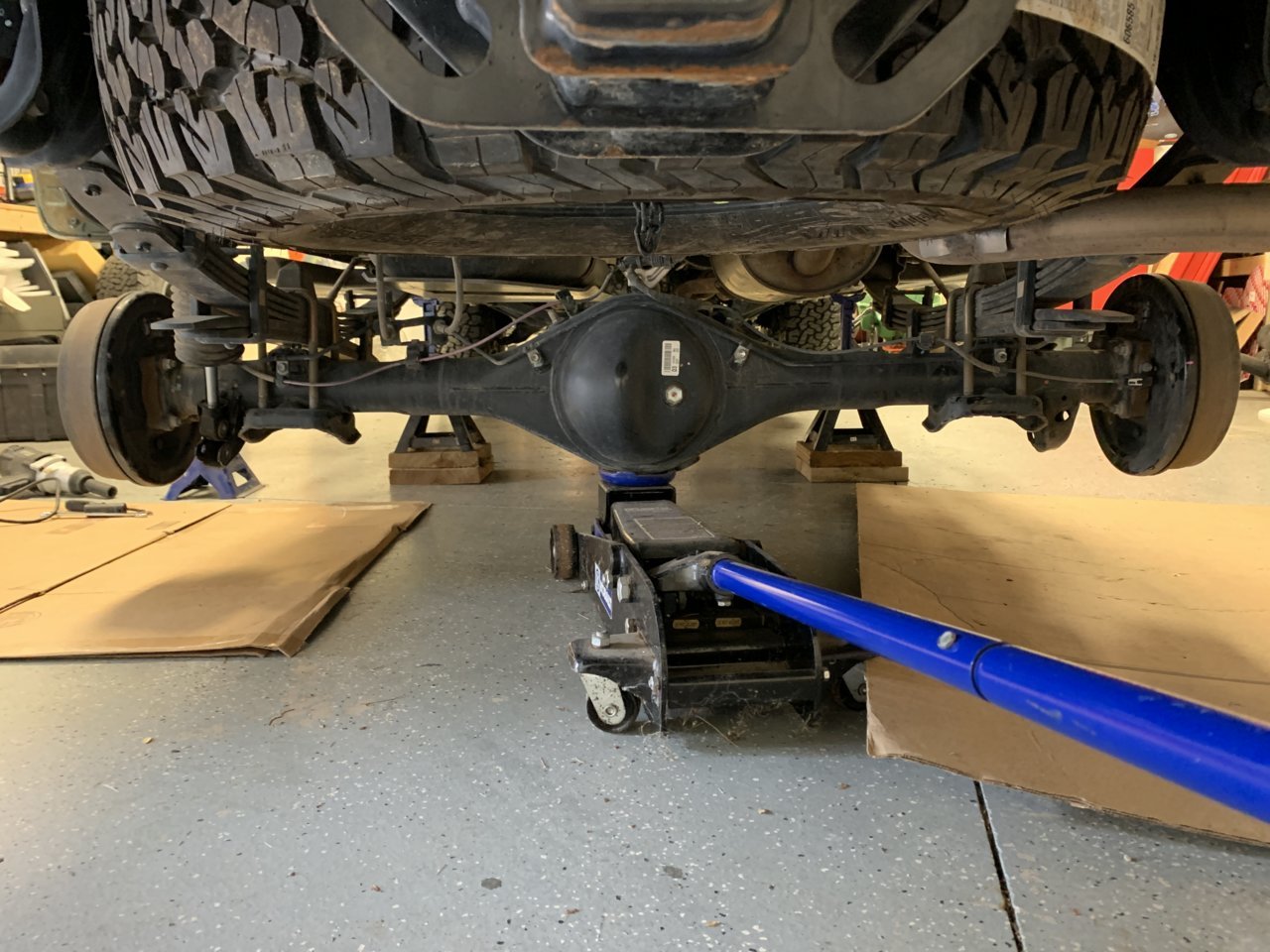

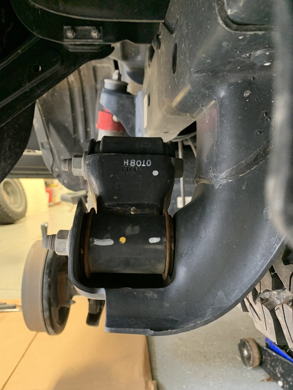

    Have it all put together. Might be a 1/16th or 1/8th off. Using a tape measure. Pic of the tech.

    ROAD DOG
    ROAD DOG Well-Known Member
    Nov 4, 2019
    #309830
    2,212
    2019 I4 WHITE SR PRERUNNER
    FEW
    the dealer will probably beg off a direct result of the aftermarket installation
    photos show & its a given the axle is tweaked
    a very good 4 Wheeler shop located near U with much experience is a bet
    Ur hubby with a bud & a good tape measure can determine how much out U are
    it took a hard hit
    getting it back might take at least spring set 1 side
    rimfire7[QUOTED][OP] likes this.

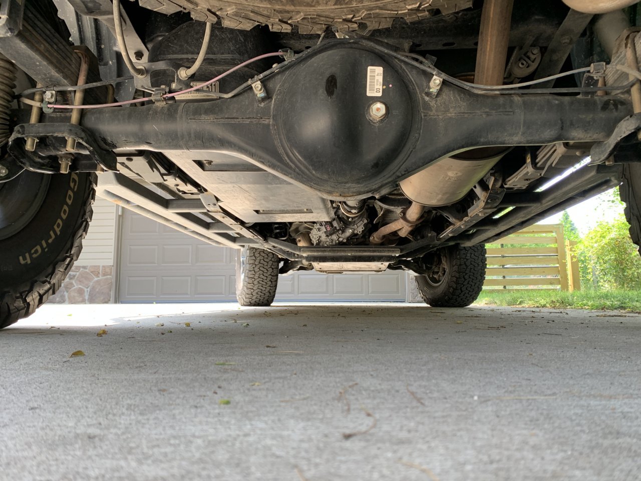

    1st pic -see the gap . The leafs were not sitted on the hole.

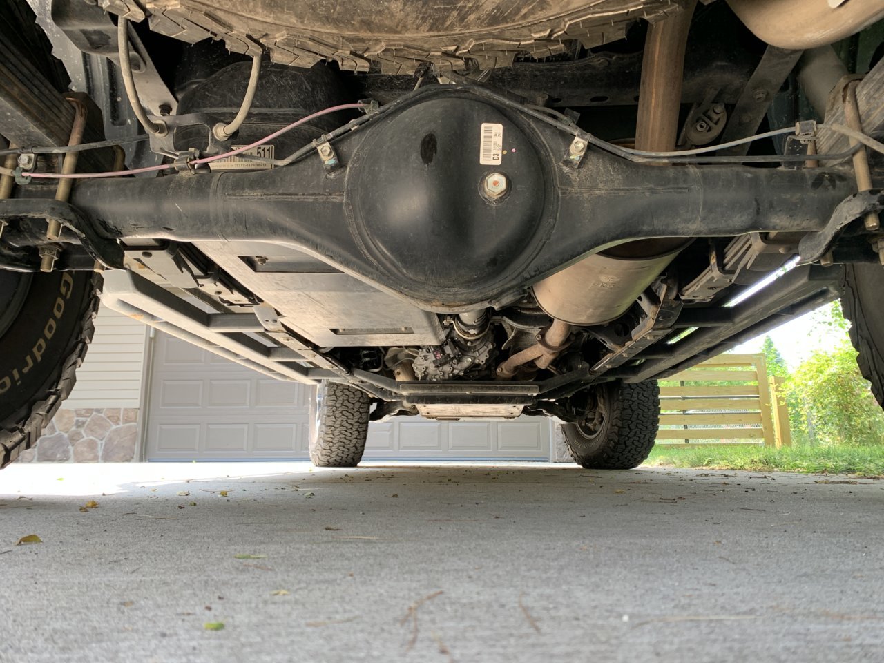

    quick ramen break and i take a finished pic

    yes we disconnected the shock and lowered the axel a lot and jiggled the leaf springs and then reinserted the pins and tightened it all up again.

  11. Jul 31, 2021 at 8:57 AM
    #71
    ROAD DOG
    Nov 4, 2019
    #309830
    2,212
    FEW
    measure from a point U are sure both sides of frame that are straight & square
    measure back to from hanger of spring mount.................same measurement U r 1/2 way there
    maesure fromthose points both sides of frame to axle
    same = good
    not at least U will know how much out ...................
    if all good be certain everything is torqued correctly

    Finished for now. More to be revealed.

  17. Jul 31, 2021 at 9:19 AM
    #77
    ROAD DOG
    Nov 4, 2019
    #309830
    2,212
    FEW
    on many a new vehicle some are Not straight square
    sorry I didnt mention U might have to loosen the good side to square up the tweaked side
    im not there so my a to z aint workin as well as it might
    a tape measure gets U close......................best place to start
    rimfire7[OP] likes this.
