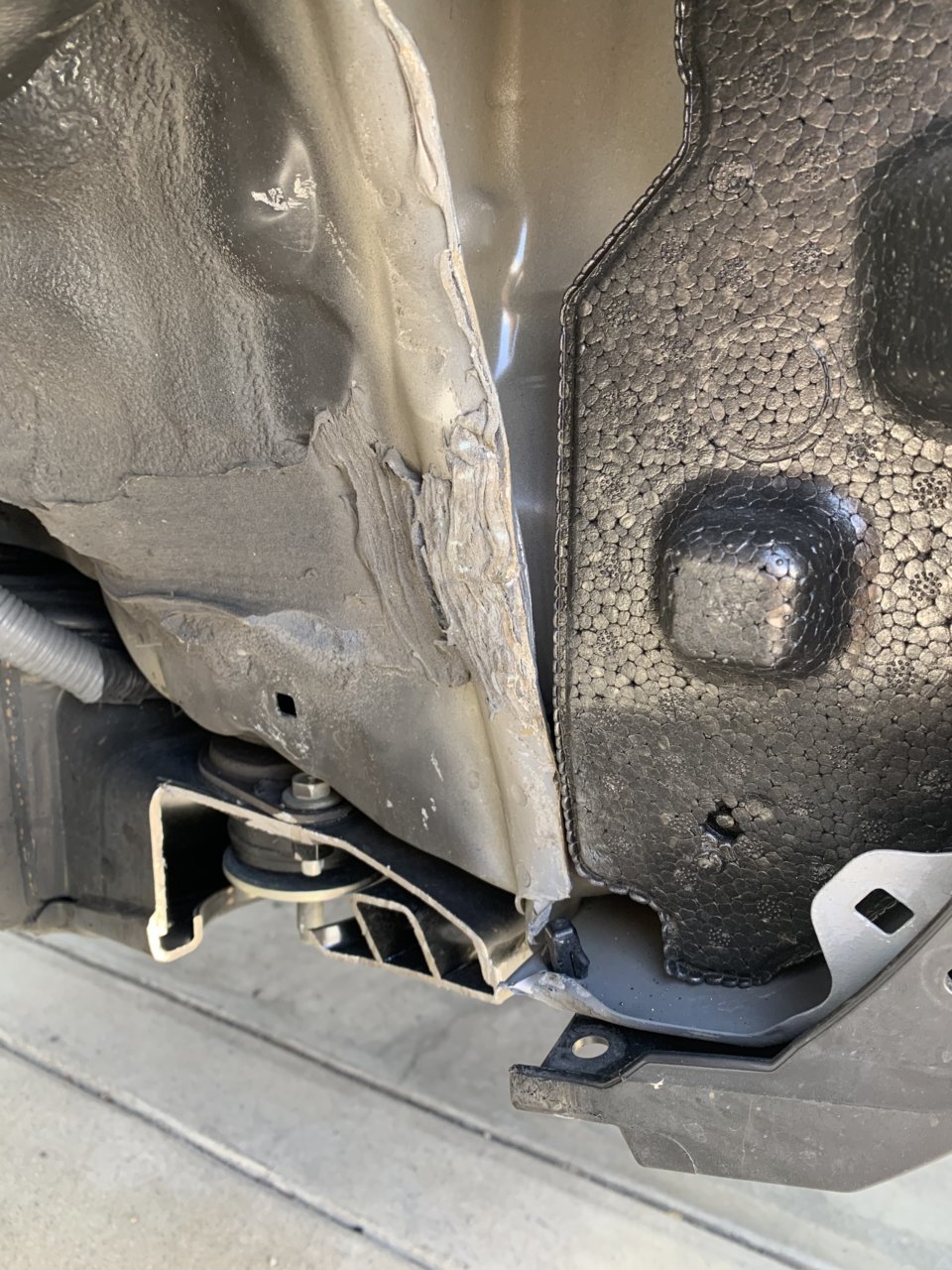

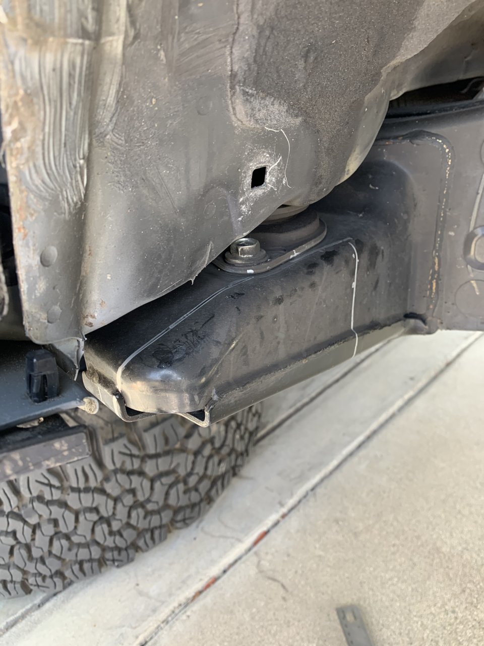

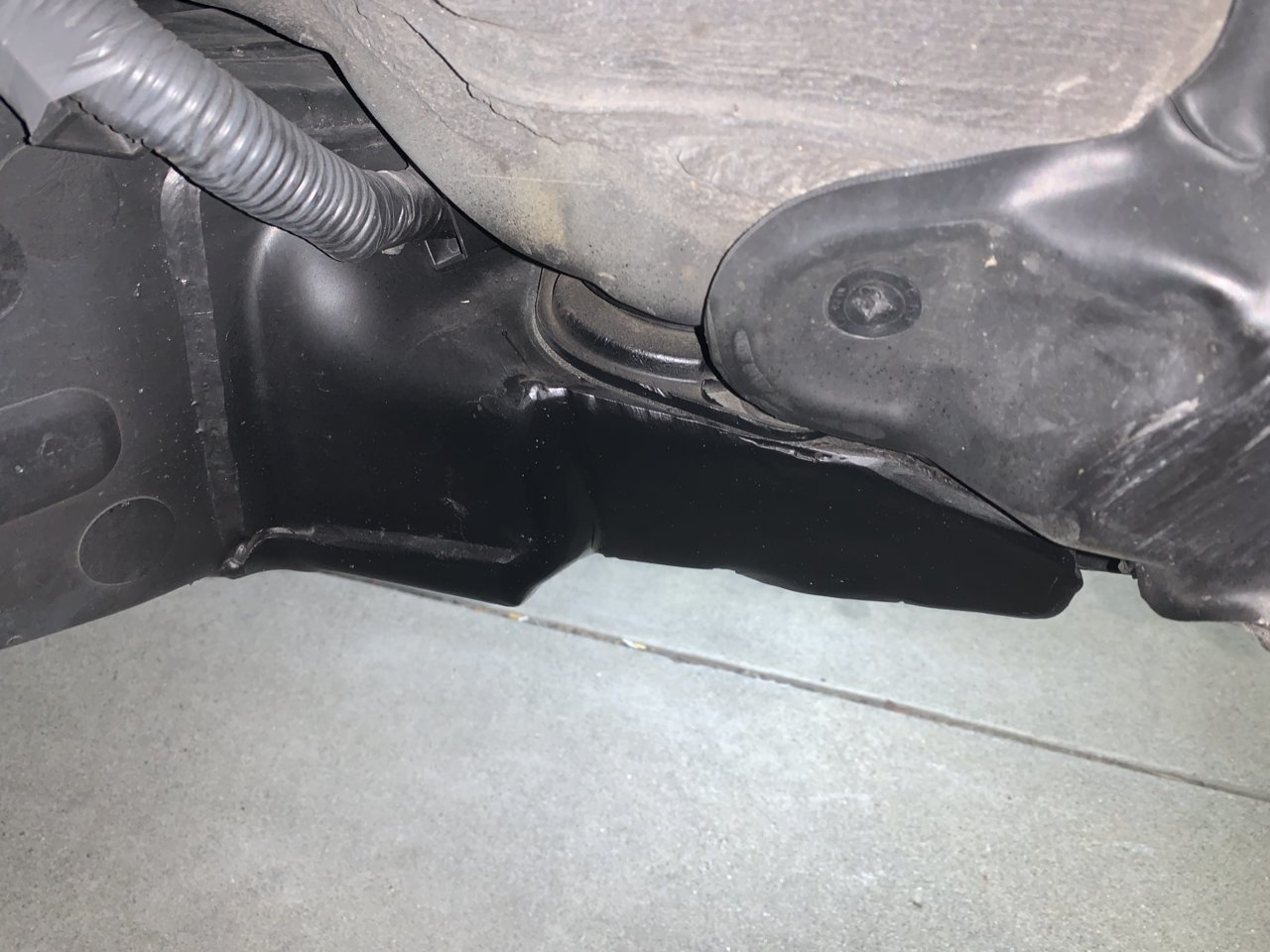

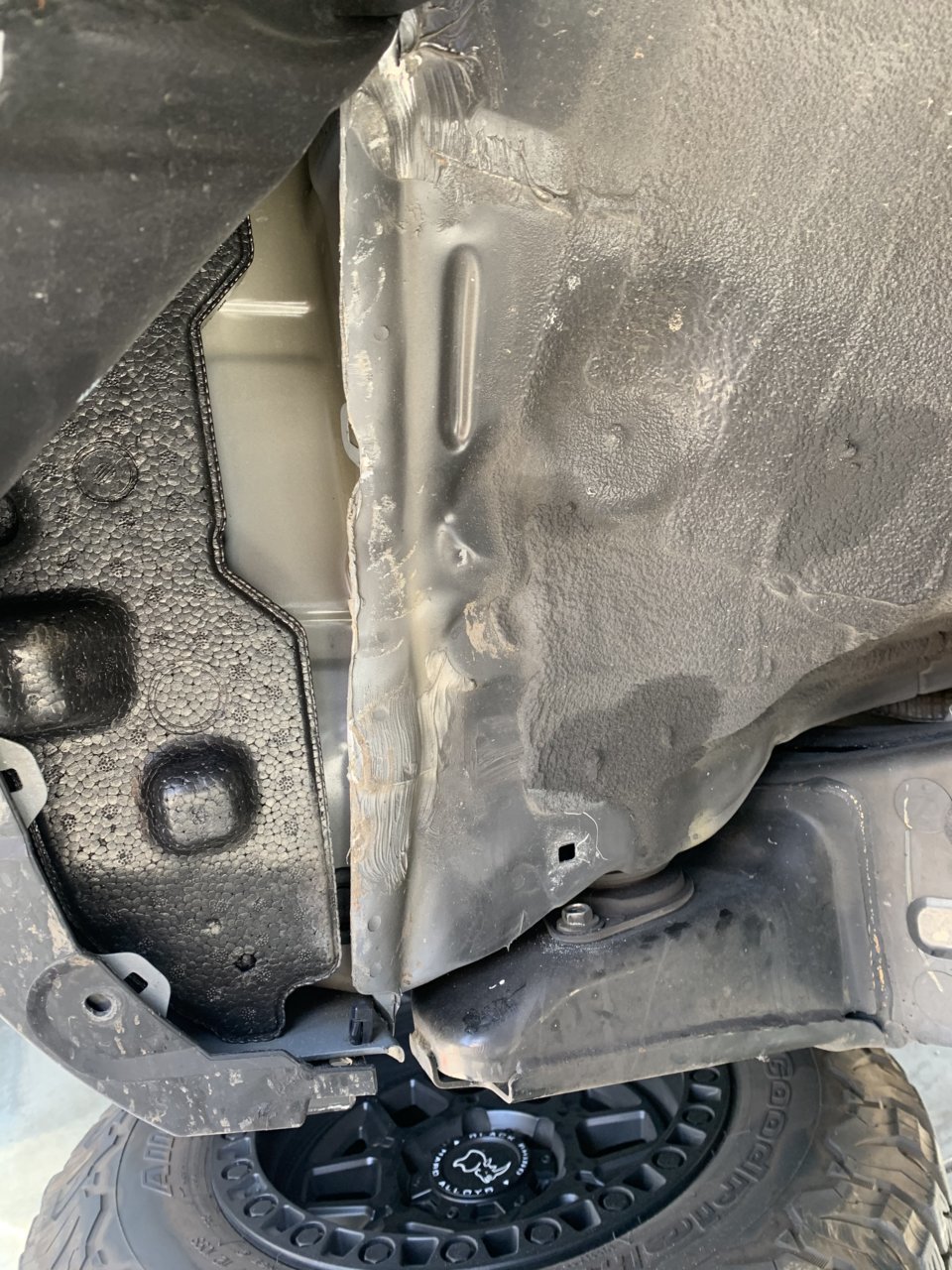

  6. May 5, 2021 at 1:37 PM
    Tcodyw88
    Tcodyw88 [OP] Well-Known Member
    May 5, 2021
    #364823
    281
    Cody
    El Segundo, Ca.
    2020 TRD offroad
    If you fold the cab seal to the outside you don’t need to make relief cuts.
    I used a reciprocating saw and made a angled cut (to give max clearance) from the bottom following the shape of the cab. And a connecting cut from the front.
    then cut a plate out to shape
    Squirt some welding wire around it and grind it out. My flip disc for the grind wore out so forgive my poor grindin. upload_2021-5-5_13-37-25.jpg

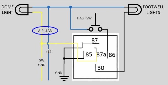

  13. May 5, 2021 at 2:08 PM
    Tcodyw88
    May 5, 2021
    #364823
    281
    Cody
    El Segundo, Ca.
    2020 TRD offroad
    One of the most useful mods I’ve done I love it! I tapped into dome light which can be set to active when the fob gets close if the truck is locked. I’ll put together some pics and drawing for how to wire the relay with a in cab switch as well so they could be used as rock lights without having the dome light on. It’s worth noting that the dome light is controlled by the ground wire contact. This means the light always has power until a switch or relay makes the ground contact. Just FYI

  15. May 5, 2021 at 10:39 PM
    Tcodyw88
    May 5, 2021
    #364823
    281
    Cody
    El Segundo, Ca.
    2020 TRD offroad
    Here you go buddy
    If your fob actives the dome light when you approach then this will definitely work for you as approach light.
    shadowler[QUOTED] likes this.
