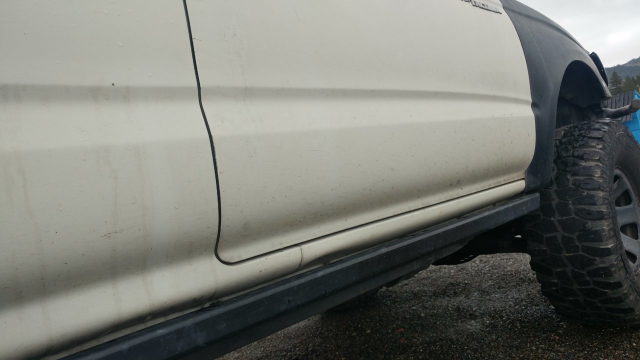

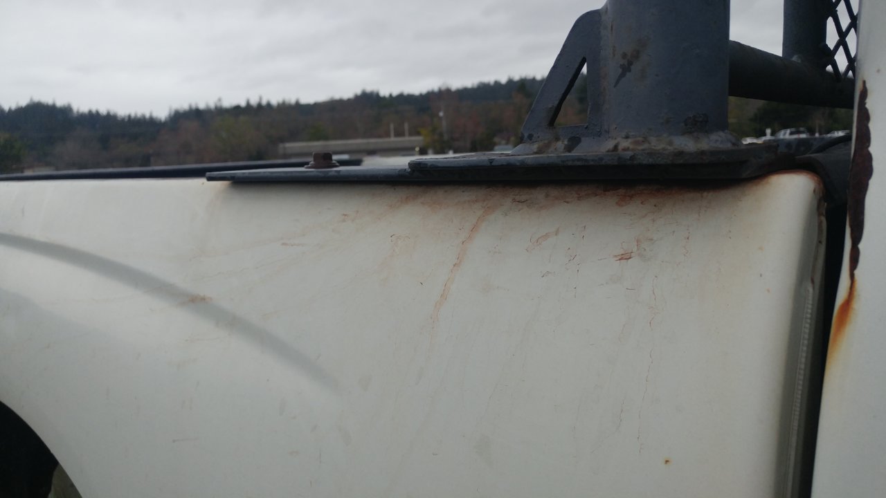

    Hey everybody does anybody know how to clean old rust and dirt stain i never wash my truck i let the rain do it type of guy anyways been waiting to wash my truck but dont think a simple wash will clean it. Wish i could get a small shine back to it

    You can stop the rust by using a rust converter. I know that making a white vinegar based slurry using Bar Keepers Friend (powder form) works on tools, etc... Use a tooth brush as an applicator. I've never used this on a vehicle but it works on everything else so why not give it a shot? However I would tape the area off to keep this stuff off the area that has paint. Use this only on the rust exposed area.
    As for the reddish brown rust stains on the paint, that's a whole other issue. I suspect that the rust migrated into the paint and there might not be anything you can do about it other than to repaint the truck.
    The big thing is to stop the rust though.

    Thanks inferno, i need to take off my headache rack and see full damage and stop it

    The Bar Keepers turns the rust to a black color. I think it converts the rust to phosphorous oxide, which is stable and stops corrosion. Then you can spot paint the area or keep it as is. Just be sure not to get the Bar Keepers on your paint because it is abrasive, but it's a mild abrasive. It's also handy to have around the house.
    The important thing is to stop the rust.

    A really good 2 bucket hand wash first then a clay bar might help !

    Wash the truck
    Treat with an Iron X spray.
    Clay bar the whole thing
    May need to use a polisher to clean it up.
    I would not use Bar Keepers Friend. That stuff is virtually commit and is as abraisive as wet sanding.
    They have rust converters that are paint safe no need to use a product intended for entirely different uses.

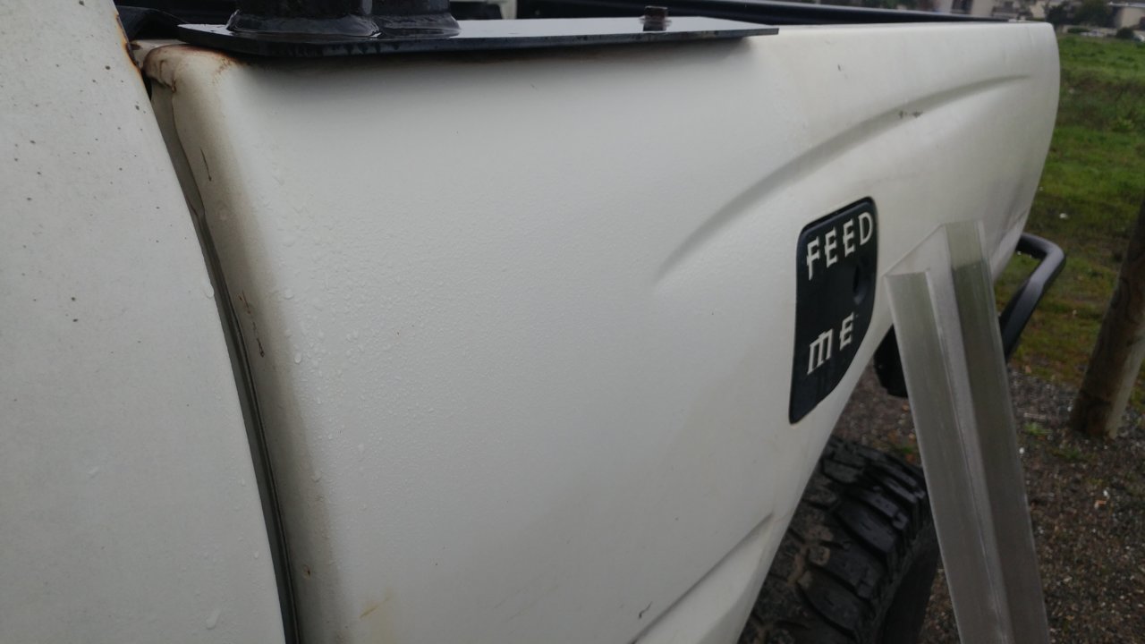

    went to my mechanic shop and he put turtle wax hard compound on in a small area with no wash and looks almost new, ill have a pic 2m just to show others with this problem but the bigger pic is the rust on the cab but that'll be for another time plus my headache rack is causing the blood stain so that also needs to be fix or else the cleaning would be useless

    Here it is on the other side of the pics i had up before not a big area but the top of the bed u can tell its wayy cleaner then the rest

    Be real careful with Turtle Wax Rubbing Compound! Although it will temporarily remove the rust stains, it also removes a good deal of paint along the way. And it's aggressive enough that although the surface looks cleaner / better, there's probably a good deal of marring now that will need further polishing to really make it shine.
    I too would suggest first taking the rack off and dealing with the source of the staining. Clean it, sand it, neutralize the rust, then prime and paint it to prevent everything from starting all over again. (And that's going to be much harder than it sounds.) While the rack is off, use a product like Iron X to dissolve the staining on the paint. Only then would I look into clay and polishing steps - followed by a wax, synthetic sealant or coating to protect the new surface.
