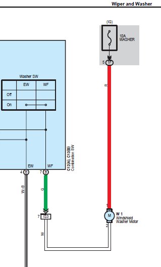

    I need help and I’m completely frustrated. I have tried everything. I removed the washer motor and connected power directly to it and it works. The fuse is good and I’m getting power to the motor but when I connect it nothing happens. I also checked the wiper switch lever and I have power there. What am I missing??

    Ground? You have power... what about ground.

    The other terminal of the connector should have no resistance to ground when checked with an ohmmeter.

    Switched ground... good to know:thumbsup:
