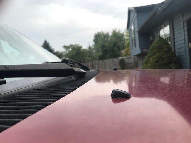

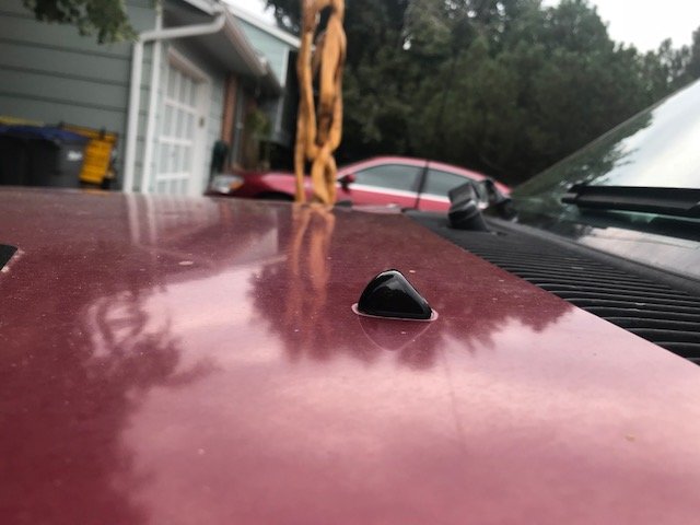

    It’s a direct fit. Including the hose on bib.
    The Odyssey nozzles sit just a bit higher off the hood and it’s footprint is slightly smaller (see the paint line around the nozzle below) but they snap into the cutout perfectly.
    Odyssey nozzle:
    Tacoma nozzle:
    skeezix[QUOTED] and Black97v6MT like this.
