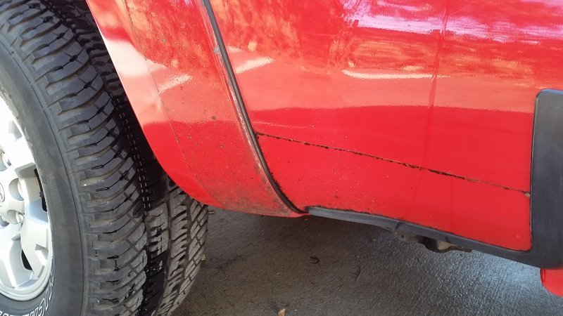

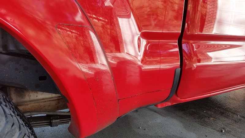

    I gave my truck a bath today, and I have a question for you guys. Just in front of the rear wheels there is some kind of protective film. It's pretty nasty, especially around the edges. Scrubbing it with plain soap and water didn't do a thing to clean it up. I was tempted to remove it, but it probably helps prevent some dings. What do you use to clean it? Alcohol, lacquer thinner, mineral spirits...???2017-01-31 15.15.04.jpg 2017-01-31 15.15.16.jpg

    Try using goo gone, rubbing alcohol, a clay bar, dish soap. Your fingers nails lol

    Rubbing compound?

    Rip it off with hair dryer and goo gone.

    Goo Gone, lacquer thinner, mineral spirits and other solvents may solve one problem, but create others. The clear film is there to prevent stone chips. Removing it may solve the "ugly clear film" issue, but it will expose those stone chip prone areas to damage. Most solvents will loosen the adhesive holding the film in place, so I'd advise not using them. If you have to use one, mineral spirits is probably the least aggressive. Lacquer Thinner is actually hot (aggressive) enough to damage your paint.
    From what I can see in your pictures, it looks like you might actually have mold growing at the edges of the clear film. If that's the case, you can use Clorox Cleanup or Mold Remover (available at most Marine Supply stores.) Spray the product on and let it sit for a minute or so. Then spray some more on and lightly scrub the edges with a soft bristle brush. That should remove the mess at the edges of the film. Then you can decide if you want to remove it entirely. To do that, heat the film up with a blow drier and slowly peel it back.

    I would think a real fix would be to remove the old clear film, clean and reapply new film. The edges on the old film appears to be letting dirt and grime in and getting trapped.
