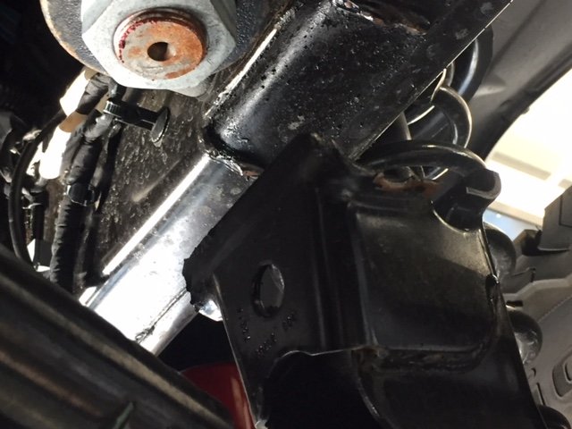

    These are machine welded right? My guess is a calibration was off for locating the welds.

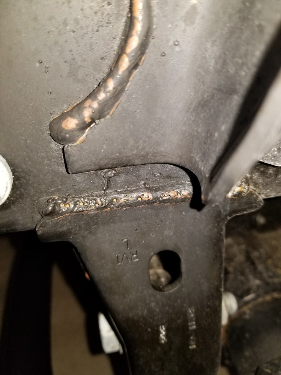

    Whats weird is that there seems to be 2 issues here, misalignment of the welds, and porous welds. The porous welds are probably from a lack of shield gas. Likely someone in QC shit the bed. Also what are all these comments about perferring human welds to robot welds? While I agree i perfer human welds, i highly doubt any car manufacturer is not using robot welding, let alone a car manufacturer building vehicles in north america like toyota.
