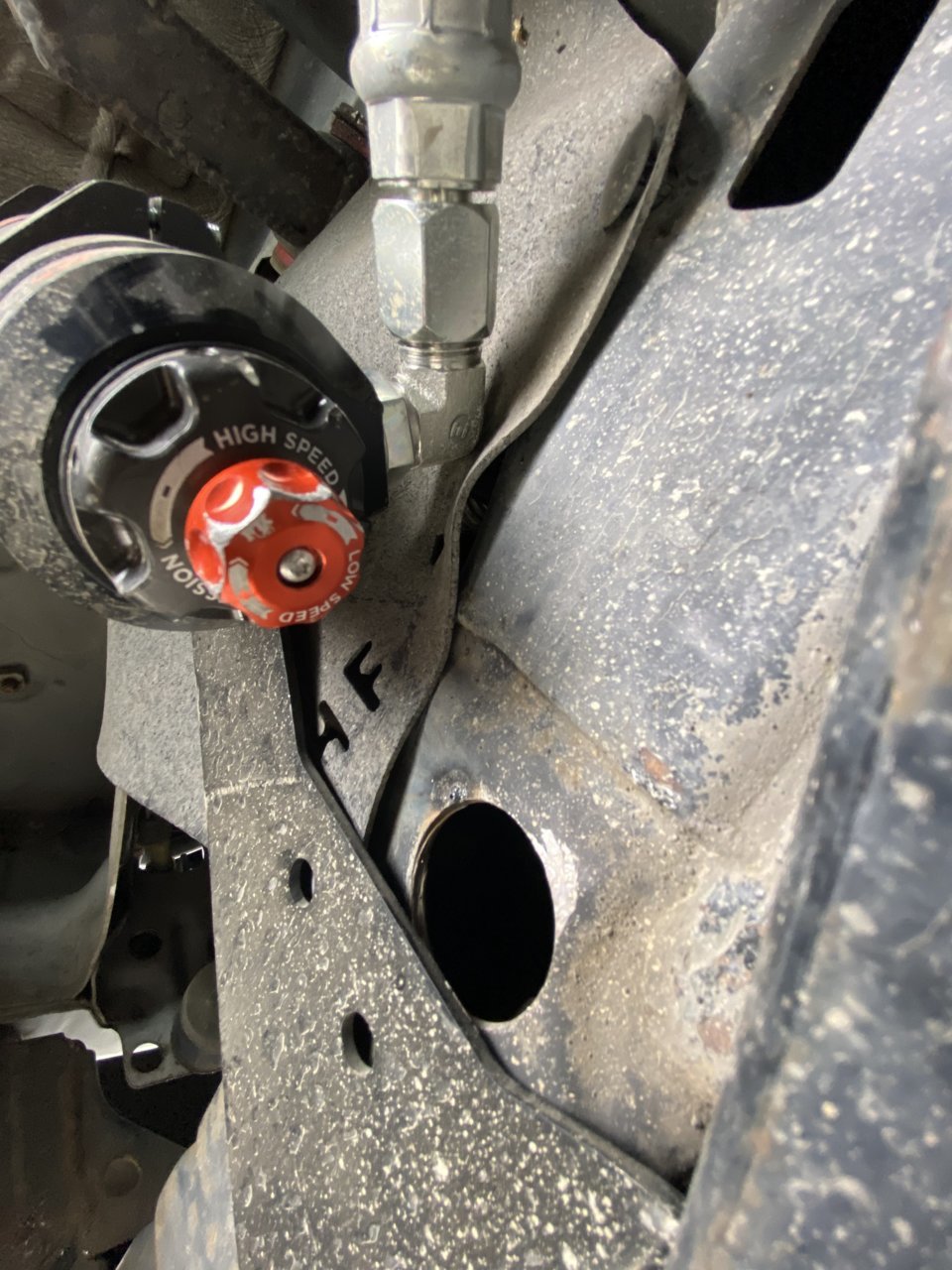

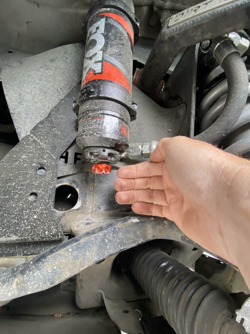

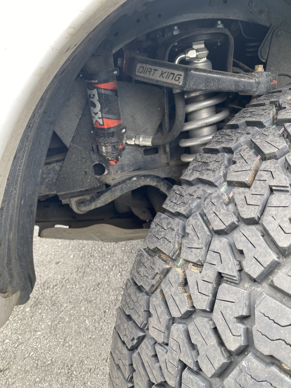

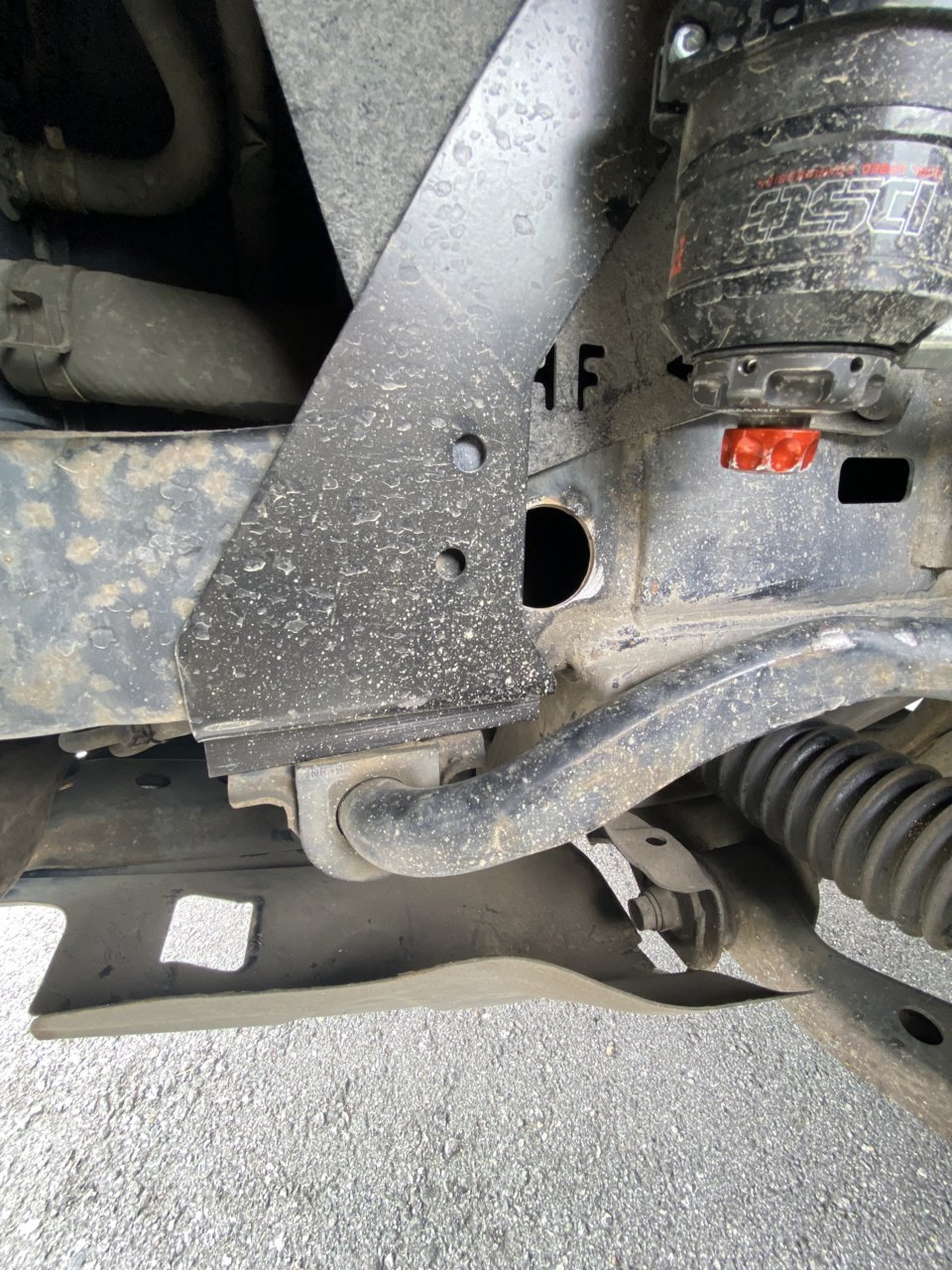

    I'm having the same problem with 2.5s I just installed on my 08 Tacoma. Talked to Fox yesterday and they just said It looks like raising the resi's 1/4" should clear it. Doesn't seem that way to me. I'm thinking of cutting a triangle slice out of the bracket and re welding so the resi sits at an angle tilting the bottom forward. I'm hesitant to take the sway bar off completely, I took one off my bug as a kid and really regretted it because of the increase in sketchy body roll. Different, I know, but similar concept. For those who have done it is it really un-noticeable on road? My truck is a daily driver that I only take off road a couple times a year, despite my dreams of off-roading every day. image_67235585.jpg image_67182337.jpg image_67202305.jpg image_67194113.jpg

    I'm installing mine now. I hammered the wheel well up where the resi makes contact so I can mount it up even higher. I'm hoping this will keep it from hitting the sway bar.

    I'm thinking about disconnecting the swaybar from the spindle and rotating it up by hand to see how close it is. Seems like its hitting by more than just a little bit but its hard to tell.
