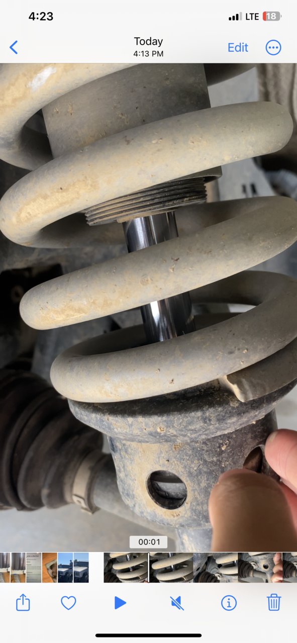

    Update! New problem appears on Fox 2.5 PES. A end cap on shock body failed off and now sitting on the rubber bump. Shocks are rebuilt by @AccuTune Offroad 3 months ago. Anyone have same issue or any thought on this? I don't know if it's the installation issue or just poor design. Now I question myself about choosing fox instead of king or even icon. This might be a rare case so I am not trying to say fox is bad. It just give me a very bad experience overall.

    Sorry for the late reply, I was out of town. Have you reached out to our sales team yet about this issue?

    Problem already been solved! Problem is not caused by fox this time. Bad spring bowing and knock the end cap off. Still frustrating to receive bad springs and scratch the shock body. But @AccuTune Offroad did a good job replace the spring and check the vehicle for me free. Pretty good customer service btw.

    Thanks for the update and glad we got you taken care of!
