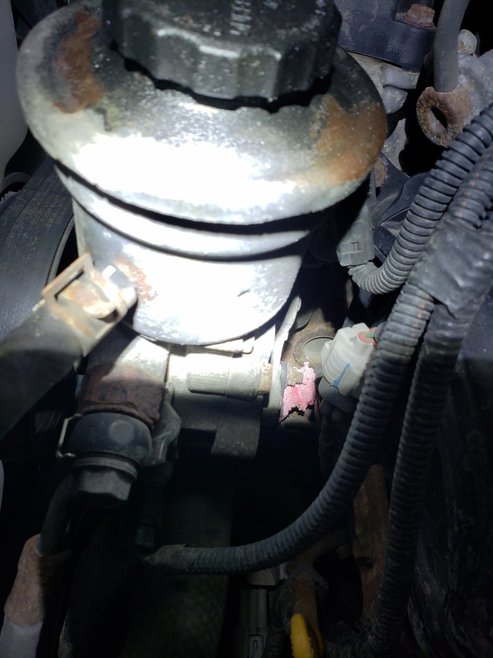

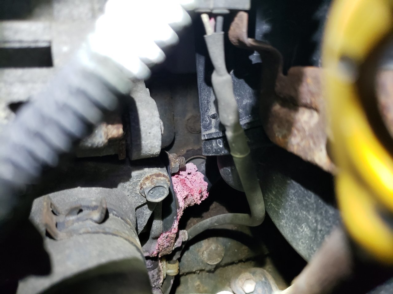

    When putting in the new bypass pipe, does anyone know if there is a specific orientation for the gasket? - Just wondering, dont have the parts yet, plan on doing this job soon on mine, as it looks like a have a leak.... (pic to come).

    Yes there is a specific orientation. The gasket has a “bulge” and you’ll put that face in the pipe.

    JB weld or epoxy might help in the interim, if you can't get to it right away. Clean it off as good as you can and put on some layers for buildup and support at the site of the crack. Also to temporarily reduce the leakage, you can relieve the cooling system pressure by unscrewing the radiator cap just enough to break the seal -- there are tabs on the cap to keep it on the neck after the seal is broken. It's more likely to boil over without pressure, but this would be better than losing all of the coolant if that pipe actually breaks. Again these are just crutches to hold you over until a proper repair is done.
