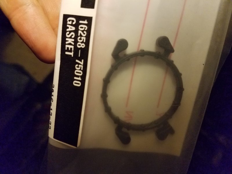

    1483500148029-347083393.jpg Hi I just started having the same problem a couple weeks ago. I got the parts in for the bypass I got a completely different type of gasket mine is a 2007 tacoma prerunner 2.7 5 speed manual and I saw on an earlier post. And I was wondering is there a notch or something on the inside of it where the thermostat housing is or what bc I don't see how it's gonna go in on it. It's kind of a thick plastic. I've done some Google searching and haven't came up with much except for a photo. Thanks

    If you still have the plastic/composite bypass pipe that would be the correct gasket. However if you have a metal bypass pipe that would be the wrong gasket and would need to look like a football made of rubberized sheet metal with a hole on either end.
    Also be sure your bypass pipe does not have a middle mounting tab. If it does it may work but is actually for a different engine all together.

    2.7taco thank you for the wisdom on this. I was given the metal bypass and glad I stopped in here thank you again I will now be getting the correct gasket for this job

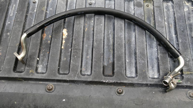

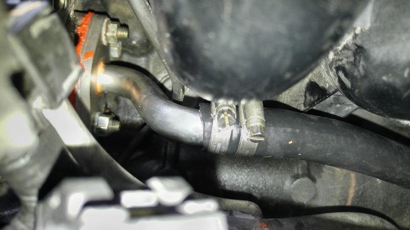

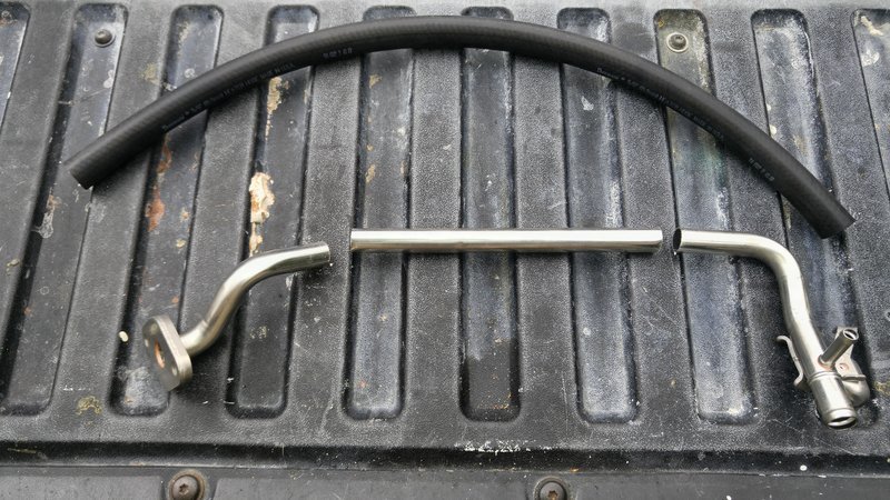

    Hi -- I just joined and needed to replace my cracked 2006 tacoma plastic coolant bypass pipe with the factory stainless steel pipe. I read Fabricator's post above, and managed to remove the plastic pipe and install the new stainless pipe WITHOUT removing the exhaust manifold, starter or wheel. I basically cut the center 9" out of the stainless steel pipe and replaced it with 5/8" heater hose. I double hose clamped the hose onto the ends. See photo(s). 20170218_110343.jpg 20170218_111420.jpg 20170218_142946.jpg 20170218_142951.jpg

    That'll work but keep in mind the reason manufacturers use hard pipe for something like that is reliability. Far less chance of it springing a leak or wearing out. Provided they don't use plastic which they did. Hoses and clamps fatigue and considering where that pipe is I doubt you'd want to mess with it out in the middle of now where.

    Hi TRVLR500B, Thanks for the note and I agree with your comment and observations about the potential for failure with flexible heater hose and hose clamps compared to the stainless steel factory replacement. In this regard, I keep a length of replacement 5/8" hose, coolant, and a socket set in the truck. My thought is the hose I installed is as good as the other heater and radiator hoses on the truck, and better than the plastic hose it replaces. In addition to our Tacoma, we also own this little trawler. I also do my own maintenance and repairs on the boat, including its 6-cylinder Ford Lehman 120 HP naturally aspirated diesel engine. Owning a boat makes one often think outside the box in adapting available resources to achieve a job, and the importance of carrying critical spare parts (hence my spare length of heater hose in the truck). Thanks again for your comments. Utah is a beautiful state and Monument Valley is awesome! 20150516_135537_HDR.jpg 20150524_110656.jpg 20150401_103903.jpg

    The gasket is basically a thin metal football shaped gasket, part nr 16258-75021. It is the gasket recommended for use with the new metal replacement for the OEM plastic bypass pipe. It goes between the housing and the pipe at the front. I was just concerned about it's ability to provide a seal and wondered if it needed some sort of sealant on it.

    No sealant required. It has some type of polymer/rubber coating on it to form a seal.

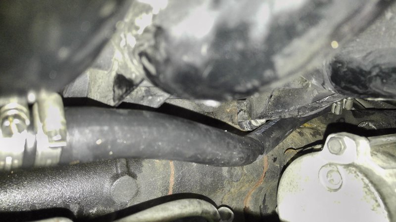

    You guys will not believe it but I installed my bypass from the rear under the truck. When I removed the old tube I removed it from the rear of the truck and installed the new one the same way the old one came out. The total time was 2 hrs. I read all the work involved with removing the intake. I just took my time ,but you have to remember to place it how it is installed from under the truck. I worked f

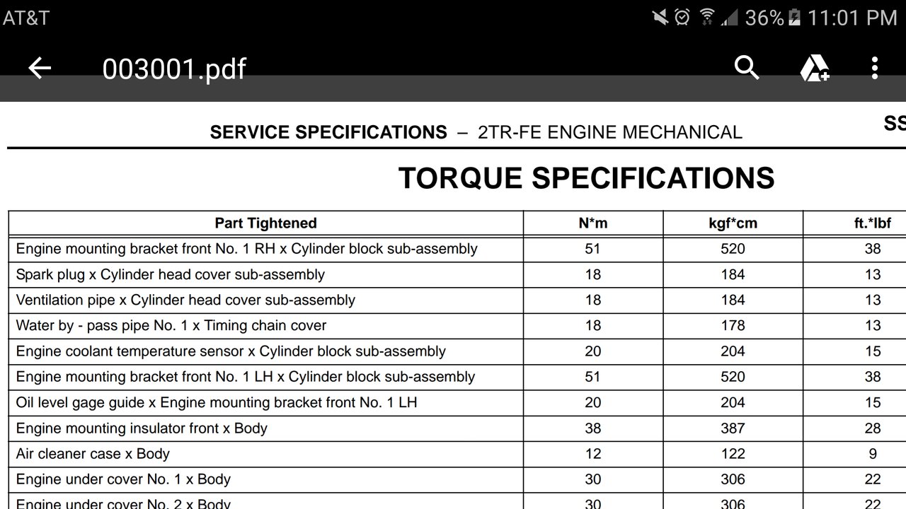

    Torque specs anyone?

    13 foot pounds. I took mine to 15 foot pounds.
