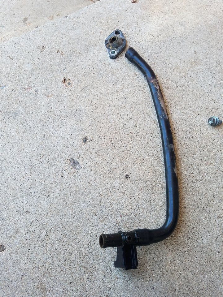

    Sometimes. The plastic pipe has a nipple that extends up from the bypass pipe to heat the throttle body. If it fails they usually leak with spectacular fashion. The block connection usually seeps.

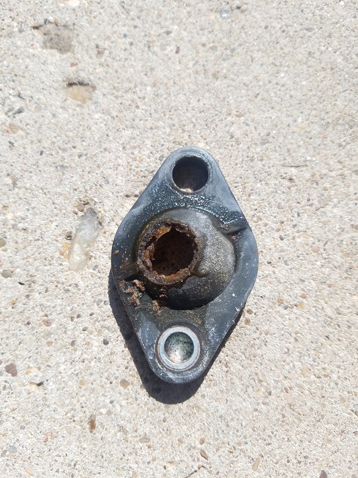

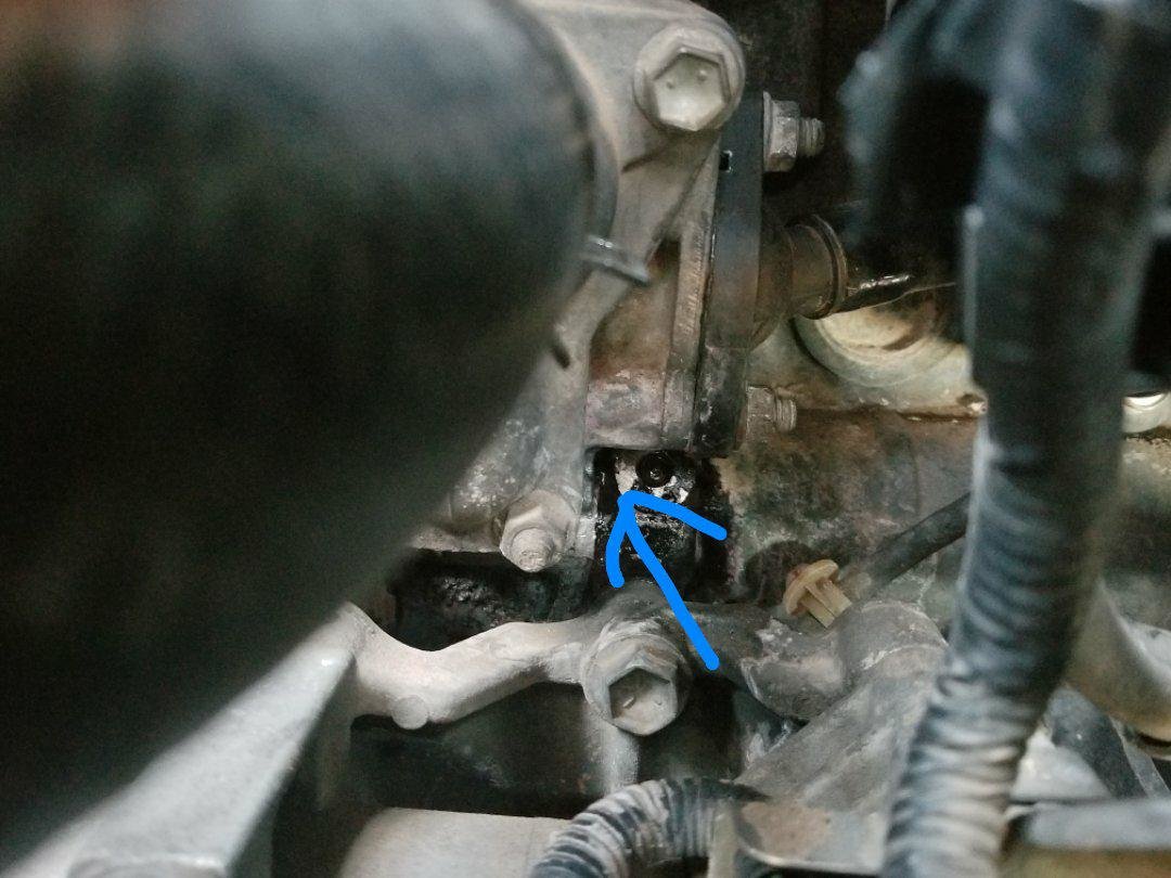

    I had this same problem a couple of months ago. My 2005 Tacoma 4cyl is the only car I have, so it's what I use for my commute. My experience with working with cars is minimal. I can do my own servicing but that's pretty much it.
    I was driving to a friends house one night when it started overheating. I pulled over, checked under the hood, let it cool down. I did notice the leak and the pipe was rotted away just like the original poster's problem. I called a tow truck and got home safe. I couldn't be without a car long, so desperately I searched the internet for answers and saw this thread and saw the metal bypass pipe upgrade, however I needed a quick fix so I opted for the OEM part from eBay with quickest delivery and so I wouldn't have to remove the intake manifold due to the OEM plastic part being more flexible than the metal one. When I received the part I had the old one taken out already. I did not remove anything but the pipe and where it is clamped to the two other hoses at the rear of the engine bay by accessing it just behind the left tire (it was a pain getting it out and putting the new one in, which I don't recommend for reasons described later). I routed the pipe from the back, under side (behind the left front tire), it took me about 45 minutes to wiggle it through to the forward end where it connects. Once it was connected it was all set. Installing the pipe this way also proved difficult when reconnecting the two hoses at the rear, and the clamp. I managed to half-way connect them to where they didn't leak and where it gave me a chance to take it to the dealer for the following reasons. 1. So they could ensure all hoses and clamps were connected properly and 2, refill the coolant with the correct type (I had used the wrong type coolant once I finished the job, should have ordered it along with the pipe but it didn't occur to me that toyota has their own coolant type. Once out of the dealer the car ran fine for about 2 months. I went home on leave (just under a 1k mile drive) and I started seeing a leak again anytime I had driven the car and stopped for the night, it always leaked more when the car was parked after a drive. Back at my home-town during leave, my brother helped me inspect (he's a mechanic). We took off the intake manifold, cleaned all mating surfaces and inspected the seal, which looked in good condition, still, we cleaned the o-ring in the pipe and added some sealant to it as well (this was the reason I recommend not replacing the pipe the way I did, just take off the intake manifold, it is way easier, trust me. It takes about the same amount of time and give you better working room as well as unrestricted access to the rear two hoses that connect to the pipe). When I had the intake manifold off, I also noticed that all the dealer mechanic did on my car was replace the coolant, which is why the following problem I will try and attempt to fix myself; on my drive back home I noticed the leak was still there (fuck me). Before reinstalling everything we reconnected everything the dealer mechanic hadn't properly.
    This is where I would like to ask for some guidance. I can drive the car without any issues other than the leak. But I still need to figure out and fix the problem. After a close look, I realized the leak wasn't coming from the pipe connection, but just under it. I can't tell how it is connected (whether it is a gasket that needs replaced, a crack in the engine block (god forbid), thermostat housing, etc. I can't tell what part must be replaced so the leak can stop. I do not want to take apart everything unless I know what I need to replace, again it's my only car and I need to be able to drive to work and back.
    In the pictures I will include I point to where the new leak is coming from.
    I will in the near future order the metal pipe and replace it, but priority right now is on this new leak. Any suggestions on what could be causing this leak are appreciated!

    Did you replace the gasket and torque the bolts where the coolant pipe attached there?

    I replaced mine today. You definitely have to remove the intake manifold. I was able to unbolt the manifold and pull it away just enough to get the pipe out. I recommend replacing the intake gasket and throttle body gaskets while your in there. Mine is a 2010 with 90k miles and they were definitely squished down, not sure they would seal great. The rear PCV hose that goes from the hard line to the rear of the intake manifold was the hardest part of the whole job. I recommend replacing it while your in there, mine was cracked but I didn't have a new one. I'll post pictures later.
