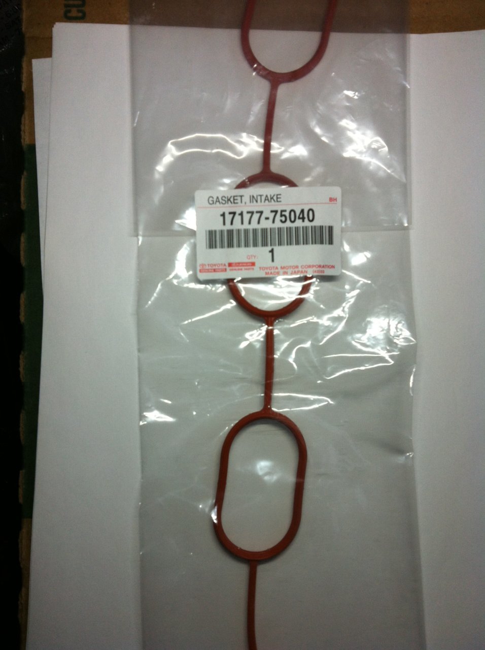

    Besides the parts below, does anyone have the part numbers for intake gasket, throttle body gaskets and rear PCV hose that goes from the hard line to the rear of the intake manifold?
    Any other recommendations to take care of why I have this all apart?
    2005 2.7 5speed.
    Thanks in advance.

    This intake manifold gasket for my 2006 2.7L 5-speed is the only part I have bought for when I replace my coolant by-pass pipe but got a good price about a year ago, so hopefully I will have all the parts so I can replace it this year.

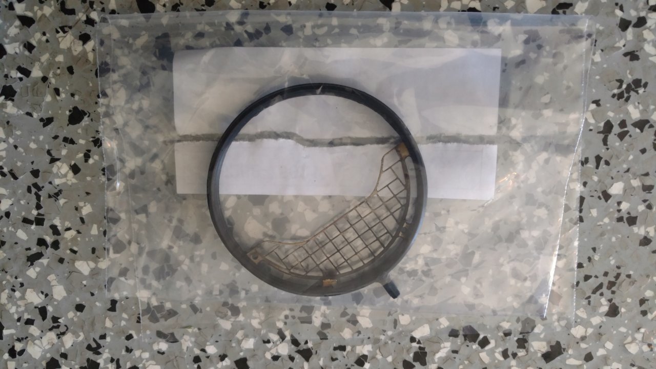

    I have a 2006 2TRFE and I bought a replacement gasket for the throttle body. The replacement one that got in the mail (Mahle Part Number G32143, which is also the Toyota part number, I think.) had the steel mesh on it but it did not fit, so I compared the old one to the new one and realized that the new one had a smaller diameter. I tried installing the new one thinking that maybe it was supposed to stretch a bit before it would fit. I was wrong, ended up tearing the new one trying to get it to fit. So I ended up using the old one cuz it was still good. Anyone have any thoughts on this?
    Maybe get one of the newer gaskets that don't have the steel mesh?

    This is the OEM throttle body gasket you want to use: https://www.amazon.com/Genuine-Toyo...=B00IGCSZYM&psc=1&refRID=49J2TQWECHTTMNZQMM0Q
    Edit - OEM part # 22271-0D051

    When I cleaned my throttle body last year, I had the same problem. I picked up a Felpro gasket from Autozone, and it was too small even though the Felpro website say that it fits. I bought a new gasket from the dealership, and it didn't have the metal mesh.

    The new intake gasket revision doesn’t have the mesh. Edit: OEM Toyota

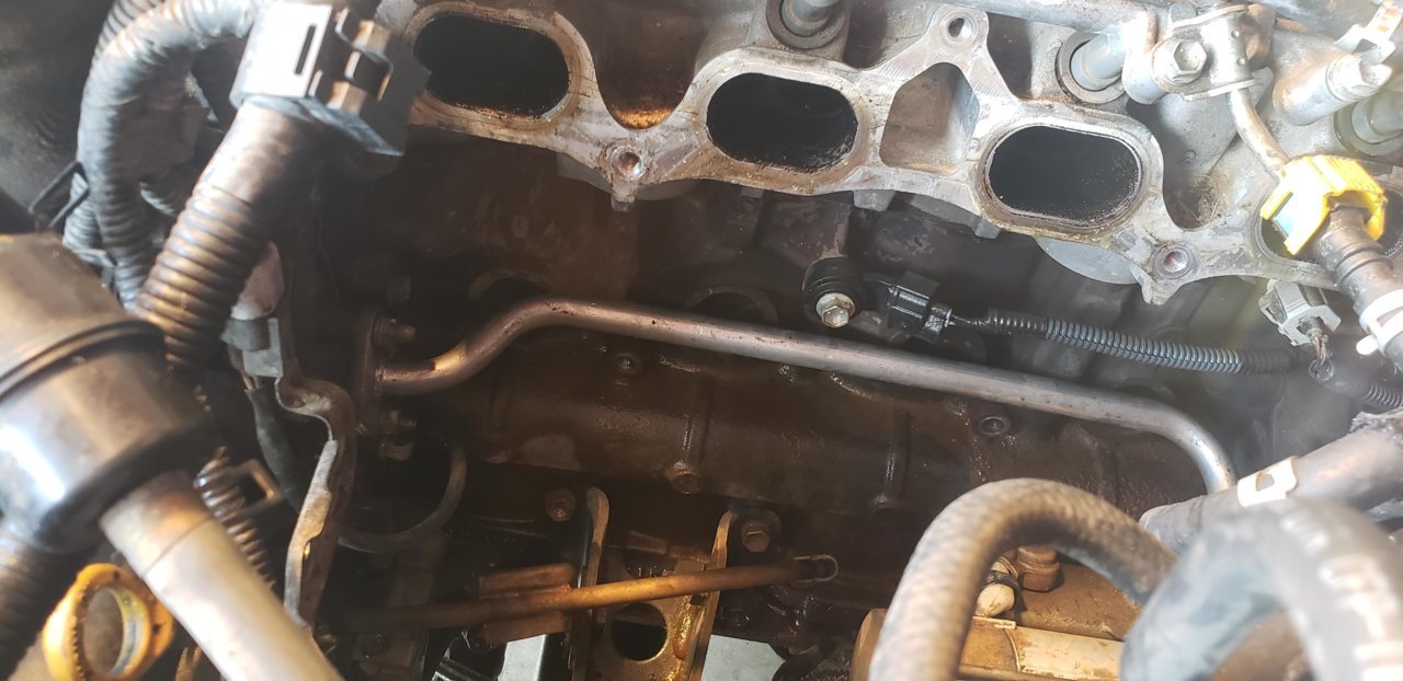

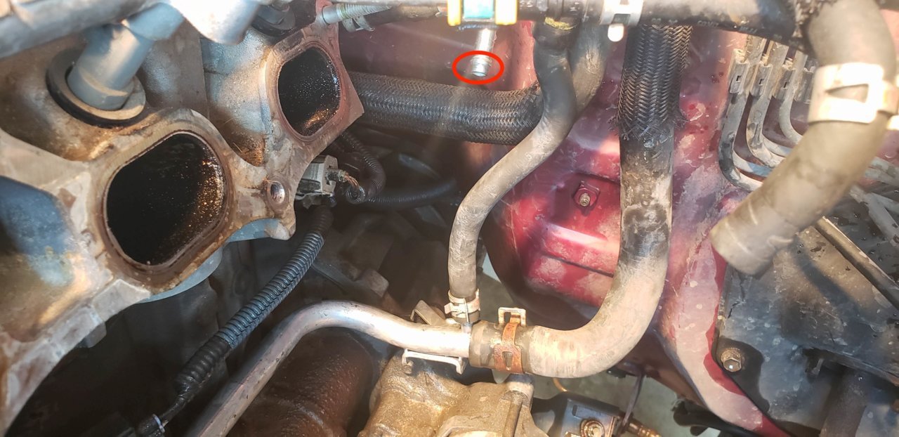

    This job took me around 3 hours and I am an amuture. A few tips that may hopefully help someone down the road.
    1. Drain your coolant prior to attempting this. I made a huge mess, ended up washing a lot of antifreeze down the driveway with a hose. Hopefully no kitties died in the process.
    2. Buy the correct parts. I tried to go with a cheap pipe on Amazon that was about 1/3 what the dealer wanted. It did not fit right, had to use a hammer to get it into place.

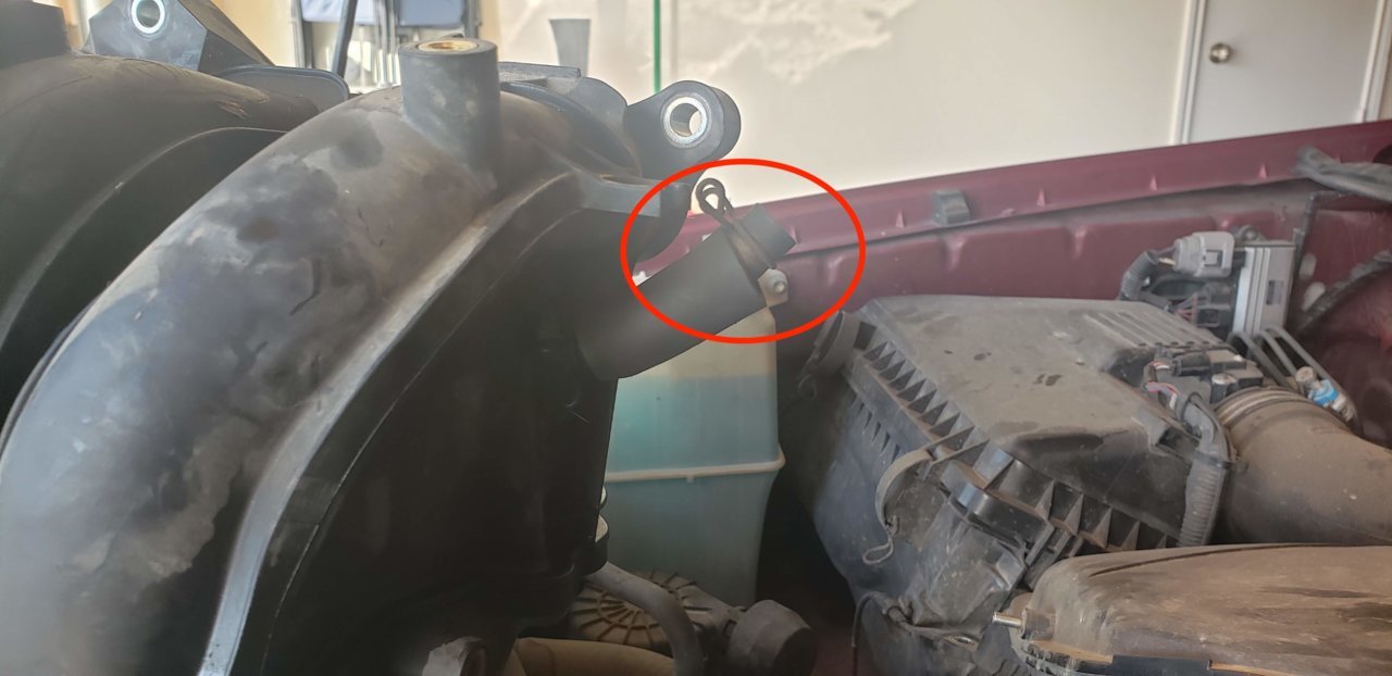

    3. Don't forget to disconnect the connection on back of the intake manifold near the firewall.
