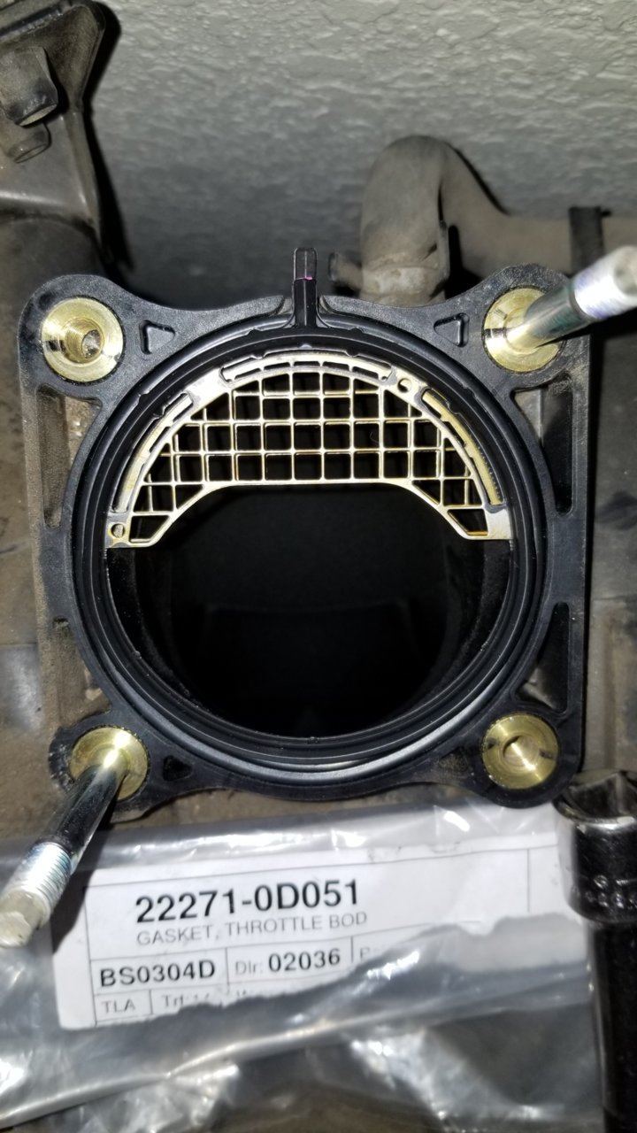

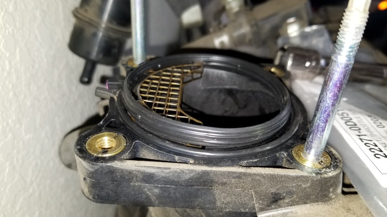

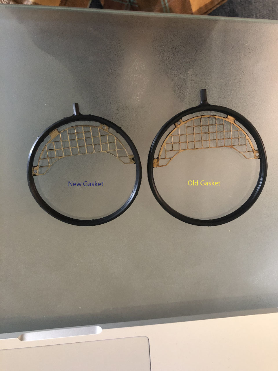

    DUDE! They're still selling the wrong fucking gasket for the 4cyl base model(I have a 07'). The smaller one like you pictured
    I put in my VIN and everything, even rock auto shows it as fitting but it does not. Wasting my time and money
    WRONG -> https://parts.camelbacktoyota.com/oem-parts/toyota-intake-manifold-seal-222710d051
    What is the correct PN?
    I'm seeing
    22271-0C020
    and 22271-75070 as possibilities the 75070 when entered on this site/where I got my parts from, says it wont fit https://parts.camelbacktoyota.com/oem-parts/toyota-gasket-2227175070 this dealership is pissing me off. they can't find me two others parts. the 3" vent hose that's a bitch to connect on back of the manifold and also the clamp to go with it. I drop mine and no idea where it went. probably inside a frame rail or something.

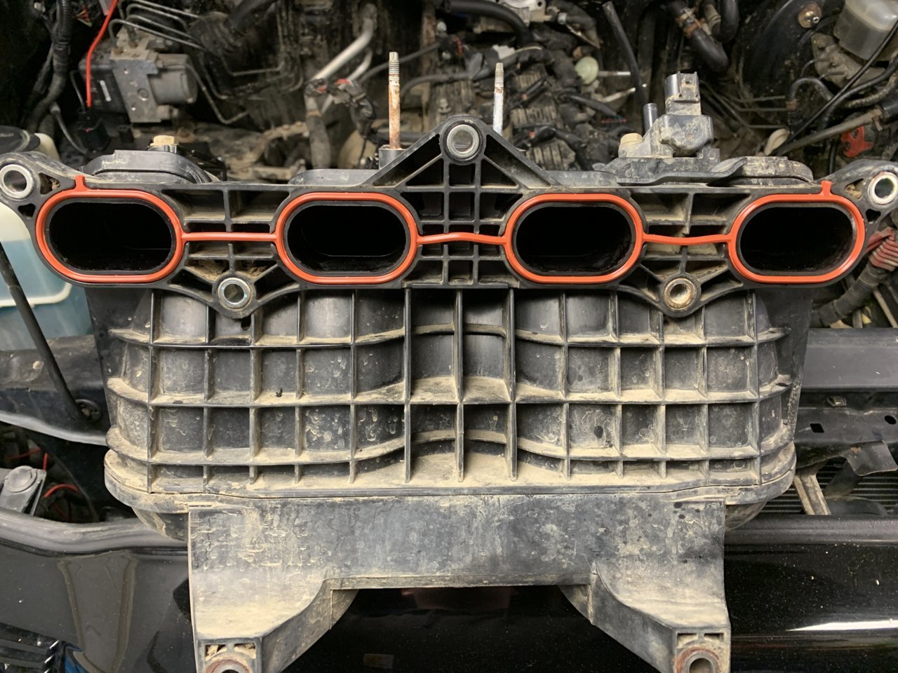

    My 08 2.7l with 225K miles recently started becoming low on coolant. After surfing around the forum here, I found a few threads on this and saw this pipe being a relatively common problem. Looked around the engine bay and found this... I obviously can't see the other side of the pipe but knowing how much coolant I am loosing I am guessing there's something broken on that end too. I am glad I caught this before it ran out and or overheated. I am going to try to make this post as detailed as I can as it was hard for me to find the information needed to do this job. I will be replacing the pipe and gasket tomorrow so stay tuned. This post will get updated with more pictures etc.
    As you can see, 16268 and 16268G in the picture below is what needs to be replaced.
    I just got this from my local Toyota dealer this morning! I included part numbers for anyone looking for them. I wanted to make sure I replaced this pipe with the stainless steel version and not the plastic version! Here are the most recent part numbers (part numbers often change with updates). My total was $54.92 + tax
    Stainless steel water by-pass pipe part # 16268-75131
    Metal gasket part # 16258-75021
    I prefer to use OEM parts when I can but I would also like to add that Dorman makes a fix for this as well. Dorman # 626-554 which comes with a gasket and is listed on Rock Auto for $41.79. Here a link if you'd rather go that route https://www.rockauto.com/en/moreinfo.php?pk=9769344&jsn=255
    After work I got the truck in the garage and got to work. I will say, this job isn't nearly as difficult as I expected and I am no professional mechanic. A few basic hand tools and some common sense and anyone can do this.
    I drained my coolant first just because I wanted drain and refill it while I was at it. I don't think this is necessary but I'd recommend it as you'll be loosing coolant later anyway.
    Second, I removed the air intake. I have a cold air intake so it was super simple with the only tool needed was a 10mm wrench.
    Next I disconnected and removed the throttle body, use a 10mm socket and remove the 2 nuts and 2 bolts that hold it on. I left the throttle body's hoses connected and just pushed it up out of the way.
    Next step would be to remove the 5 bolts and 2 nuts that hold on the intake manifold. I used a 12mm socket with a few different extensions. I think I used nearly 2.5 feet worth of extensions to get to the 2 lower intake manifold bolts through the wheel well. I did not need to remove the wheel for this on my truck. Also remove the electrical connections on the manifold. Once the manifold is completely disconnected pull it away from the block.
    Now you can finally see the pipe you're trying to replace.
    Undo the 2 fuel line connectors and push the hoses up and out of the way. Now carefully remove the intake manifold from the engine compartment. its a tight fit and requires a little persuasion but it will squeeze out. Put the intake manifold in a clean safe place.
    Hooray! The hard part is done. Now we can get to the stupid plastic pipe Toyota was generous enough to supply! Simply remove the 2 rubber hoses on the end of it, be careful as the small nipple could easily break off inside the hose. if it does like mine did, just screw in a dry wall screw and pull on the head of it. Pulls right out. anyway, remove the hoses, coolant will spill everywhere which I expected but wasn't prepared for (had to buy some kitty litter). Remove the bolt and 2 nuts holding on the shitty plastic pipe. (all 12mm). Once removed, throw the pipe right in the trash where it belongs! IMG_6592.jpg
    Clean everything the best you can, insert the gasket, and put the pipe on. replace the 2 nuts and the bolt. Tighten them down evenly so the gasket seats properly. Connect the 2 hoses as well.
    This is where I have stopped for the night. Had to buy some shop towels, kitty litter, coolant, a funnel, and I decided while the intake manifold was off it was worth replacing the intake manifold gasket. $28 at the local auto parts store. I will finish the job in the morning. and update this post when its done. I hope someone finds this useful.
    Got up this morning, and got to work on the truck. Went fairly smooth.
    I cleaned the ports on the intake and a block, cleaned the throttle body, cleaned the block where the gasket sits. I replaced the gasket on the intake manifold with a Fel-pro MS 96924.
    Once that was done I put the intake back in its home, connected all the hoses and what not. Be careful getting the nuts and bolts back on. I dropped the nut closest to the firewall and had to take the manifold back off to find it. Also the hose that connects to the intake manifold closest to the firewall was a real pain in the ass to connect. be sure to connect all your hoses, gas lines, electrical connects, etc.
    Tighten the 5 bolts and 2 nuts starting from the center and in a series of 3 to get them all evenly tight. Again, I used a whole shit load of extensions to reach the bottom 2 bolts through the wheel well.
    Put your air intake back together and connect it back to the throttle body. Fill it up with coolant and fire up the truck. Be sure to check for leaks, and watch the coolant level for the next few days.
