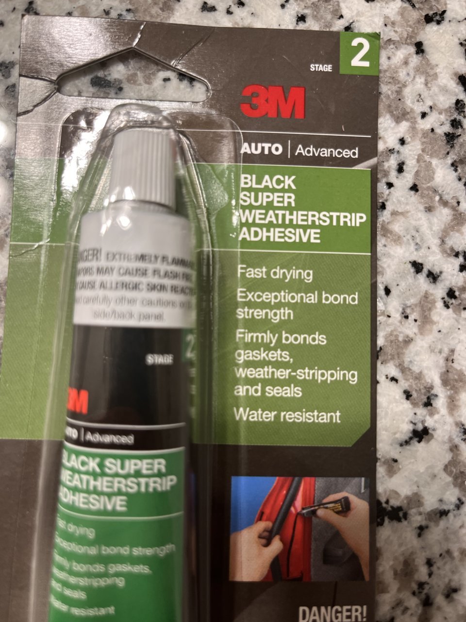

    Debating trying another dealer which I purchased the truck from.
    I picked up some of this to possibly seal up the hood cable to the grommet if I don’t. Then bury it in RTV silcone or something
