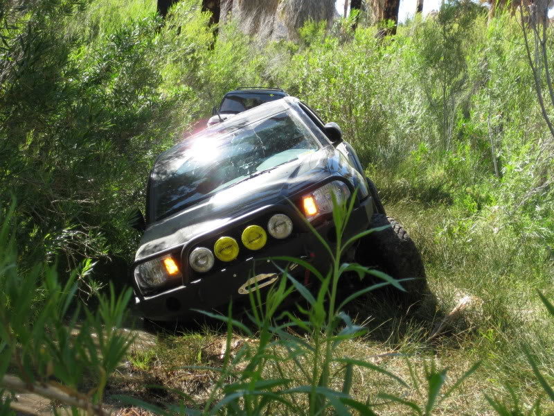

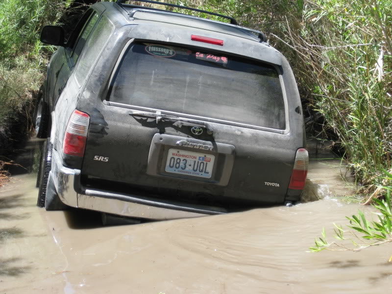

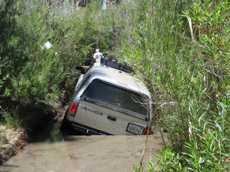

    Once the axles are submerged, then you risk contaminating the rear differential unless you do the Rear Diff. Breather Mod. (see link below).
    I was in 2-3 foot deep water in my 6 month old truck and contaminated my rear diff. oil, I found out after getting back from our trip...
    Here is HB Murphy and others, on that same trip:

    The (4WD) 4Runner in the photos above (Mision Santa Maria, Baja trip 2010) had to be pulled both times through the bog... OPEN DIFFERENTIALS is why. The rest of us had either A-TRAC or lockers and drove through the deep water.
    So, not only should 2WDs be cautious, but even 4WDs without some additional TRACTION CONTROL need to think before crossing (or don't attempt without a buddy vehicle).
