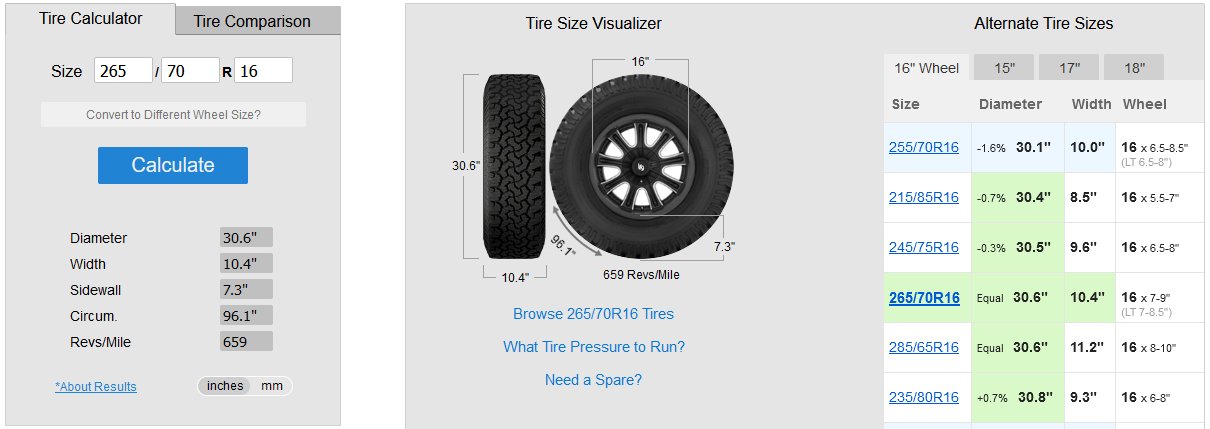

    My Rules of Engagement for water: Not any deeper than the inside of your wheel at the bottom.
    I'm running 265/70-16's
    So the Sidewall is about 7 inches and then I've got about 2" of wheel above that. So for me in my vehicle it is 9 to 10 inches.
    Never rushing water (white water / white capping) and never rising water.
