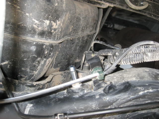

  15. Sep 10, 2010 at 7:25 PM

    what breather is the second pic of?
    is that the transfer case?

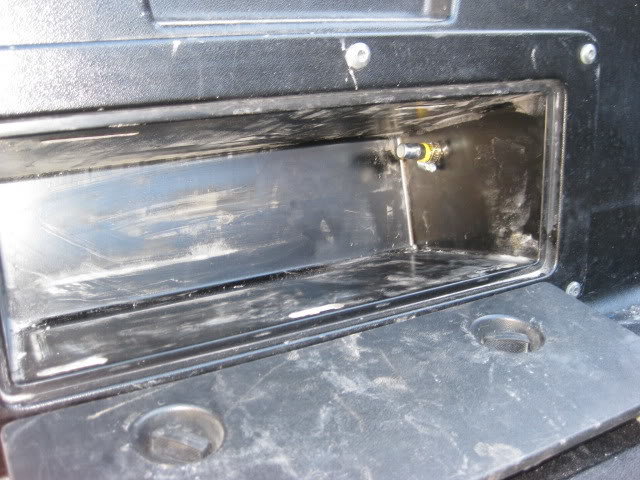

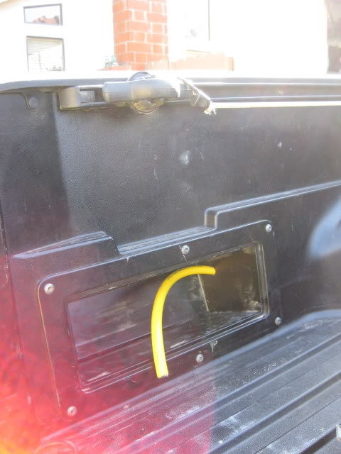

    Hey here is the deal. its all in the scuba thread but here is the short form. the (2) breathers near the battery on driver's side under the hood are for the ADD and the Front Diff. (Yes the 2nd gen tacoma has 2 not 1) we do NOT have the Elocker breather on our trucks only the FJ. the Rear diff is well...in the Rear:) right on top the diff. The Trans breather is extended in no way and is directly up on top of the passenger side of the tranny and is right about were the fire wall starts. look at my video on the scuba thread. If you have a M/T then your transfer case breather is extended but not really. it runs from the transfer case on the passenger side, over the top of the transmission to the drivers side and then back over to the center of the tranny where it comes to rest up against the back of the engine next to the fire wall. you can access it by reaching up under the vehicle on the driver's side. there is quite a bit of slack so you should be able to access it and put an extended hose on it to get it higher. it is literally laying up against the back of the engine.
  17. Sep 10, 2010 at 8:03 PM
    #17
    David K
    David K Well-Known Member
    Jun 27, 2009
    #18969
    10,997
    San Marcos, Alta California
    2010 4WD Off Road DC
    Differential Breather Mod Light Bar: 4 Cree LED lamps Bilstein 5100s Ride Rite Air Bags

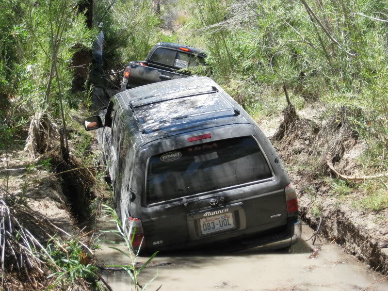

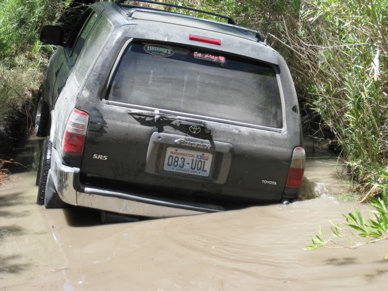

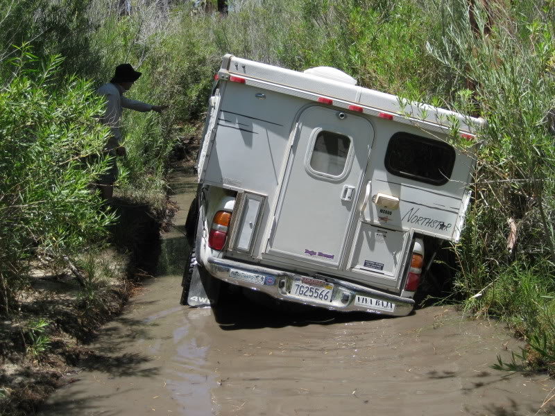

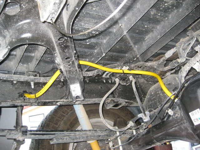

    Right here... both directions on the road to Mision Santa Maria.

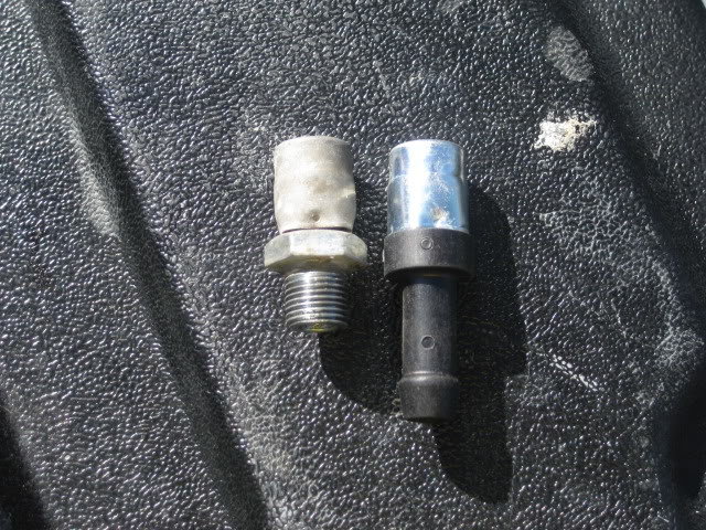

    The breather is 18" above ground level, but it is a one way valve to let hot gas out. Muddy water can only get in if there is negative pressure inside the diff. when dropping into cool water. The contamination is allowed by the axle seals... unless the breather is stuck open.
    After the Baja trip, I had the differential inspected and it was contaminated (truck was only 5 months old)... had the oil changed.
    Last weekend, I did the breather mod. so now if there is a pressure drop in the diff. the new 2 way breather will break any vacuum, thus preventing junk from sliding by the axle seals... at least that's the plan!
    (Orig. breather off the diff. on the left)
