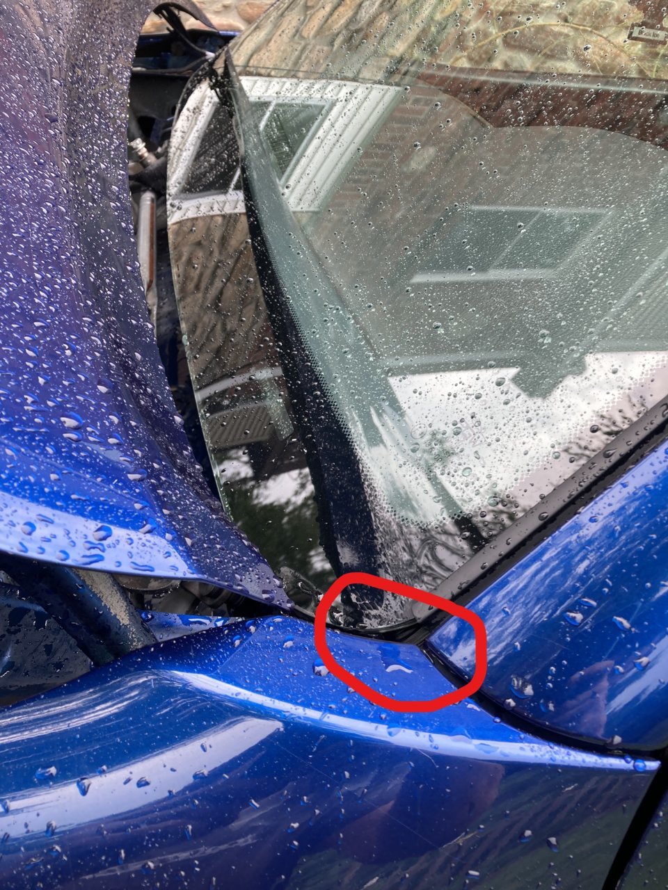

    The smell that equates to a dirty sock led me to find a soaking wet drivers side carpet.
    I did the best to clean it.
    Also, water was shorting out the wires behind the instrument cluster because I had every idiot
    light go on and off for a week. Air bag, traction control, seat belt, etc.
    I also had the temp gauge, speedo, and tach stop working
    Clearly water was shorting out the system somewhere.
    This happened, coincidentally, after having a new windshield installed.
    I brought back to the installer, and he insisted that it is 'NOT the windshield!"
    So I climbed in, feet hanging over the headrest, head resting next to the break pedal.
    I am skinny and agile, so I can do this...
    With my wife pouring water on the corner of the windshield and cowl and location where the wiper arm connects, I can see water dripping in just to the left side(drivers side) of the steering column.
    So I know why my floor was wet. Just don't know how or where the water is coming in.
    I called the installer of the windshield again, he insists it is not the windshield, and thinks its where all the wires or the hood release comes thru the firewall.
    I brought the truck to my mechanic. He could not find where the water was coming in, and he thinks its the windshield.
    Any windshield installers here? Is it possible my windshield is leaking, or, has anyone else had this problem that can point me in the right direction?
    Can the carpet be cleaned or am I looking at replacing it?
    Thanks

    Found It!
    Leaking windshield right in the lower corner..Mfer!:mad:

  8. Aug 8, 2021 at 12:23 PM
    RTD
    RTD [OP] Well-Known Member
    Sep 29, 2013
    #113491
    141
    Taxachusetts
    that corner is normally covered by a plastic moulding

    We had one of those at work. A late model Tacoma with a poorly installed (and wavy as hell) aftermarket windshield. And yes, it leaked and drenched the wiring just like yours. The insurance company had to pay over $5,000 for a new main wiring harness plus a new windshield. Oddly enough, they paid us (a Toyota dealership) to replace the wiring, then paid the same idiots who screwed up the first windshield to put another wavy aftermarket one it. Words fail me. Watch out for massive and expensive electrical problems down the road.
