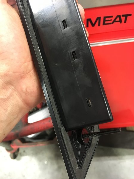

    Happened to a friends truck that had the roof wrapped. When the light was removed, the foam seal ripped.
    $155 for a new light assembly billed to the shop that did the wrap.
    Warning: the new light comes sitting in a cradle in the box, which compressed the seal to the point that it may not seal on the truck. I applied some RTV to these spots as a precaution.
