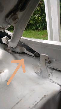

    Enclosed is a photo with and arrow pointing to where my leak is. If I take water and pour it into that opening behind the fender , I get water into the compartment. It's right along the edge.
    I can not tell where the origin is due to all the clutter , but its near the top. This truck has water penetration issues. I've already re-done the windsheild from top down. Worse case of leaks I've ever seen but the truck has had no accidents. Fortunately the truck was stored in a garage so the floor is still solid.
    Anyway, it looks like I need to remove the fender. Is there a good video that shows step by step how to do that ? Do I need to remove the front bumper ?
    I thought about pouring some por 15 into that space but it probably would be better to remove the fender to see what's going on behind it.
    Thanks
    Lou

  7. Aug 18, 2021 at 9:14 AM
    Wsidr1
    Wsidr1 Well-Known Member
    Jul 11, 2018
    #259004
    3,078
    Indiana
    2 x 95.5 Ext 2.7L & 3.4L A/T 4x4
    He may have been suspecting same thing I am: is it possible that water is running down onto something like your hood cable, and the grommet for the hood cable has come out of the cowl? Hood cable is just an example. Get under the dash with a flashlight and make sure anything passing through to the engine compartment is sealed.
    1943MB[QUOTED][OP] likes this.
  8. Aug 18, 2021 at 10:11 AM
    1943MB
    1943MB [OP] Well-Known Member
    Apr 13, 2021
    #362621
    125
    Louis
    1999 Tacoma Regular Cab 2.4 litre
    none
    Hi,
    Yes, I suspected that early on and keep going back to it. On mine it's a large grommet with a smaller opening for the hood cable sheathing. At first I thought it was the grommet and squirted water directly onto to it and no water came through. It's above that point. The only thing above it is the metal lip where the two pieces of sheet metal come together. I'm leaning towards something going on there. There's an intersection of sheet metal with seam sealer smeared all over it on the outboard side. My next try is to smear a bead a seam sealer along the inside of the drain trough intersection and other places that look suspect and go from there.
    The water was running slowly down over that large grommet and reforming as a single bead at the bottom of the grommet. That's why at first I thought it was the Grommet. The leaks are so scattered at times it would appear that they are coming through in multiple places along that sheet metal seam. I don't see anyplace else. There are no rust holes. My white seam sealer should be here in a couple of days and I'll give an update then
    Thanks for all the advice.
    Lou

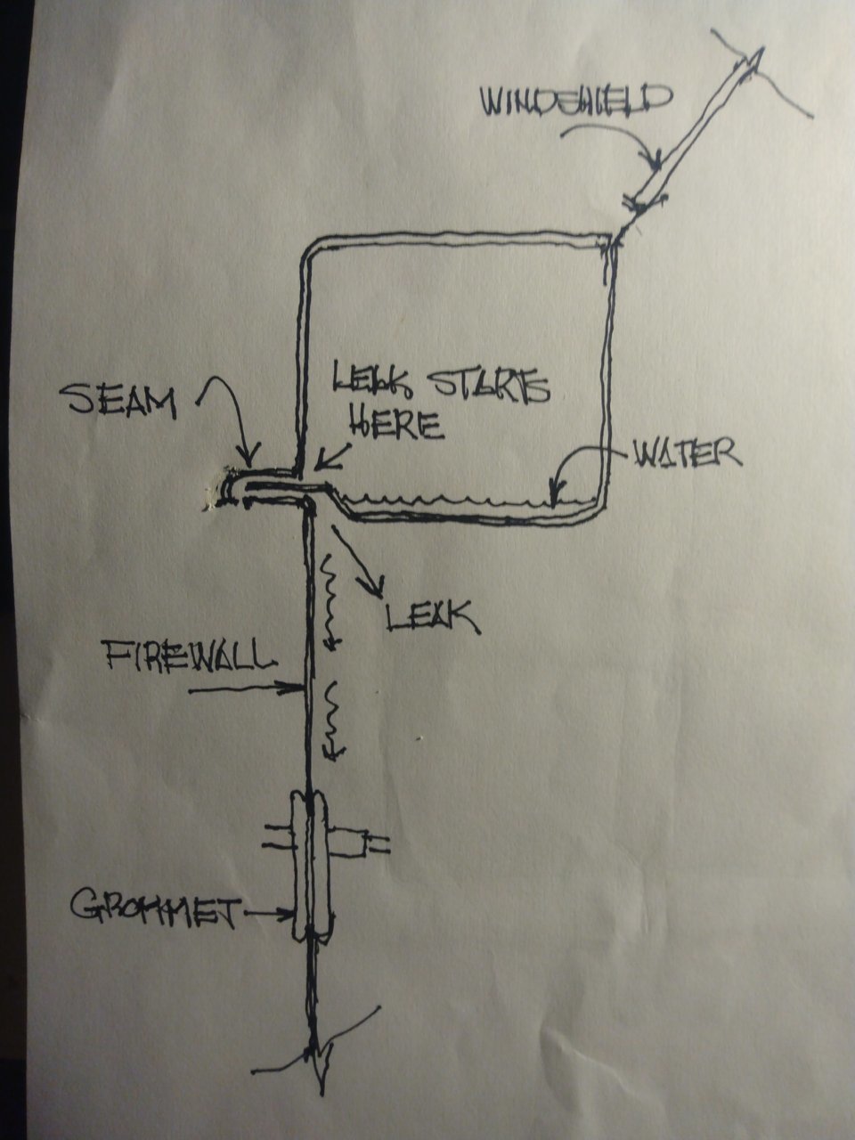

  12. Aug 18, 2021 at 2:16 PM
    1943MB
    Apr 13, 2021
    #362621
    125
    Louis
    none
    Here's a drawing where I think the leak is originating. When I force water up and out through that seam then I get water in the cab. The water has to get high enough to enter that seam and then it leaks through that seam back into the cab. It then drips down over that large grommet. If the water stays below the seam I get no water. At least that's part of the problem so I'll start there and see how it goes. I'm pretty sure that's how its constructed at that seam.
    Lou

  13. Aug 18, 2021 at 2:40 PM
    Digiratus
    Digiratus Adventurer
    Mar 26, 2010
    #34006
    23,763
    Roaming the PNW
    The RedHead
    2002 XtraCab TRD 4x4 SCv6 AutoTrans With Lots of Mods ADS COs w/Compression Adjusters Camburg Uniball UCAs Whiteline Lower Control Arm Bushings Kartek 7" Limit Straps Plastics Guy Front Bumpstops Total Chaos Sprindle Gussets Custom Alcan Springs +800 lbs +3" ADS 10" Stroke Triple Bypass w/Resi Rear Shocks Custom Rear Shock Relocate All-Pro U-bolt Flip w/Timbren Bumpstops 4.88 Nitro Gears ARB Front Locker ARB Twin Compressor Black 17x8 Konig Countersteer Type X 285/70r17 Falken A/T3w Gunmetal 16x8 SCS Ray10s 255/85r16 Maxxis Bighorns Limited Edition (Relentless) Elite Front Bumper Smittybilt X2O 10K Winch Diode Dynamics SS3 Sport Selective Yellow Fog Lights in the Bumper Diode Dynamics SS3 Pro 4,000 Kelvin SAE Driving Lights with Clear Lenses on the Bumper Morimoto D2S Projectors XB35 Ballasts + 4300K Bulbs Badland Sliders FrankenFab Tire Carrier Swingout bumper w/kitchen BudBuilt Front & Bellypan Skids BAMF Rear Diff Skid Dometic CFX 55im Fridge/Freezer Alpha II Hardshell RTT Badland Custom Bed Rack Denso 210-0461 105 amp alternator Dual Northstar 24F AGM batteries BlueSea 7622 ML-ACR Battery controller Peak DBI Dual Battery Voltage Monitor Haltech IC-7 Display with Mako Dash Insert Haltech Elite 2500 Standalone ECU Magnuson MP62 Supercharger w/URD 2.2" Pulley Denso 650cc Fuel Injectors Aeromotive Stealth 340 Fuel Pump TransGo A340F Reprogramming Shift Kit Doug Thorley Headers 2.5" Magnaflow Hi-Flow CAT Magnaflow 18" Muffler w/Vibrant Resonator 13WL Brake Calipers Braided Steel Brake Lines Kenwood TM-71A Dual Band Ham Radio Larson 70CM/2M Antenna Midland MTX275 GMRS Radio w/Roof Mount Antenna Uniden 520xl CB radio 3' Firestik Adjustable tip antenna Pioneer DEH-P9400BH HU Alpine Amps & Type R components (F) and coaxials (R) Wet Okole Seat Covers Weathertech Digital Liners Deck Plate Mod 1" Diff Drop Carrier Bearing Drop
    Where is water collecting inside the cab? Is it the passenger side floorboard?
  14. Aug 18, 2021 at 2:44 PM
    1943MB
    Apr 13, 2021
    #362621
    125
    Louis
    none
    I need to pull the carpet up on the passenger side to check . Right now it is the worst on the driver's side just above the large grommet where an electrical block is located. I've pulled the carpet up on the driver's side and pulled the drain plug.
  15. Aug 18, 2021 at 4:44 PM
    1943MB
    Apr 13, 2021
    #362621
    125
    Louis
    none
    I just pulled the passenger carpet and it looks like it's the same problem. It was wet. Coming from the same place. It's wet right at the bottom front. Why am I having this problem if no one else is ? I'm glad this truck was stored in a garage all these years.
    Lou
