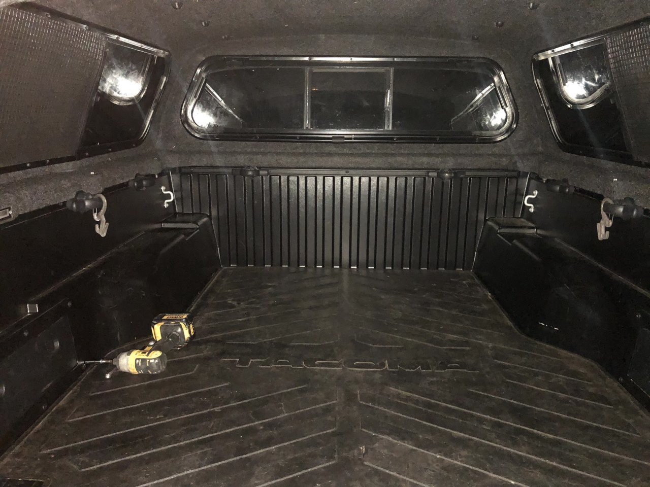

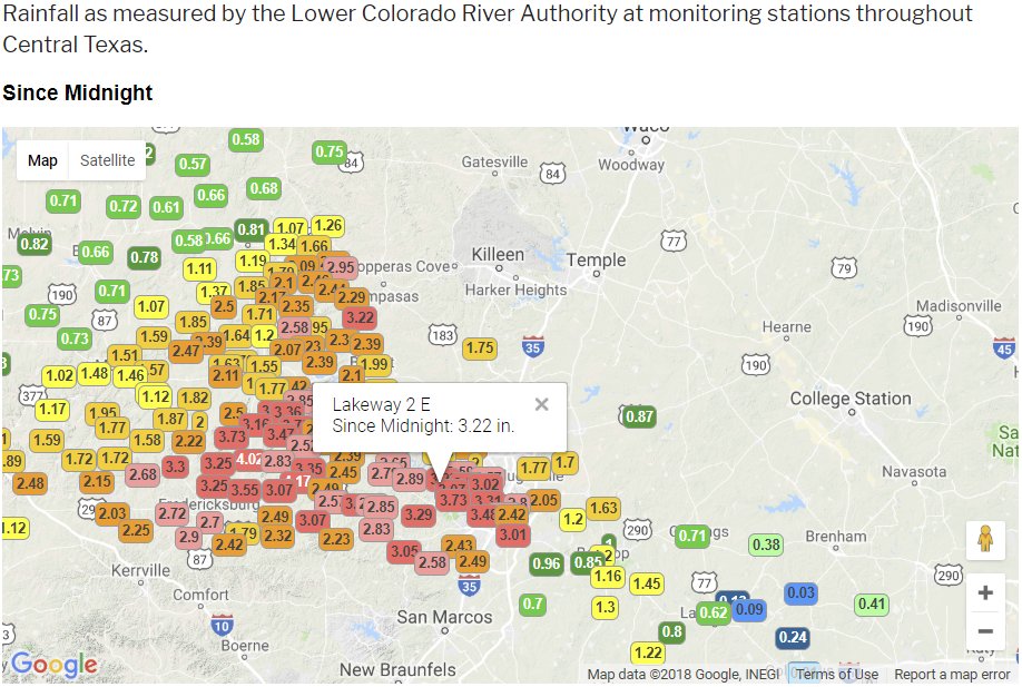

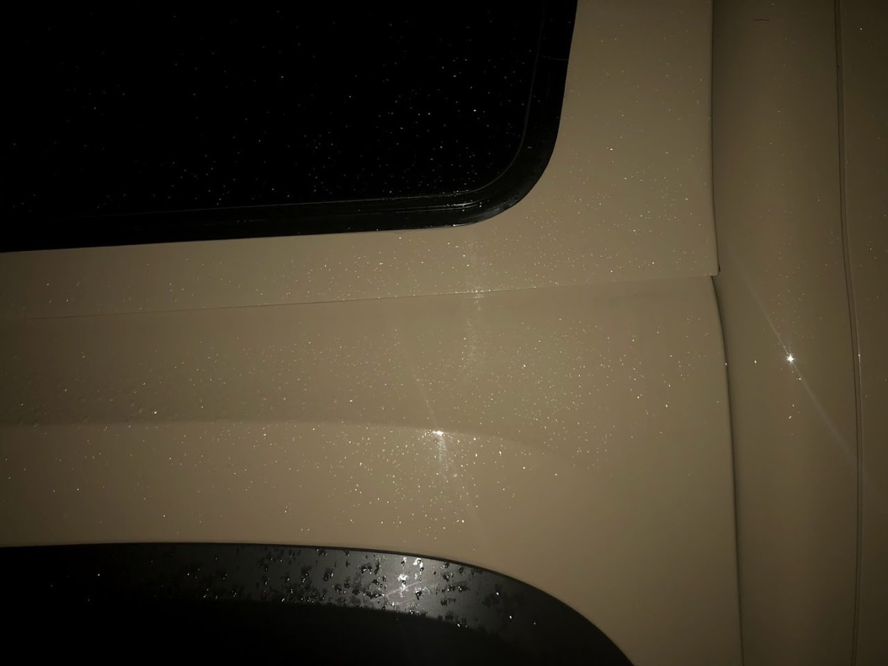

    Respectfully, I disagree. I paid $2400 for my Snugtop Rebel installed. I ordered it with pet screens, rack rails, and other goodies you can see for yourself in the pictures below. It uses a proper automotive seal and stays dry in virtually all weather. Today was a perfect example as we have had flooding all day. I thought it would be fun to defend my claim with a few pictures.
    Below, you'll see a screenshot of the rainfall in the last 24 hours in my location, followed by 2 pics of the bed of my truck as it sits right this minute. I did no modification to the truck or shell, other than a small amount of butyl putty in the gaps on the front bulkhead. I've done quite a bit of driving in the storms today, and my truck has been parked outdoors for all of the last 24 hours. Not one drop inside the bed and zero fogging on the inside of the windows. I've had the cap installed for over 2 years. During hunting season, I regularly hose it out with soap and water but other than that, it's dry as a bone!
