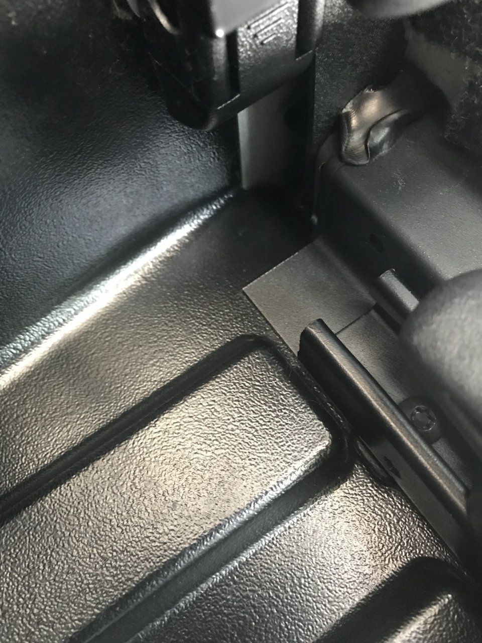

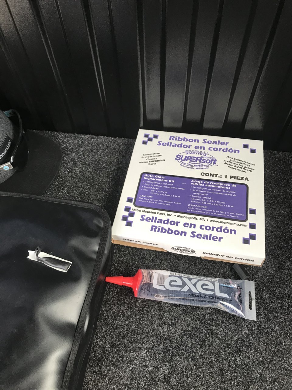

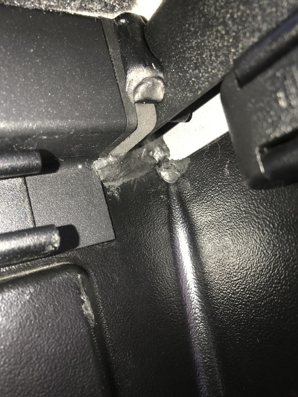

    I just bought a new Tacoma (first) and bought a brand new ARE cap. After getting it on I noticed there was water in the bed. Very little. Chalked it up to leftover water from before the cap. Cleaned it all up. After another heavy rainstorm, I noticed water again. I was pretty bummed since everything was new and professionally installed.
    I noticed it wasn’t coming in where the cap meets the bed, but underneath. I looked at the installers work, and they did a pretty good job with all the sealer stuff. (From what I can see, again first cap on a truck). Someone in this thread said wait until daylight and look for light. That’s exactly what I did, and there it was. A small crack under the top rails.
    I went to Lowe’s and autozone and picked up caulk and ribbon sealer. I caulked wherever I could see light and then put the ribbon sealer over it. From what I can tell, it’s the same stuff the installers used. I can no longer see light. No rain in the forecast, so time will tell.
    Didn’t think anything of it when the installer said Toyota’s are tough to keep dry.
    I’ve attached some pics of the front corners of the bed, where I sealed myself. Will keep you posted on outcome
    colonelforbin likes this.
  11. Nov 20, 2019 at 10:50 AM

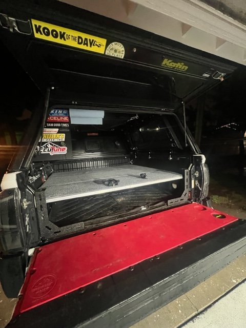

    I built a simple platform during the holidays and am only now seeing that my RSI Smartcap is leaking at the seam the connects the rear hatch to the main section of the shell. Before the carpeted platform, I also didnt really care so much.... and definitely dont expect it to be 100% water tight, but this developed a little puddle and fogged up the glass once the sun came out. Pretty bummed, I feel like adding silicone will not look as clean as I want, but most likely will just do it.
