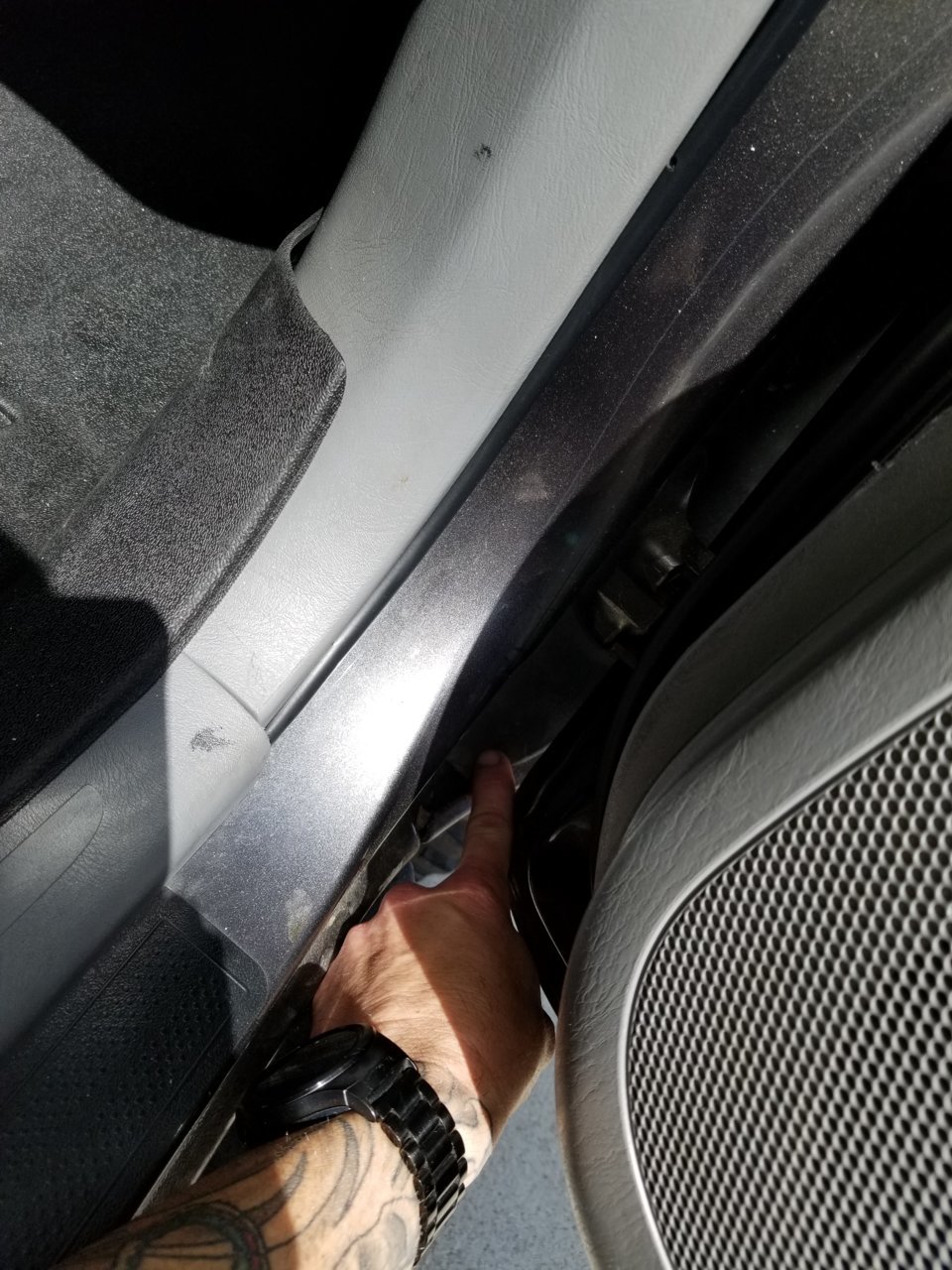

    I had a similar issue, wound up being a clog in the drain inside door sill. Open your door and look at the inside of the door sill at the bottom under the hinge. There is a small rubber flap, pull out a little and make sure its cleared. I will snap a photo in a min for ya. Good luck

    Theres also a rubber grommet behind passenger kick panel. Looks almost like a bouncie ball with a wire in it. On my 06 it came loose and leaked. Sometimes its a real PITA to find a leak because water travels. If you do find the problem, post it up so others with this issue can be helped.
