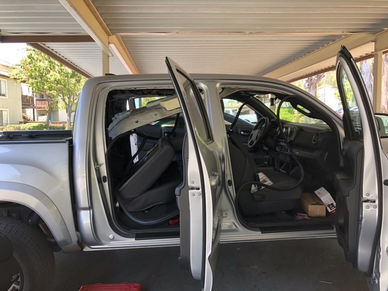

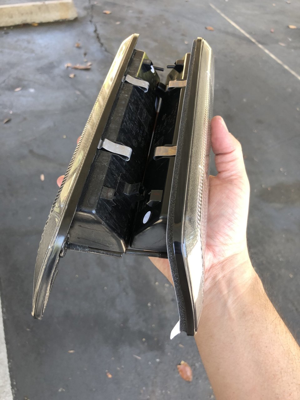

    Dropped the headliner and replaced it with the updated part. As far as I could tell, it’s just a thicker gasket that forms to the body better. The original was not even really sealing the top much. You can get just the gasket on eBay just by searching for the third brake light gasket, but I’m not 100% sure it will fix it since I didn’t do that, but according to the description, it should. That rout is only $10 and I will probably go that rout next time. The whole assembly (light and new gasket) was just under $180 with tax from Toyota

    there is a small wiring harness in the passenger side rear corner, a 10mm bolt in each of the lower B pillars and one in each of the upper C pillars behind the SRS cover plate. I didn’t remove the A pillars, but If you go that rout, I believe there is a 10mm bold behind the passenger B pillar as well under the SRS plate (someone please correct if I am wrong)
    buy extra white panel clips...you will probably drop a couple lol
    edit: oh!! You will probably drop one or both of the nuts that hold the light on. Don’t worry, they are easy to get to from the outside of the truck. They will be sitting on a the shelf (you will see what I mean when you drop the headliner)

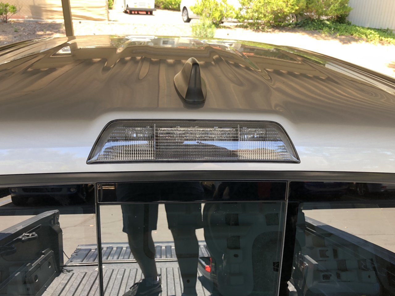

    Isn't it better to remove the 3rd brake light from the outside instead of going thru the whole mess of pulling down the headliner, clips, rubber gasket etc? I've noticed some people have done this by using a dremel and since you are putting in a complete new assembly, who cares about the old one? If im not mistaken someone swap one with a screw on 3rd brake to avoid going thru that mess down the road.

    if you are swapping it to a different light that will offer screws on the outside, absolutely. The stock LED third brake light does not offer this option. You will not be able to re-attach it from the outside. Two 10mm nuts and the posts they go on are on the inside
    pretty sure you are talking about the MESO third brake light. Those swapping to it, drill it out the stock one because the new MESO light offers screws on the outside.
    if you are just putting another new OEM light on, it will not work
