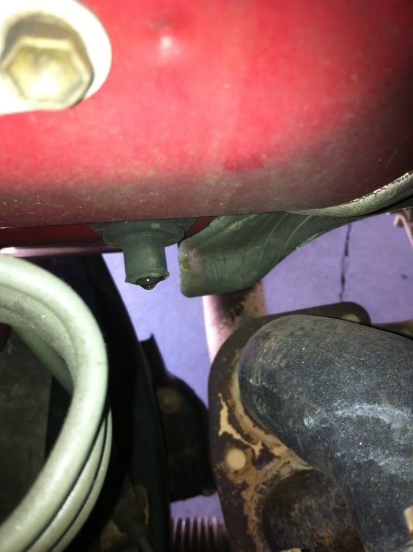

    Here is the nipple you're looking for. This is looking down on the engine compartment at the passenger side. You can see the drop of water coming from it. Yours might have a 90* aluminum elbow in it. Either mine fell out long ago or never had one to begin with.
