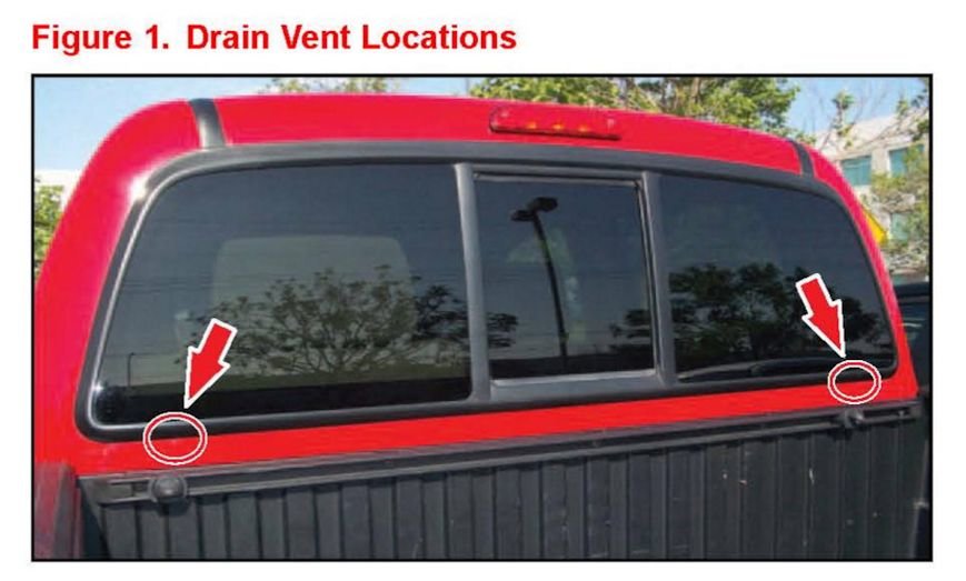

    There is TSB regarding plugged up drain holes, TSB 0134-10.

    I checked those drain holes and poured water into the seal at the middle-back pane. The hole it was apparently coming from before was in the top corner of the glass on the drivers side. Once it was filled I didn't have any issues for a couple of weeks but now its back. I'm guessing it just needs to be completely resealed instead of little band aids here and there. Any idea how much something like this would cost?
