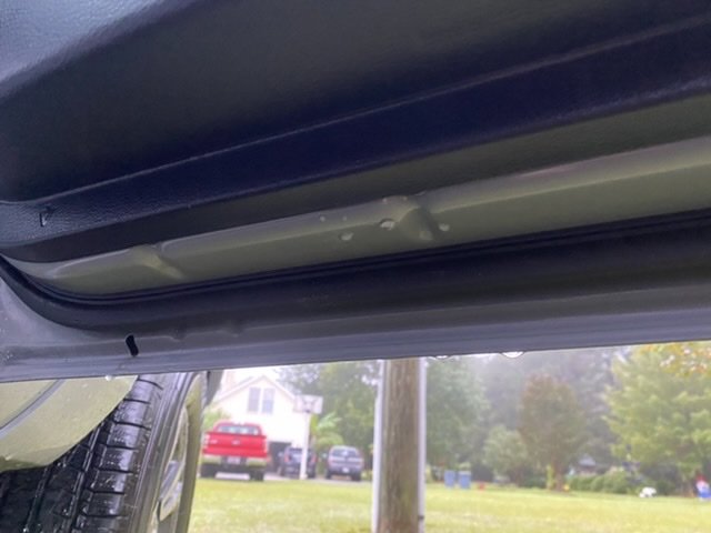

    Let me preface this post by saying that I completely understand that it’s normal for water to get inside the door. However, it should stay between the inside and outside door skins and drain out the drain holes. During heavy rains, I’m getting water between the inside door skin and the plastic door panel. Anyone have any guesses before I start taking things apart? First pic is my truck. Second pic is someone else’s for reference.

    Pop the door panel off and check that the butyl adhesive and plastic sheet are making good contact.

    clogged drain hole id say.

    you can clearly see in my pic that the drain hole is wide open. That’s definitely not the problem.

    I know it’s been a while but I figured I’d update the thread since I’ve seen a few others having this problem. That’s exactly what it was. There was a small section where the plastic sheet wasn’t stuck to the adhesive. Easily fixed and no water after 2 days of heavy rain.
