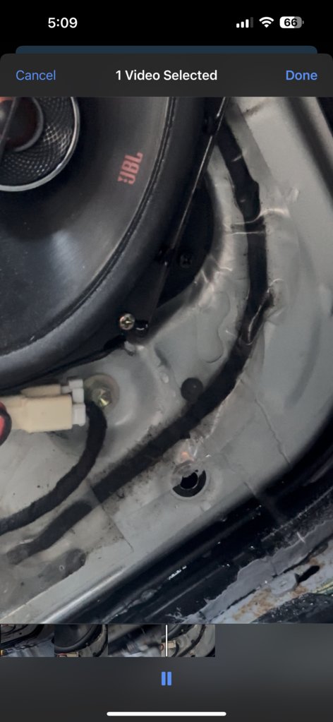

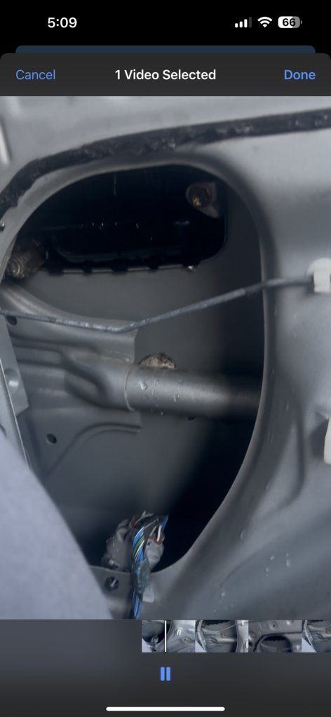

    can you Post a pic of where it is coming in?

    So it leaked where the door handle and it drips off the top of the door then rolls down to my speaker

    Ok,looks like the first pic is from inside the door...thats normal.You have to shut the door,get somebody to wet the door while you watch it from inside.any water coming though that liner,or through the metal part of the inner door has to be stopped..no water should be coming outside the barrier.
