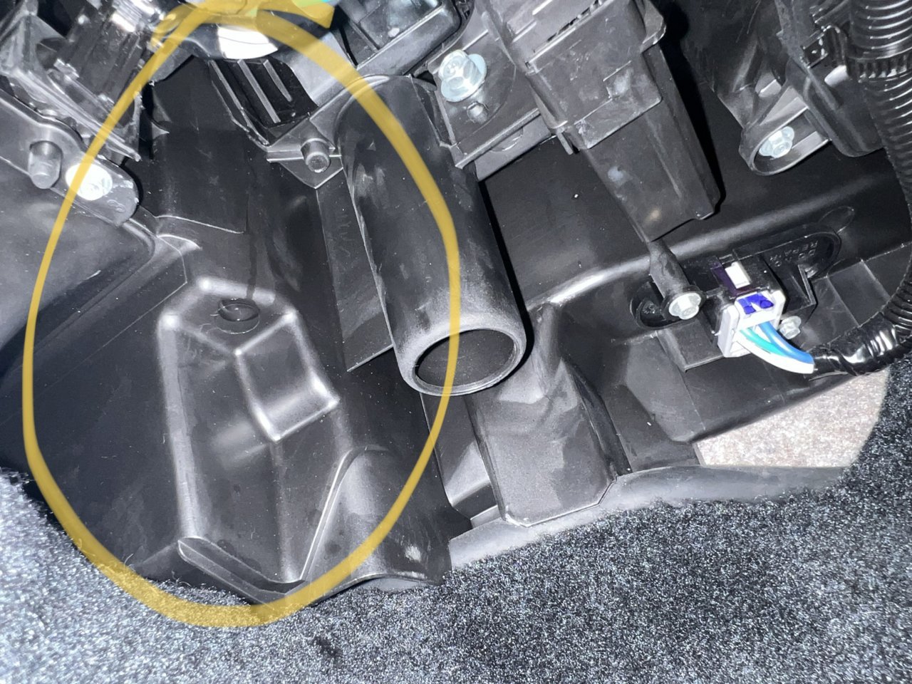

    So I have been having this same issue on my 2019 Tacoma TRD Sport! I was thinking originally it was an issue with the windshield, since I had it replaced October 2021 at Satellite and they really messed it up. They didnt seal it at all on the driver side and water flodded my cab. So I was angry and told them it was leaking again!! Come to find out, they inspected it and found no issues with their installation, and I didnt believe them! I have a leak now on my passenger side, coming from up in the dash so I am thinking what else could it possibly be other than the windshield. We checked the cowl and the cabin filter.... dry and no issues. I pulled the AC drain tube and it isnt clogged.... no issues! Finally, I am searching on google and youtube and find these threads where people are talking about this known issue with the evaporation box condensation and leaking water on the floor. I now noticed this is only when the AC is running high for a bit of time.... I see there was a reply about going after the Lemon Law and Toyota is apparently aware of the issue, but will not recall. So I will make a complaint and contact the dealer, to make sure they are aware of the issues that are on going with these 3rd gen!! I have the picture here and this does drip down right on my carpet, since my Weather tech mats dont cover this area on the upper left side. I am out of warranty I am sure, so I wonder what they solution will be....

    Good luck to ya! Hopefully more people will file complaints and lawsuits against Toyota so they will be forced to fix this design flaw so others won't have to go through water dripping on passengers feet, on the electrical wires and as we all know, where there is constant moisture on carpet, there is a potential for mold which is a big deal these days! There is alot of threads on here under different titles about water dripping when running AC, which is the outer HVAC box sweating and dripping on floor, some has said that it happens in 2nd Gen also, just can't believe people have excepted Toyotas explanation, OPERATING AS DESIGNED!!!!! No other vehicles I have ever, had, seen , ridden in or other people's vehicles have had water dripping on floor, unless it was a windshield, heater core, cowl or stopped up drain tube causing water inside dripping on passenger floor!

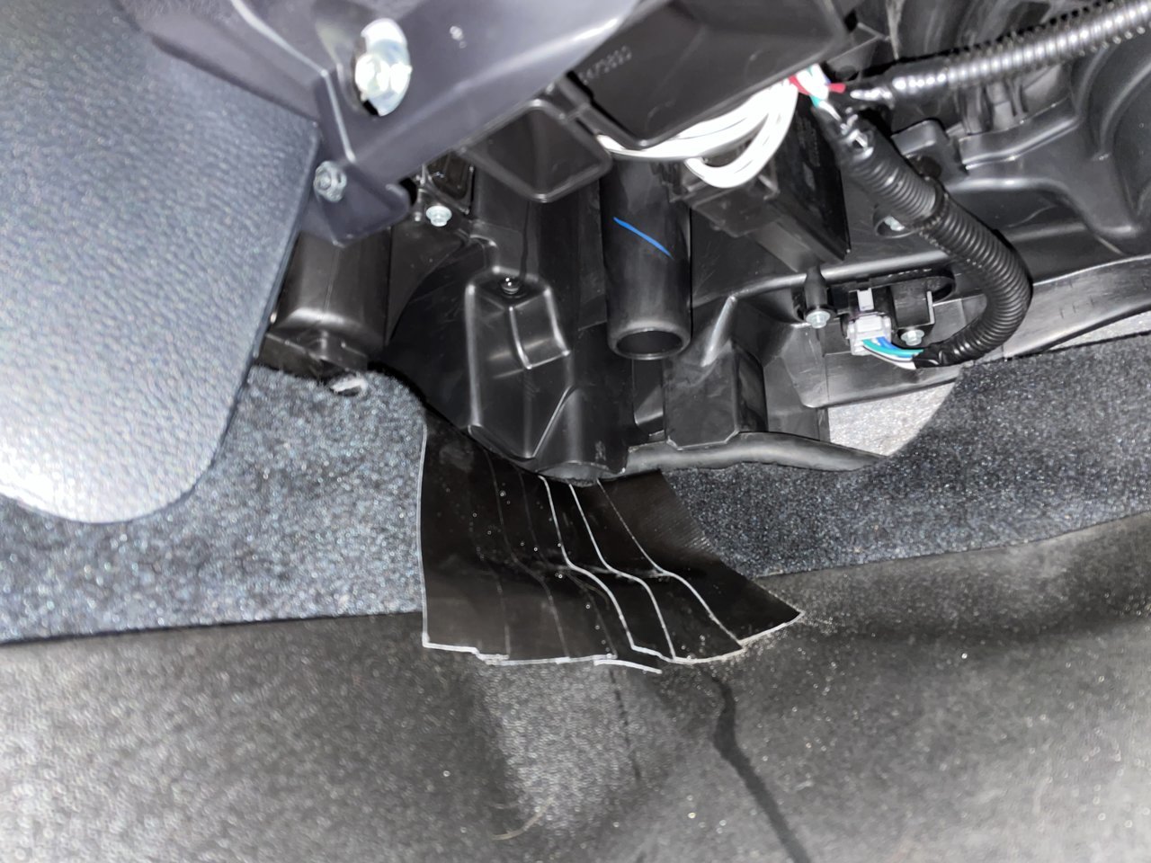

    It seems stupid. But I placed some tape up there. Keeps it from running under the weather techs. I’ve yet to have it fixed.

    It's not stupid, your just trying to keep it from getting on the carpet and mold , mildew from developing! I seen on the thread on here,AC LEAKING where someone put a makeshift like funnel there to try and channel the dripping! But people who ride in the passenger side will get there feet wet if they have there feet in that area. I see on here where this is a common design flaw that alot of people are having, am I the only one who has a lemon law brewing over this design flaw by Toyota? Is anyone else filing cases w/ Toyota Corp so they will fix this obvious design flaw or is everyone just going to accept water dripping on the carpet and people's feet?

    If there is a Toyota TSB, does anyone know the name of it or identification number so I can look it up to see what going on, Toyota hasn't notified me yet and I have a lemon lawsuit brewing over this problem, all I want is for my 40,000 $ truck not to leak water on carpet and people's feet! I don't see how a fitting or hose is going to fix the outside of the HVAC BOX inside of the vehicle from sweating and dripping water? One of the numerous times I took mine in when it was dripping water onto the floor, they took it apart while I was there and exposed the HVAC BOX and it was literally covered w/ condensation and nowhere for water to go but down onto the floor!

    The design flaw of water dripping onto the passenger side floor is coming from the outside of the HVAC BOX, (which is behind the glove box) sweats when running AC in humid conditions(mostly on long drives) then drips onto the floor, or someone feet !!!
