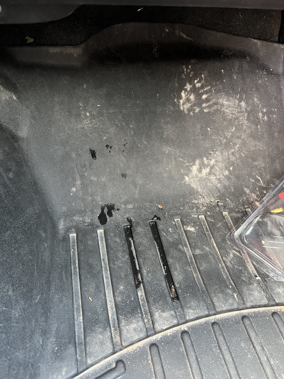

    took a look at mine today and mine is dripping too! wtf man! this is a brand new 2021...it seems to be condensation so it felt like a teaspoon of water.

    Ok, bringing a dead thread back to life here. I’ll add mine to the ones having the issue. Mine is running out of the passenger side floor vent, and down the sides of it. Seems to do it all the time when the AC is on auto. Recirc on doesn’t effect it, drove 2 hours like that and it didn’t change it. Cabin air filter is clean and dry, don’t think it’s coming from the cowl. Took drain tube off, cleaned it all the way thru. It was clean regardless. No sunroof. So frustrating. Has anyone who posted here earlier gotten a resolution to the problem?

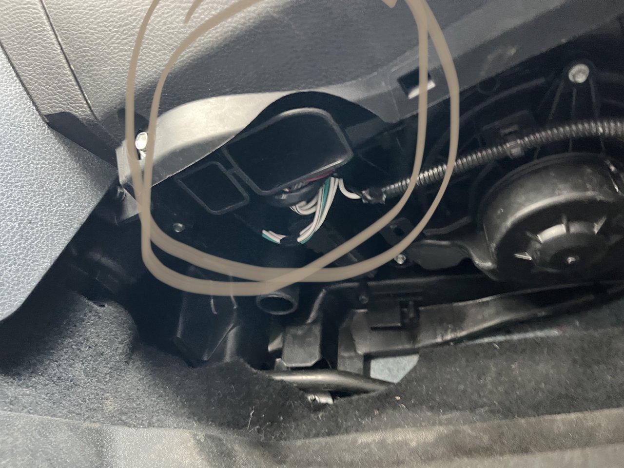

    Do you mind taking a pic of where they siliconed if you can?
  14. Sep 27, 2022 at 10:03 AM
    #74
    cryptolime
    cryptolime Here to Help
    Dec 2, 2021
    #383651
    2,466
    Wilmington, NC
    2021 SR 4x4 2.7L
  15. Sep 27, 2022 at 10:06 AM

    Appreciate it. I'm so frustrated. I'm 10k out of warrantee and this shit starts up.
