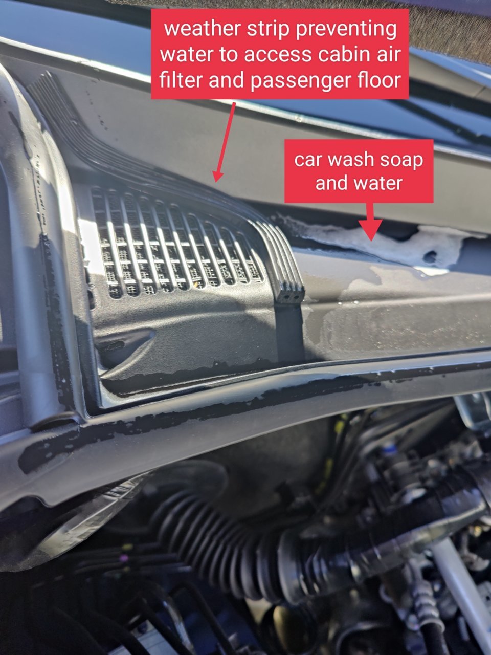

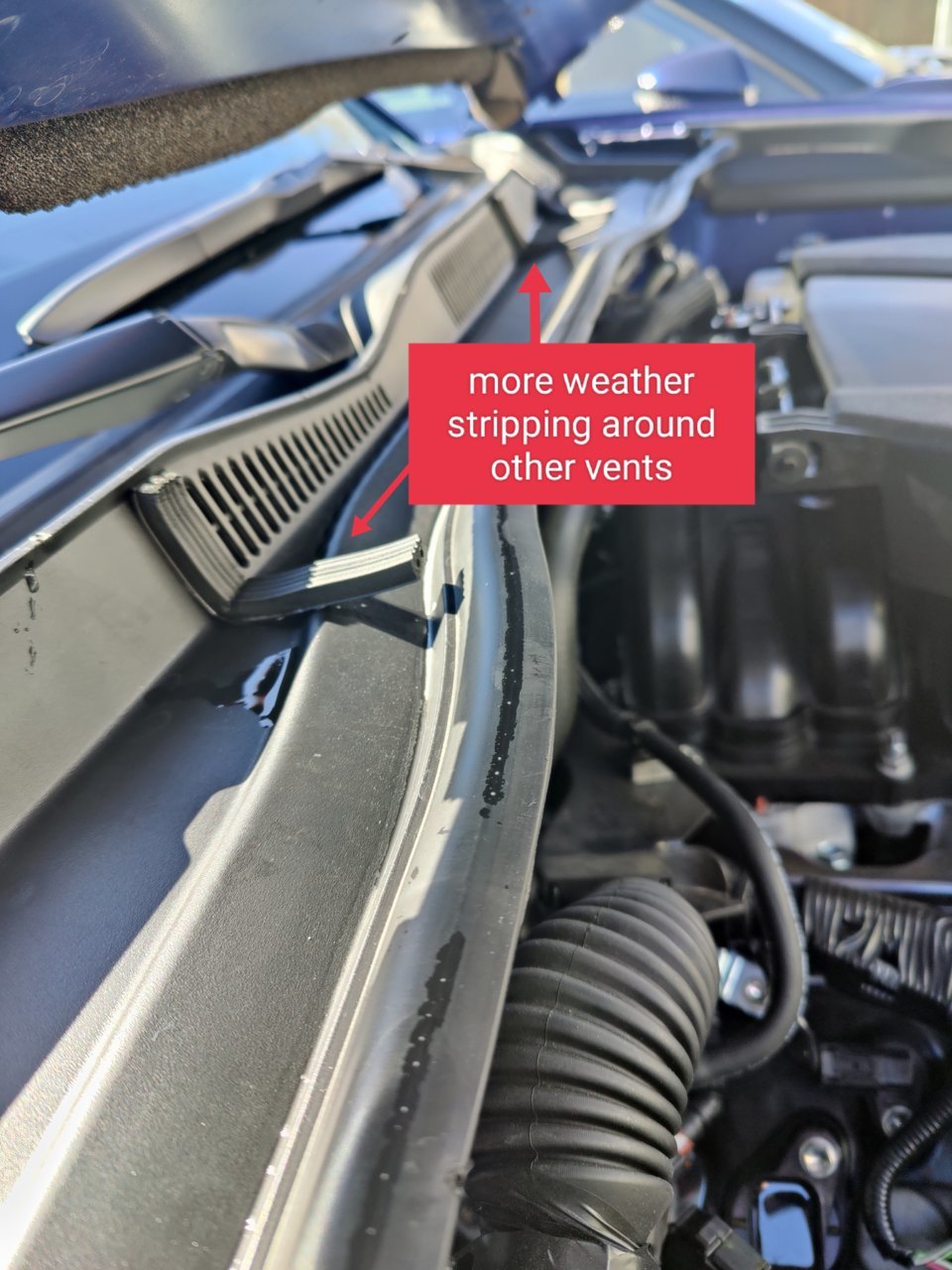

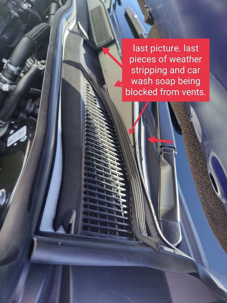

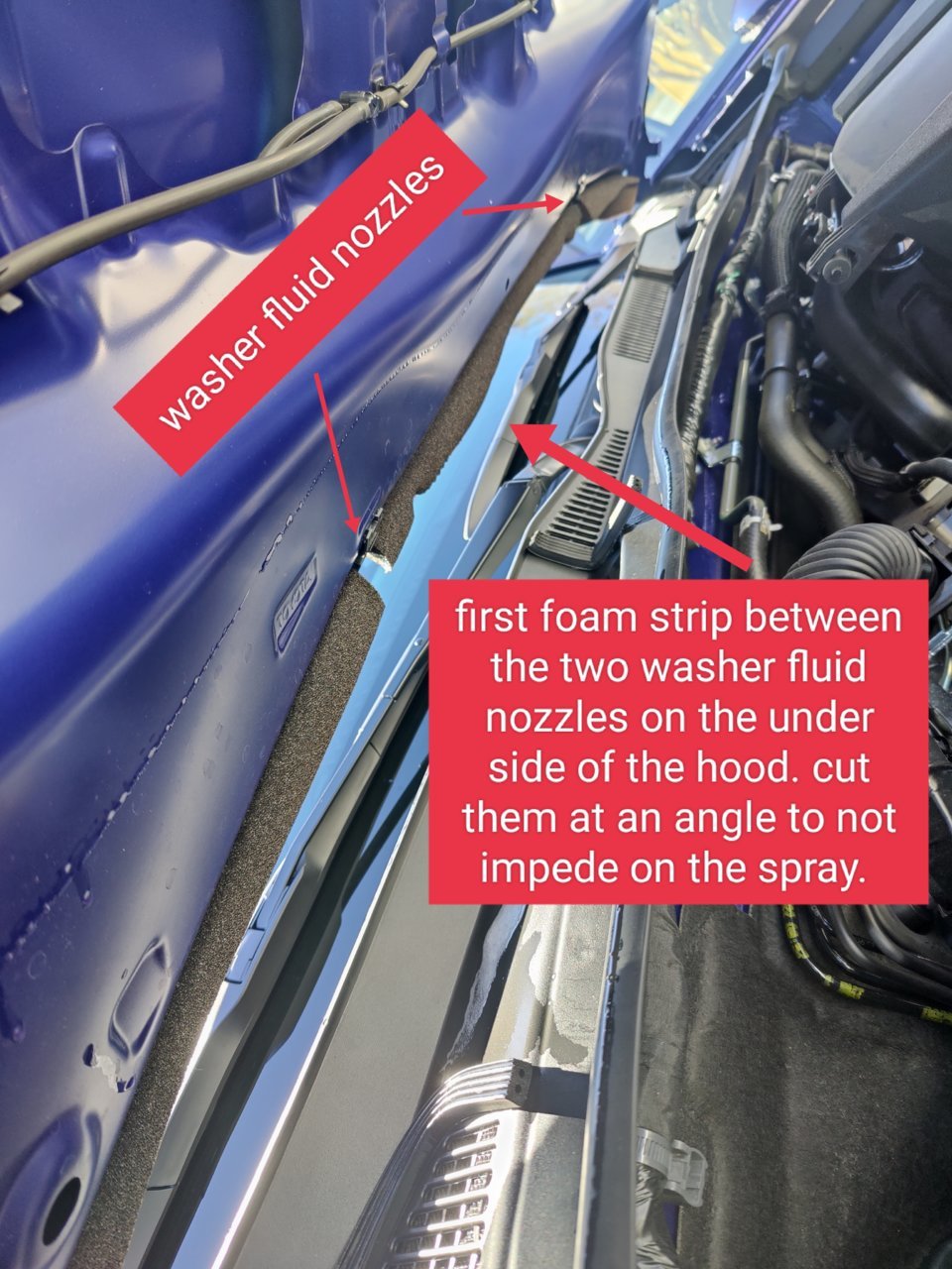

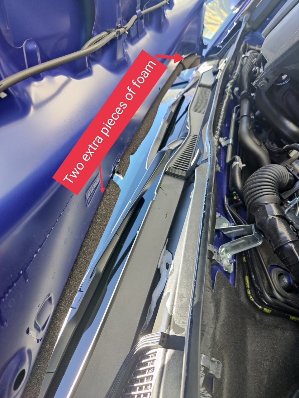

    Had the same issue but i took it through a high pressure carwash which helped. the cabin air filter did get wet. I've seen some crazy "fixes". I'm guessing there is more than one reason for these leaks. in my situation, the water (soapy which made it easier to follow) was coming in through the vents in the cowl. i did two things and if i were to do it again id go in reverse order and and see if i could do without the foam but it's working so I'm leaving it alone right now. i took weather stripping and put it around the vents so when water gets in will be channeled around the vents. i also bough some 1 1/2" X 1 1/2" foam seal stripping, same place you'd get weather stripping.
    anyway i stuck the foam seal on the underside of te hood to minimize the gap between the hood and cowl. i cut Three strips and cut at an angle near the washer fluid nozzles to make sure the foam would no impede on the nozzles spray radius.
    here are a few pictures. this was a simple fix and it's working so far. IMG_20221223_123043.jpg IMG_20221223_123211.jpg IMG_20221223_123445.jpg IMG_20221223_123604.jpg

    last two. could fit them in one post. please share with others if they need. IMG_20221223_123604.jpg IMG_20221223_123832.jpg

    Been over a month with heavy rains and several car washes, floorboard and air cabin filter bone dry with this quick fix.
