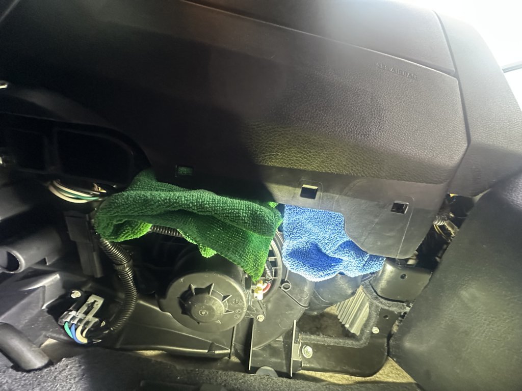

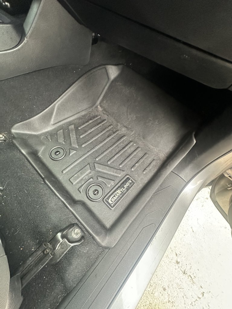

    I’ve had this problem twice now in my 2018 4 door Tacoma with a sunroof. Passenger side is completely dry when I get out of the truck and in the morning there’s a huge puddle in the weather tech floor mat and carpet wet underneath. Had it happen once in august when we had a big rain but I had a small cooler up there so I assumed it was the cooler. Then it happened last week when I hadn’t driven the truck at all the week prior and again after a big rain. I checked the sunroof drains and the passenger side drain had a huge glob of white grease from the sunroof slide rails. Pretty sure this was my issue but will update again if it continues.

    This is a common problem when the cowl cover seal fails. The water leaks into the HVAC system.
    I designed a kit to fix this. Please check out KIT4.
    https://www.tacomaworld.com/threads...l-kits-and-hvac-screens.811746/#post-29114338

    I have a 2021 Tacoma trd off-road and I’ve been dealing with the same issue. Took it to the dealer about 3 times. They kept saying it was the window (because I had it changed through safelite) had safe lite take off and reinstall it. Then it kept happening. Went back to Toyota. They said they didn’t do it right so they did it again. Still happening. Now they’re saying it’s a faulty window. I doubt that’s the issue being a lot of people have this issue. I opened the hood. It looks like water can go through the air duct. It’s a faulty design but Toyota refuses to take responsibility for it. Anyone ever get Toyota to cover it?

    Mine always leaks on passengers feet, when the aircon is on. It's not your windshield at all.
