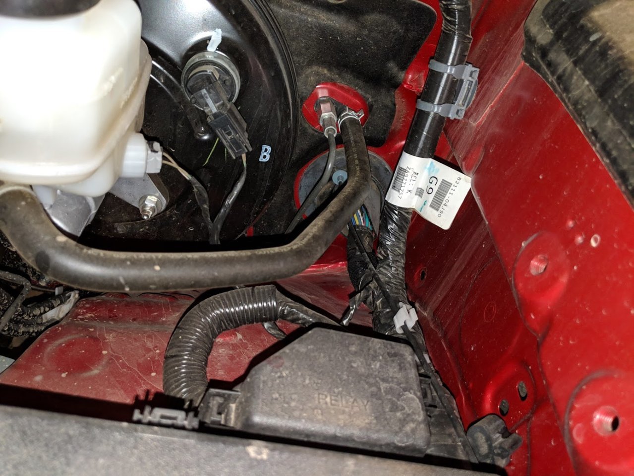

    tonered
    tonered bartheloni
    Sep 25, 2017
    #231055
    31,227
    tony
    Lynnwood, WA
    Agreed. This was after a frog choker yesterday:
    That dust and splashes likely came from offroading and the car washes afterward. You can see a lot of watermarks around most everything but that very back portion of the firewall.
    This is why I am scratching my head for @dilbert 's issue also.
