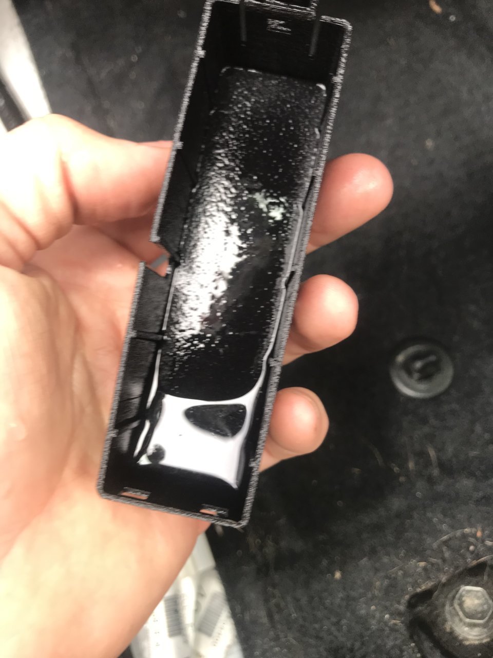

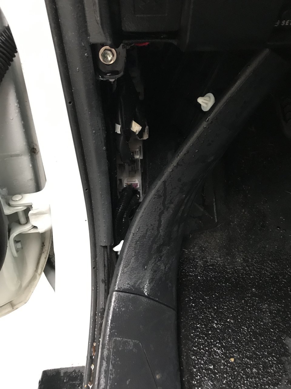

    I never noticed any water on my floor before (at least in the front...) but today after a heavy rain I had a huge puddle on my driver’s side floor mat and water draining all over the wiring behind the dash. The fuse box cover had water in it, the computer back there had water all over it, all the connectors and wiring were all wet.

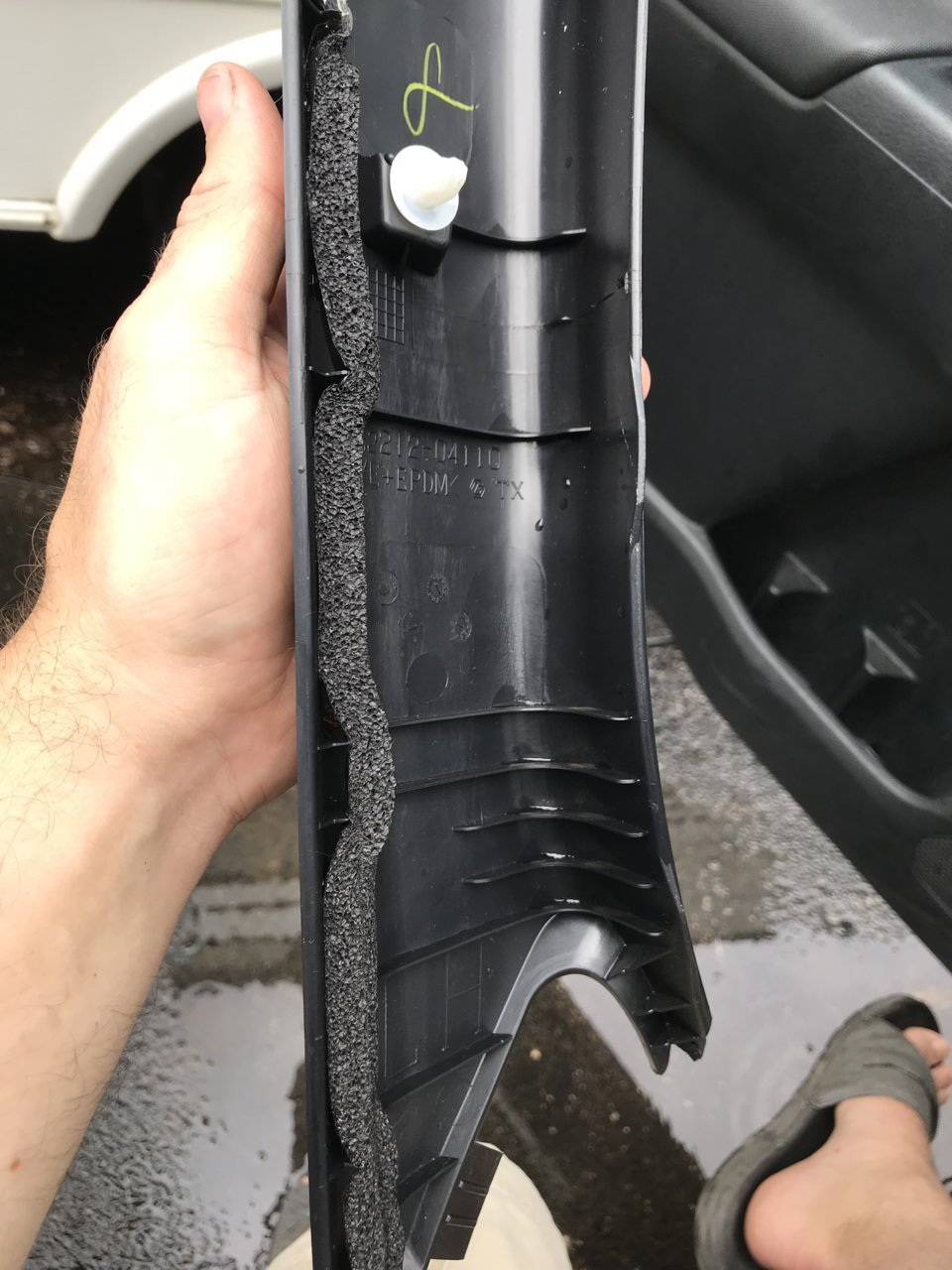

    I pulled all the trim, and it’s coming from the somewhere above the headliner. There was water behind the A-pillar trim and the sheath on the curtain airbag was damp.

    Fuse box cover

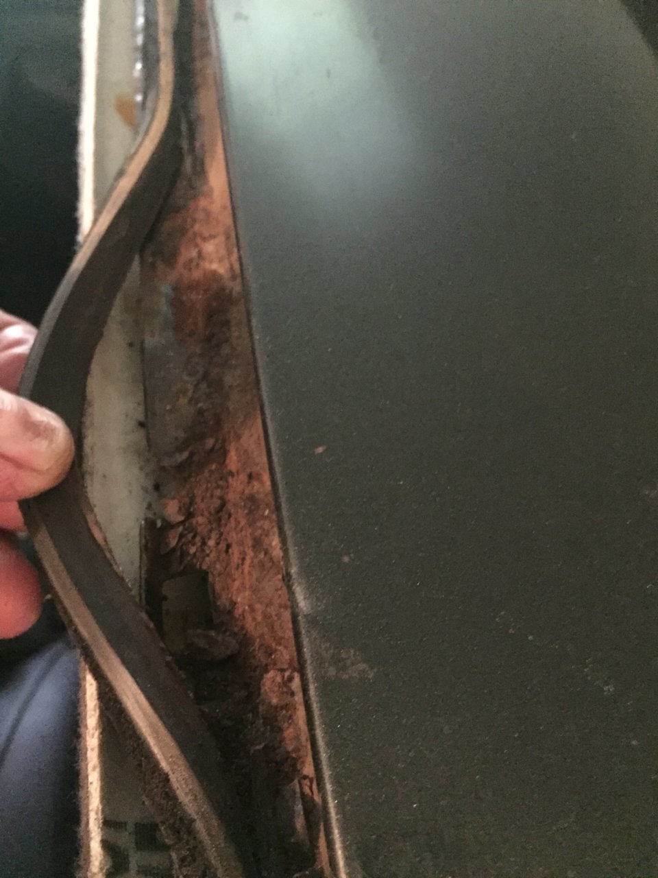

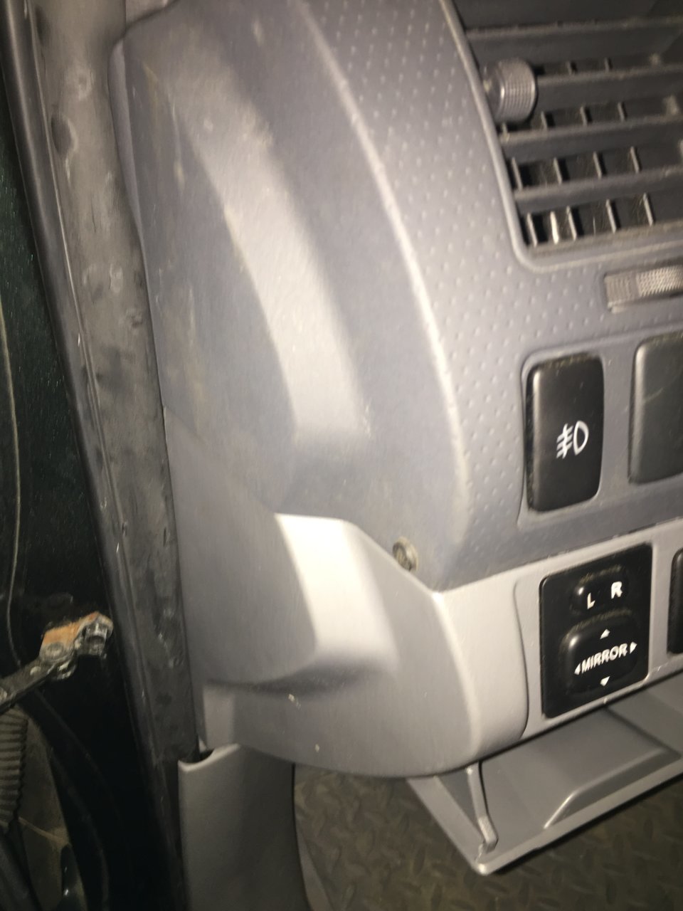

    I have a 2009 Double Cab (no sun roof) and live in New England where the trucks all look like french fries from the salted roads in the winter. I had the frame replacement in May 19 due some rotted cab supports and shortly thereafter started to experience water dripping down from the dash on the drivers side to the point it would fill up that little flip down coin bucket. I checked the firewall, the door gaskets, took off dash trim. The source of the leak was not obvious but had to be from the top of the cab. I removed the A Pillar trim and noticed a couple of drips so I left that trim off and dumped a 5 gallon bucket of water on the cab. No immediate leaks until i grabbed the head liner and got a dump of water. The headliner backing is a stiff waterproof plastic tray. I pried the headliner down and saw water dripping from the pinch weld/windshield area. So it was time to remove the windshield and check for some rust.
    I used the cable tool to cut the windshield off and sure enough there was about 16" of moderate to lightly rusted pinch weld. During a heavy rain the water was running behind the rubber molding and then down and under the urethane that hold the glass on. It then collected in the headliner until it overflowed and traveled down the inside of the A pillar to the dash trim and then down inside the dash to the floor. I removed the rust, primed and painted the pinch weld and then replaced the windshield with a new moulding. Time consuming but relatively simple and no more leak!

    Note that the windshield moulding does a great job of hiding the extent of the rust until you tear it out, but then there is no going back.
    This is where the leak appears in the cab dripping off the bottom of the dash.
    here is the old windshield urethane strip and rusted pinch weld after removing the windshield

    So I’m at Safelite now because I had the same issue and as timing would have it, not long after the windshield replacement. So what it is, the plastic piece that runs along your windshield, there’s a crappy factory seal that they use on the passenger side, above the cabin filter area. That seal goes bad and let’s water in, I park at a slight pitch and it runs the water down the channel to the driver side and it leaks from there. The tech here uses a better sealant and it’s all good. Man do I feel like a jackass haha. But easy fix. To be clear the exterior trim where the windshield wipers are.

    #473582
