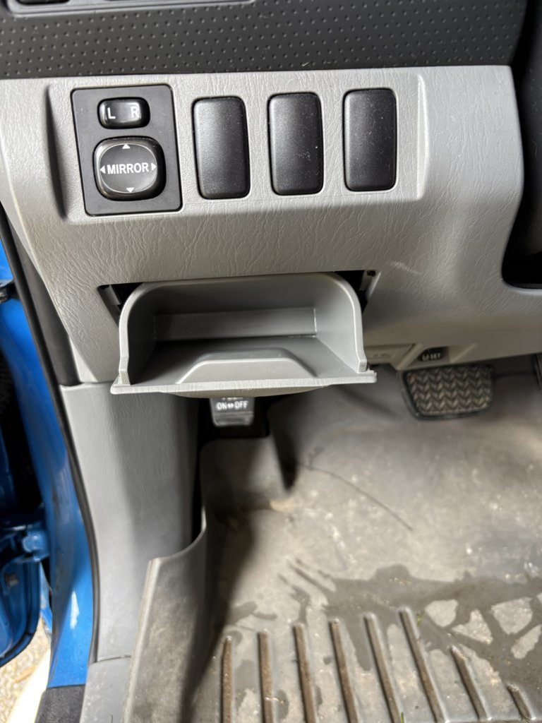

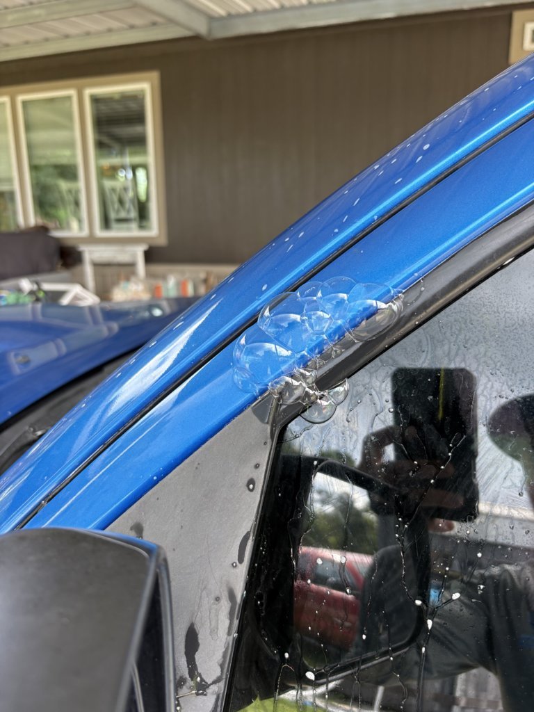

    My wife had her feet soaked when she was driving daughter’s 2006 Tacoma. We’ve had a lot of rain this week. I opened this compartment today & it had water in it. IMG_1104.jpg I went out & sprayed water from hose from top of windshield to bottom, top & & down pillar of door, & all over cowl at bottom of windshield & see no water coming through. The fuse panel behind that cover looks dry. Carpet is dry. Firewall behind pedals is dry. Any help appreciated before I give up & bring it to a shop.

    Cowl seam isn’t leaking. Looks like seam has been welded on & windshield has been replaced. Brand is FUYAO. Not tackling behind fender today. Wife did say water didn’t fall until she started moving, like it was held up somewhere. I broke some clips on cowl. Will that affect anything?

    Took it to a shop. Guy said 3rd brake light was leaking & water running along pillars to dash. He sealed it. Sounds odd to me but we shall see next time it rains, which is next week.
