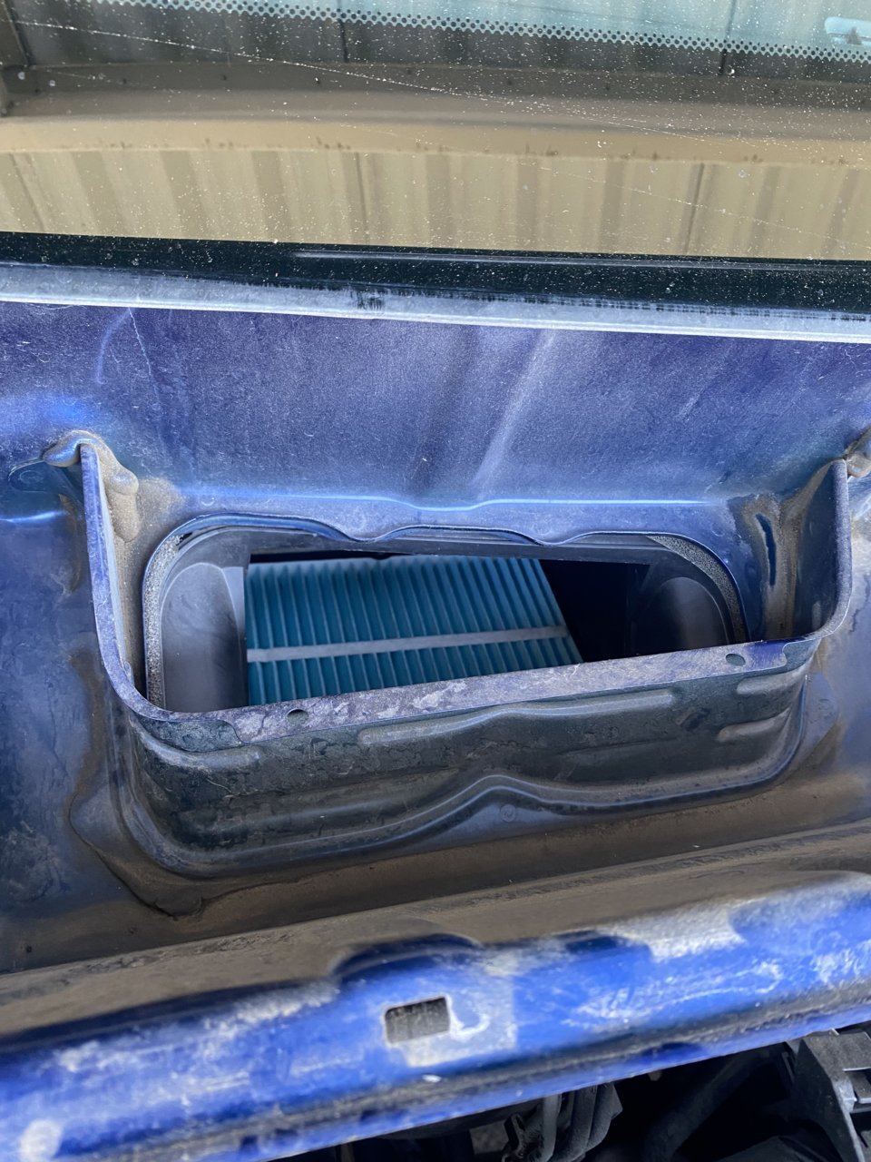

    I’ve got a 2015 Tacoma and after I got a car wash I noticed water leaking on the passenger side floor. I pulled my cabin air filter and it was soaked. Has anyone encountered this? How do I fix it?
    I just got this truck and am pretty disappointed. Hopefully it’s an easy fix.
    Any help is greatly appreciated.

    oh welcome to the party. there are several threads could be a few items, id start with removing, the plastic under the wipers there might be leaks, the simplest. way is to put a cover over the intake to allow it to not just get soaked.

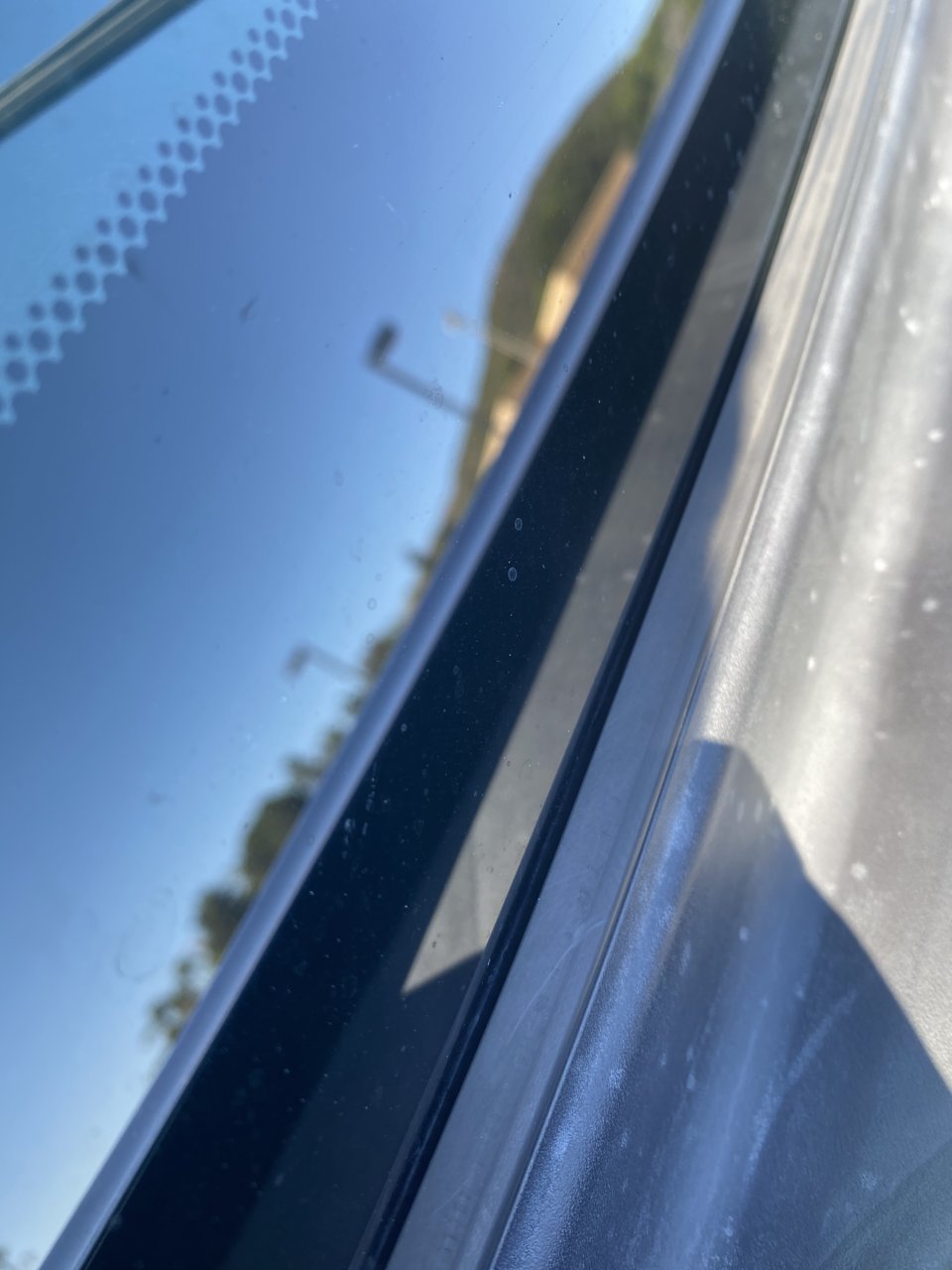

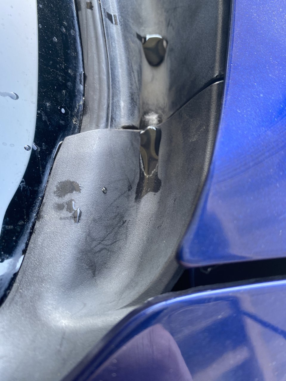

    Here is a photo I snapped of my windshield. There does seem to be a bit of a gap on the passenger side.

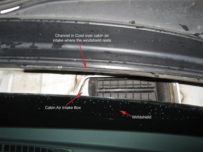

    I know it’s hard to tell by the photo, but would I need a whole new cowl just for that little separation? Is there no drain channel before the air intake into the cabin?

  6. Jun 27, 2023 at 1:01 PM
    TnShooter
    TnShooter The TacomaWorld Stray
    Sep 2, 2010
    #42625
    21,286
    Deogee
    07' TRD Off-Road, Auto
    STOCK
    Could Improve[OP] and HondaGM like this.

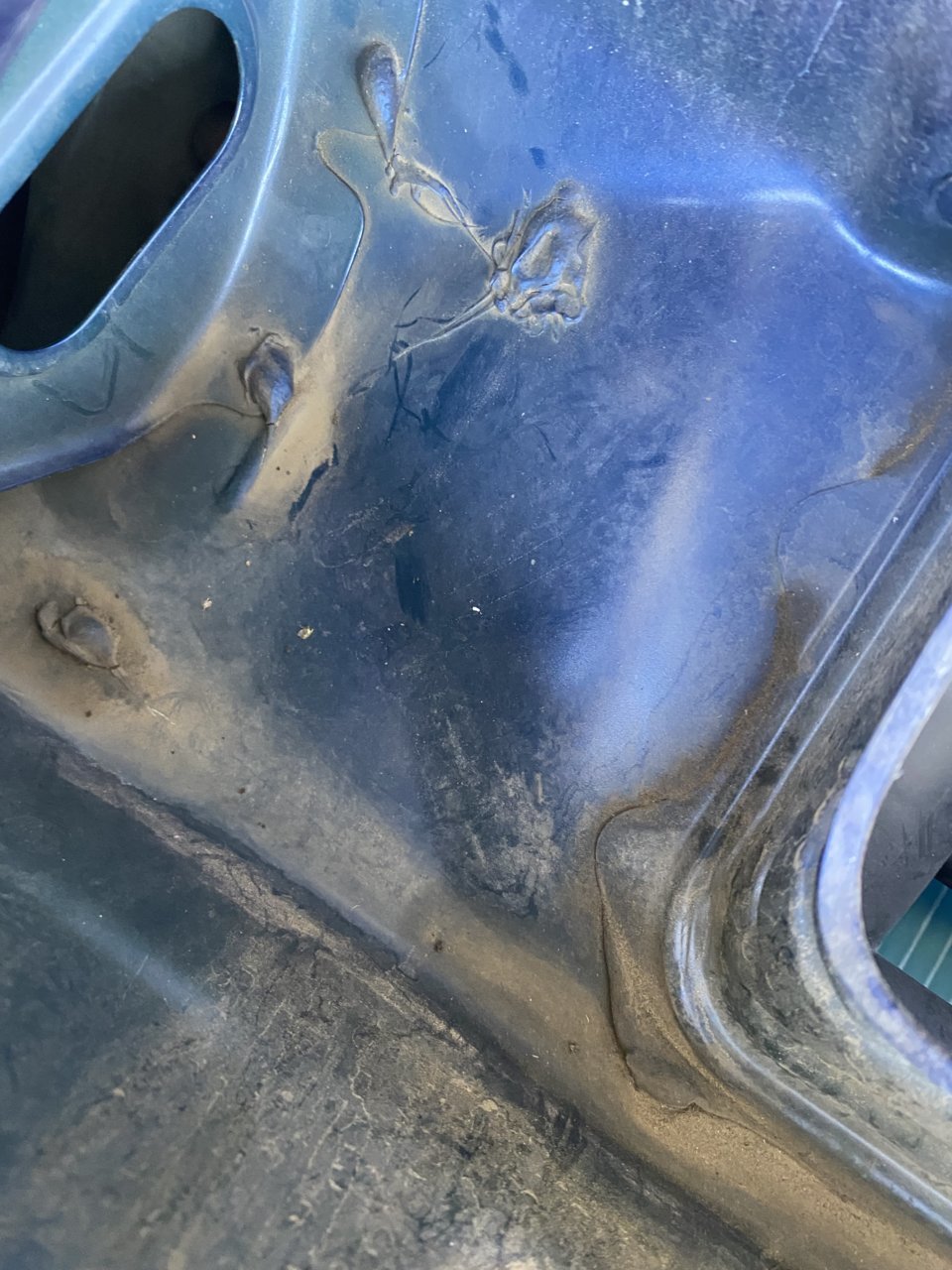

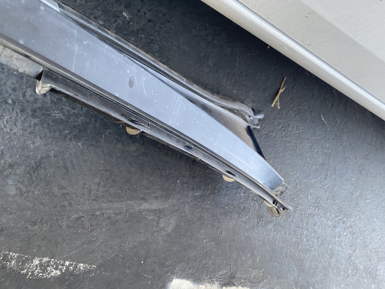

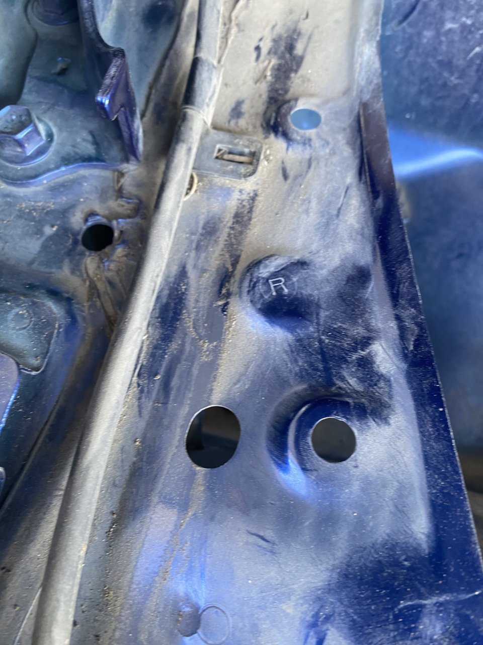

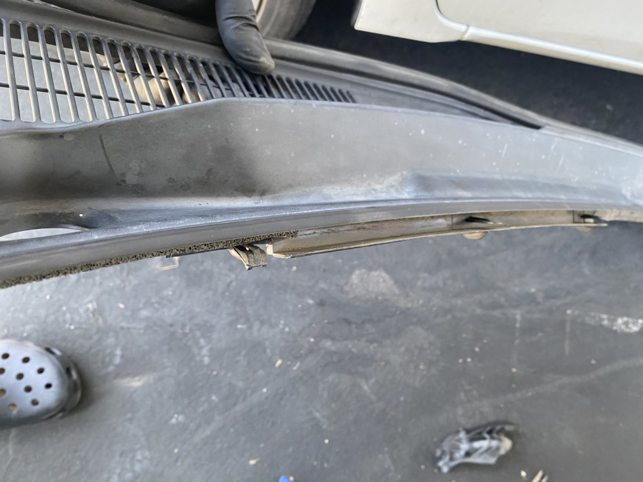

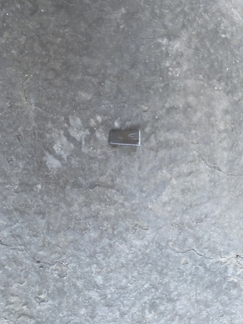

    Well, I pulled the cowl and didn’t see anything in the drains. Maybe it’s just sun rotted and I need a new one? I’m not sure what to do here…
    I did break a tab off on accident, so maybe I just answered my own question.
    The windshield says Toyota Pilkington. I’m assuming that’s OEM? So we can rule out a windshield change I guess.
    Here are a couple of photos:

    The only part I did notice that was clogged up was the side wedge of the cowl (not sure what to call it). The clog was mostly in the mating parts of the wedge and cowl.

    California
