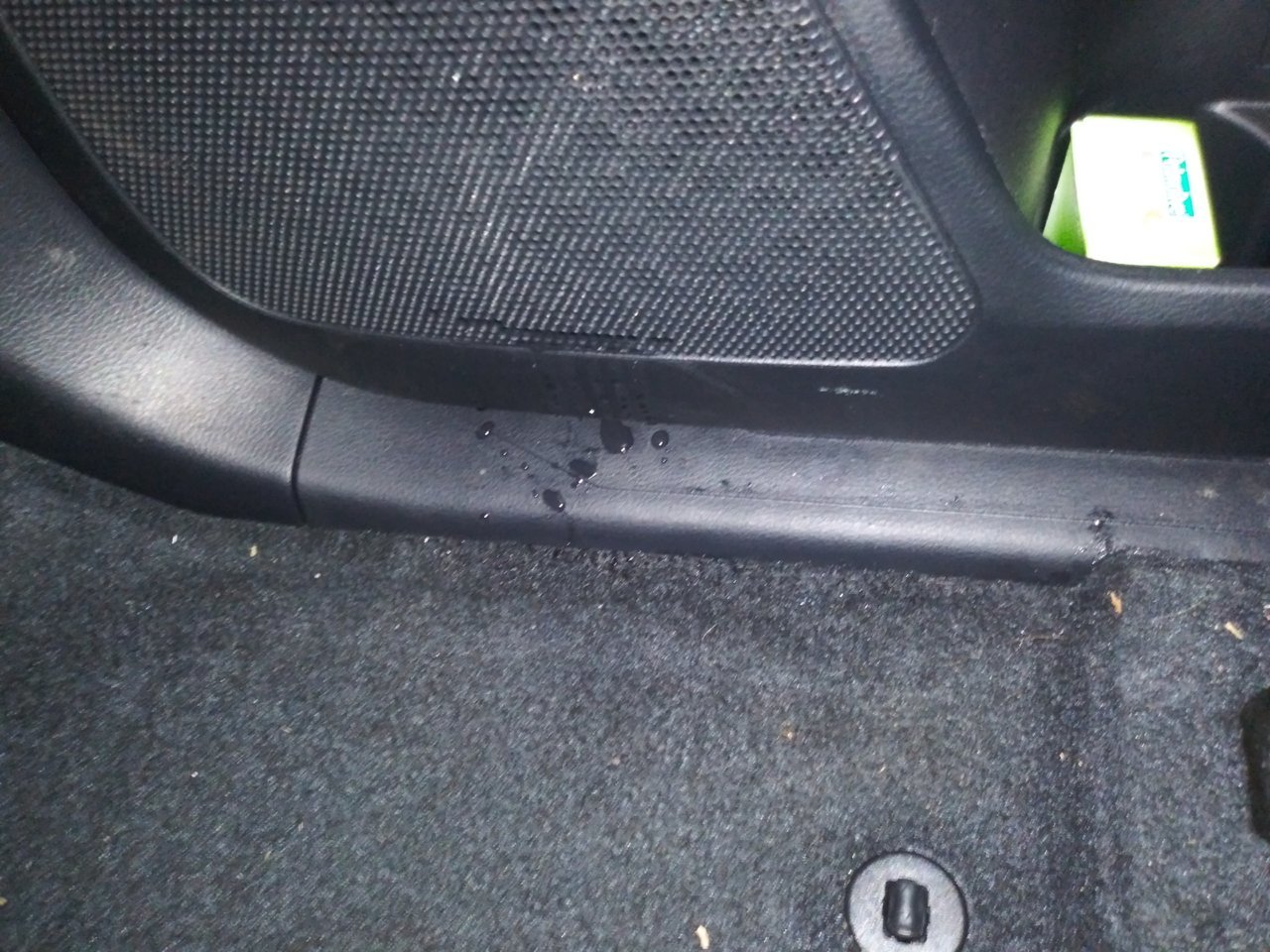

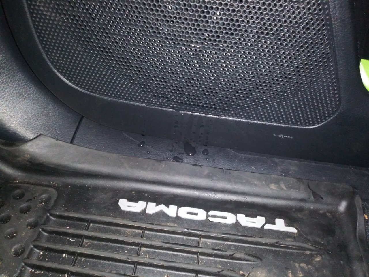

    I had professional installer put new speakers in the front doors about 6 months ago when i bought the truck.
    In heavy rains, I get some water leaking through the bottom of the speaker grill
    I took it to dealer, and they put the passenger door area under a road shower for two days and could not find any leak. Dealer gave it back and said nothing is wrong with it..20181124_205319.jpg 20181124_205254.jpg

    It would be pretty difficult for water to get from the outside of the glass, past the speaker, and out through the grill.

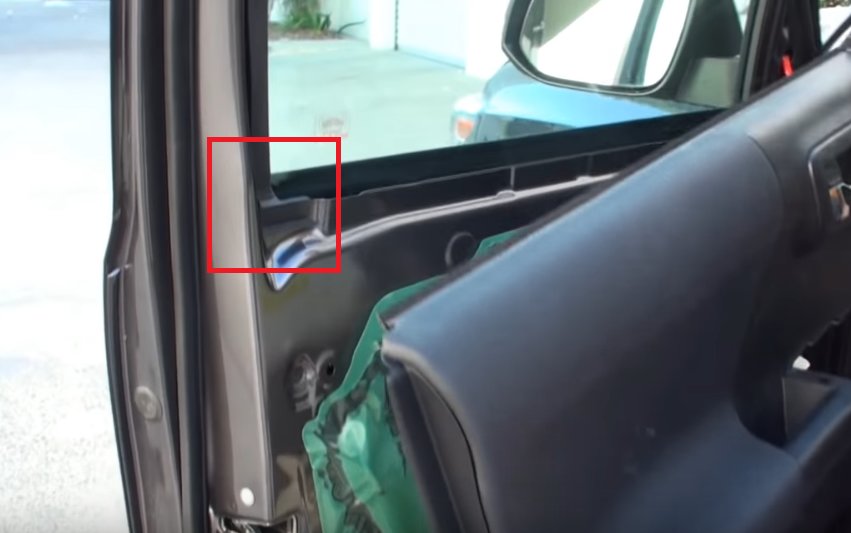

    It sounds like the panel wasn't reinstalled properly, so water can sneak past the inner seal when the interior of the door is exposed to rain, but it would have to be a lot of rain to make it leak like that. When you watch the video linked below, you'll see why I say that. The weep holes in the bottom of the door might also be plugged.
    It's very easy to remove the panel, just make sure that you reinstall the cables properly. Also, make sure the rubber piece highlighted in red below is accounted for when removing the panel, it likes to pop off and you can be confusing to reinstall the first time it happens:

    It IS only when there is a big rainstorm that it leaks. A normal shower causes no leakage.
    However, you mentioned that this should only happen when the interior of the door is exposed to rain. I never open the passenger door. I always note the leak when getting in through the driver side, then looking over at the passenger floor. I don't leave windows open. The only water that could get in is condensation from the window. You think that could cause it, if the door panel was not properly reinstalled?

    I used to be an installer, not for Best Buy, but I worked for a local audio shop for a couple years then went to 2 auto groups and worked for 10 years. The truck takes a factory 6x9 speaker. Did they replace with a 6x9 or use a 6x8 or a 6 1/2? More than likely either way they didn’t use a speaker mounting bracket. This could leave a gap in the factory speaker cut out where water can travel when it gets behind the window seals. Water always get in the doors, that’s why they have drain holes at the bottom of the door. It’s not uncommon for a speaker to get wet or have moisture on the back side where the magnet is. No water should be getting into your door panel. More than likely there is a gap around the speaker. Maybe a little more water than normal is traveling past the window seals and down through the door and coming out through a gap around the speaker. Only way to tell would be to take the door panel off and see. Showing these pics to Best Buy they should take a look for free. If so I would request you have a look when the door panel is off if they do. If the dealer pulls the panel off and see it’s from a Best Buy speaker install, they will charge you for their labor and any repair they need to make. So let that be a warning to you. If Best Buy is unwilling to do anything, If I were you, I’d pull the panel myself and have a look.

    Thanks a lot for your post. They did replace then with a 6x9 speaker, and they did use a speaker mounting bracket. He told me after installing that he had to drill a small hole, did not say any more than that.
    The strangest thing is that it does not leak all the time. Yesterday, we had a heavy day of rain, and there was no leaking at all. However, a couple days prior, there was a heavy rain storm and it leaked.
    The dealer held it under the rain shower for two days and there was no leakage.
    I have noticed the leak probably a half-dozen times and I think I am starting to smell mold.
    Is there any explanation why it does not leak every time?

    The only openings in the door are at the wiper seals for the window, mirror mount, the harness connection, and the drain holes at the bottom. Are there any visible gaps at those locations? What happens if you squeeze the harness?

    So they took the door panel apart and screwed everything in tight, and it looked fine.
    But it still leaks in a heavy rainstorm.
    I will take it back to dealer and ask them to look inside the door panel. I am sure I will get a hard time about the aftermarket speaker.
    Is it normal for water to get inside the door panel to begin with? I am wondering if it is a flaw with Tacoma.
