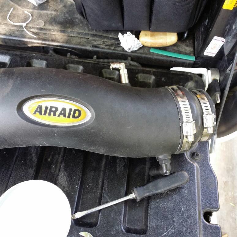

    So I picked up part of a used water meth system for dirt cheap. Decided to give it a go. I used water meth in my big turbo with great results. total cost for me was 240 cdn that's including buying a new controller.
    First thoughts on the drive.
    I get at 1 -2 psi more boost from the sealing effect the Injection has on the twin screw blower.
    My intake manifold and blower are Luke warm to the touch.
    so far so good!
    Some install pics

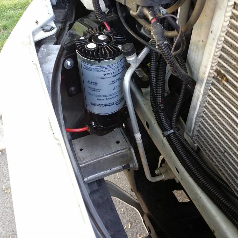

    Pump location. Had to be there its as low as I could get it
    Jet installed right into the airaid intake

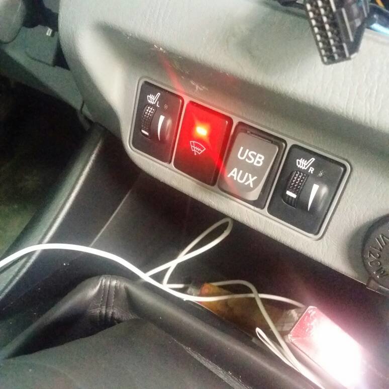

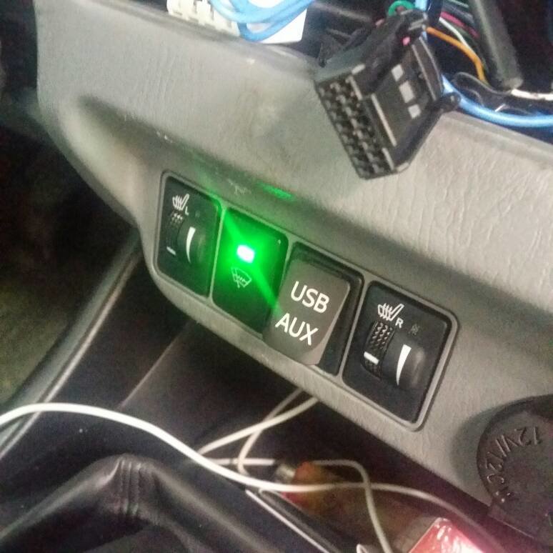

    Home made warning light from a switch I did not use for heated mirror install. Green means the pump is pumping and flashing red means I have 1 liter of fluid left

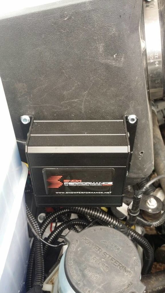

    Control box located on the airaid filter box

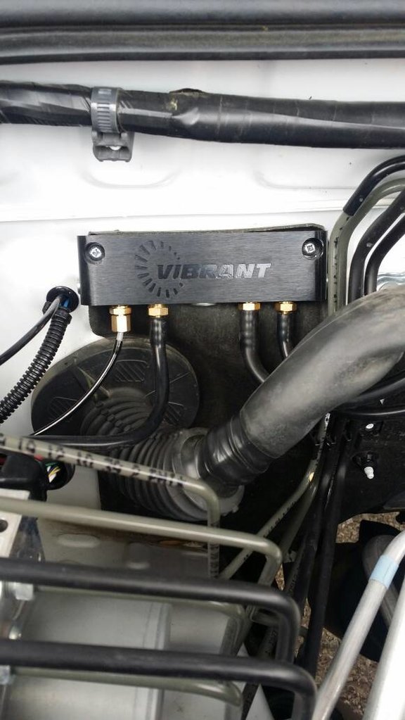

    Vacuum block on the firewall

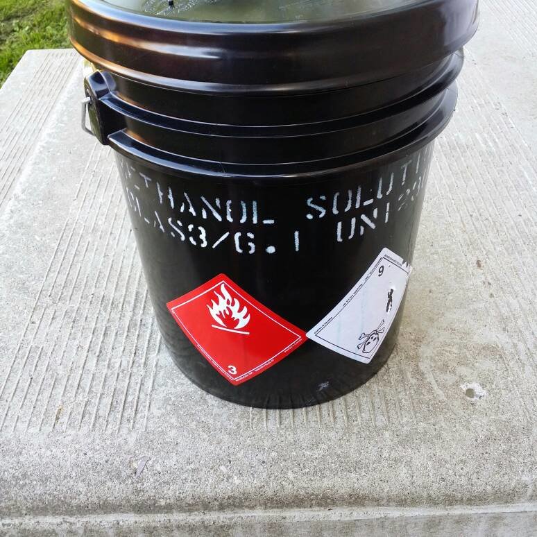

    Big ol tub of meth to mix 50/50

    It's a little to early to tell but I was getting between 8.50 (27.6 mpg)and 10.1 (23.2mpg)L/100km according to the ultra gauge cruising at 110km/HR(68mph) I NEVER have got that low before. I was doing a bunch of WOT to see how it reacted, but on the way back I took her easy. I just did a trip to winnipeg and averaged 13.2(17.8mpg)!
    That's with 265/75/16 duratrac @ 38psi. Hope the good milage continues would be a great by- product lol.
