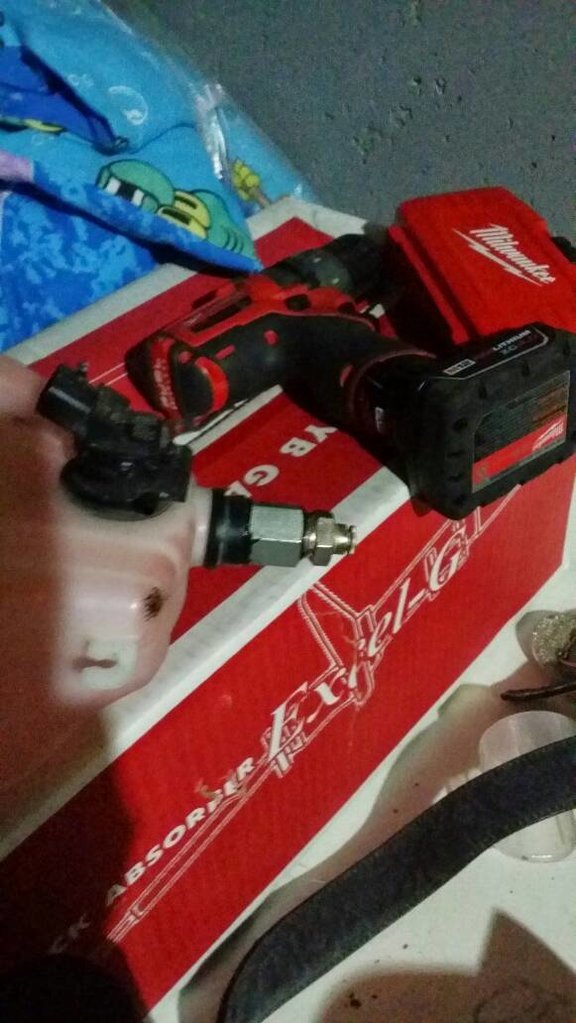

    I tried the calculators first is how I came up with that nozzle. I think it should be bigger but I am no expert lol
    I thought I took a picture of how i mounted a fitting onto thr bottom of thr factory washer jug lol

    Found the pic! I just drilled the center of the rubber thing that stuck into the hole in the fender.

    Ah, gotcha. That's the only thing I'd be concerned about is where to mount the reservoir.

    Really limited on where to put it. I thought of mounting it in thr fender but filling would be a pita. Imo factory jug is the only way to go
