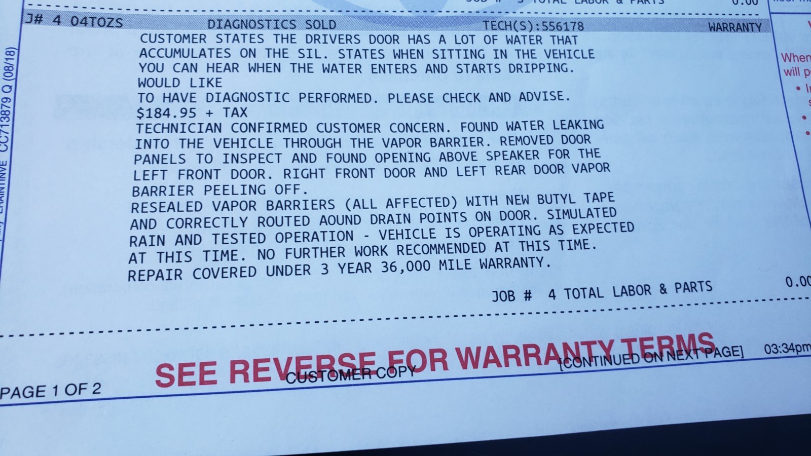

  5. Apr 9, 2024 at 1:46 PM
    #25
    Tech1029
    Tech1029 [OP] Well-Known Member
    Apr 4, 2023
    #421816
    54
    John
    2023 DCLB Off Road Lunar Rock
    Just an update. I just got back from my 5000 mile service where I mentioned the water issue and showed them the photo posted above. You can see by the report I did have an issue with 3 of my doors. Again I have to mention I didn't have a few drops on my sills. We had a couple of nor'easters pass through in the last few weeks. Enough to put a hurting on my basement. When I opened my driver's door it was like someone threw a Dixie cup of water on my shoes.

  12. Aug 26, 2024 at 5:02 AM
    #32
    Tech1029
    Apr 4, 2023
    #421816
    54
    John
    Sorry guys I haven't been monitoring the site and didn't have notifications turned on for the thread.
    I'm not exactly sure what the dealer did inside my doors but for the most part it's been fixed. I say most part because I still see one little spot by the front most weep hole but only after heavy rains or bucket and hose washes.
    To the people saying this is normal, I have to disagree. Yes there are weep holes up that high but they have a rubber plug thingy in them.
    Being my truck is so new and had that issue I will not take my doors apart just yet to see how the defects are occurring. This way I can bring it back again if need be should something in my doors (speakers regulator or whatever) should fail.
    Did anyone else who opened their doors to reseal the barriers take any pictures of the inside and can post in this forum?
