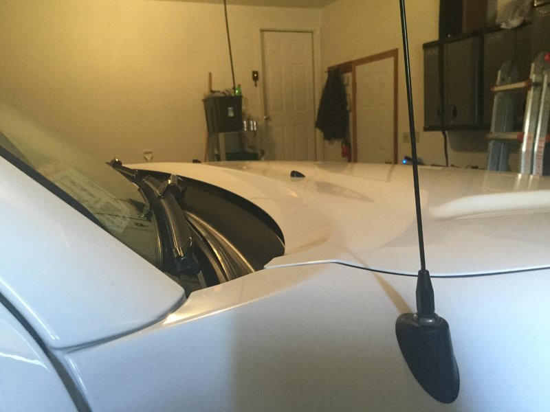

    So today I pulled the cowl to check to see if anything obvious shows up. Looks like a pretty crappy design of the air intake as it's a big opening right under the cowl on the passenger side. I cleaned and reinstalled the cowl and seals but one thing I noticed is the lower windshield seal that is attached to the cowl does not seal to the windshield right over the air opening. There is a trough that the water should flow through to the drain. I doubled checked my install of the cowl multiple times to make sure the little tabs are aligned right under the window. But the cowl and seal will not sit tight to the windshield. I know absolutely nothing about windshields. Is it possible that either the plastic cowl is deformed by the windshield technician or is it possible the windshield curve isn't quite right? Pic posted below if you can make out the area. You will see a darker black line right off the windshield. That's the gap I'm talking about.IMG_0605.jpg

    RTV that bitch if you have to

    yes it is entirely possible that the curve is not right. I had the same prob, both upper and lower corners flattened out and none of that trim fit right.

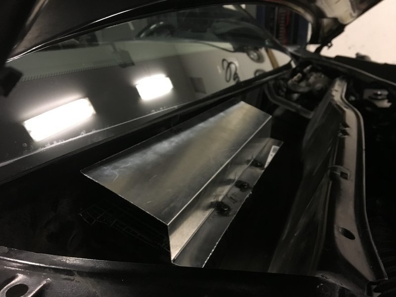

    I made a flashing to cover the air intake opening so no water gets in.
    RBTaco[OP] likes this.

    I saw that. I do like it but my issue is it didn't leak before. So now it appears that there is an issue with the way the seal doesn't seat against the windshield right above that area. I very well might make a shield,but if it was done correctly, I wouldn't have to.

    I'm starting to think it's because the lower windshield seal is about an 1/8" away from the windshield right over the cab air intake. That gap is probably 10-12" long. That seal should be laying against the windshield
