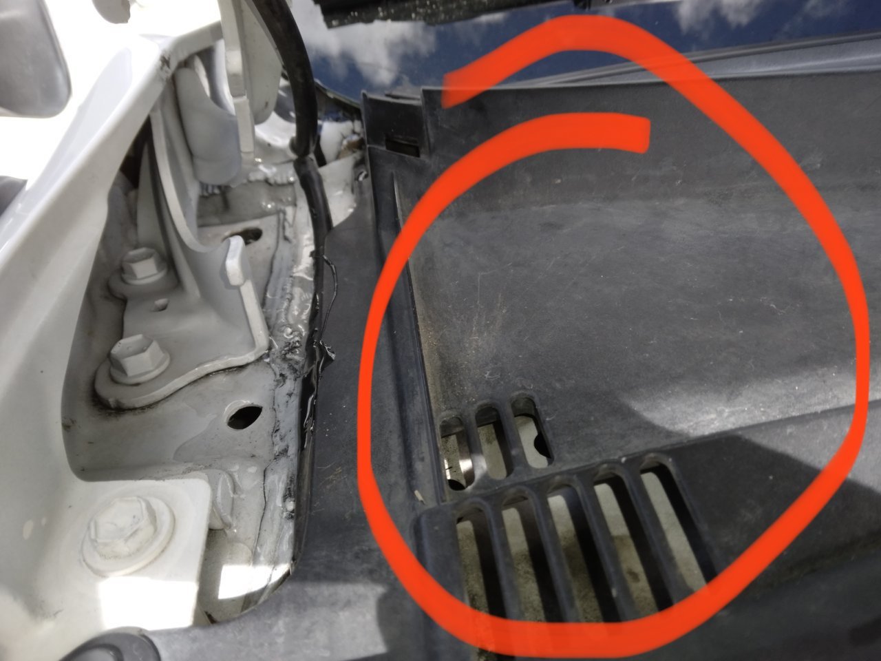

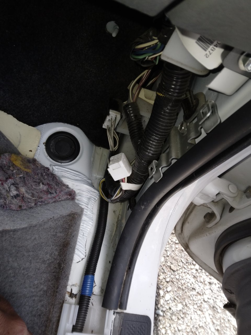

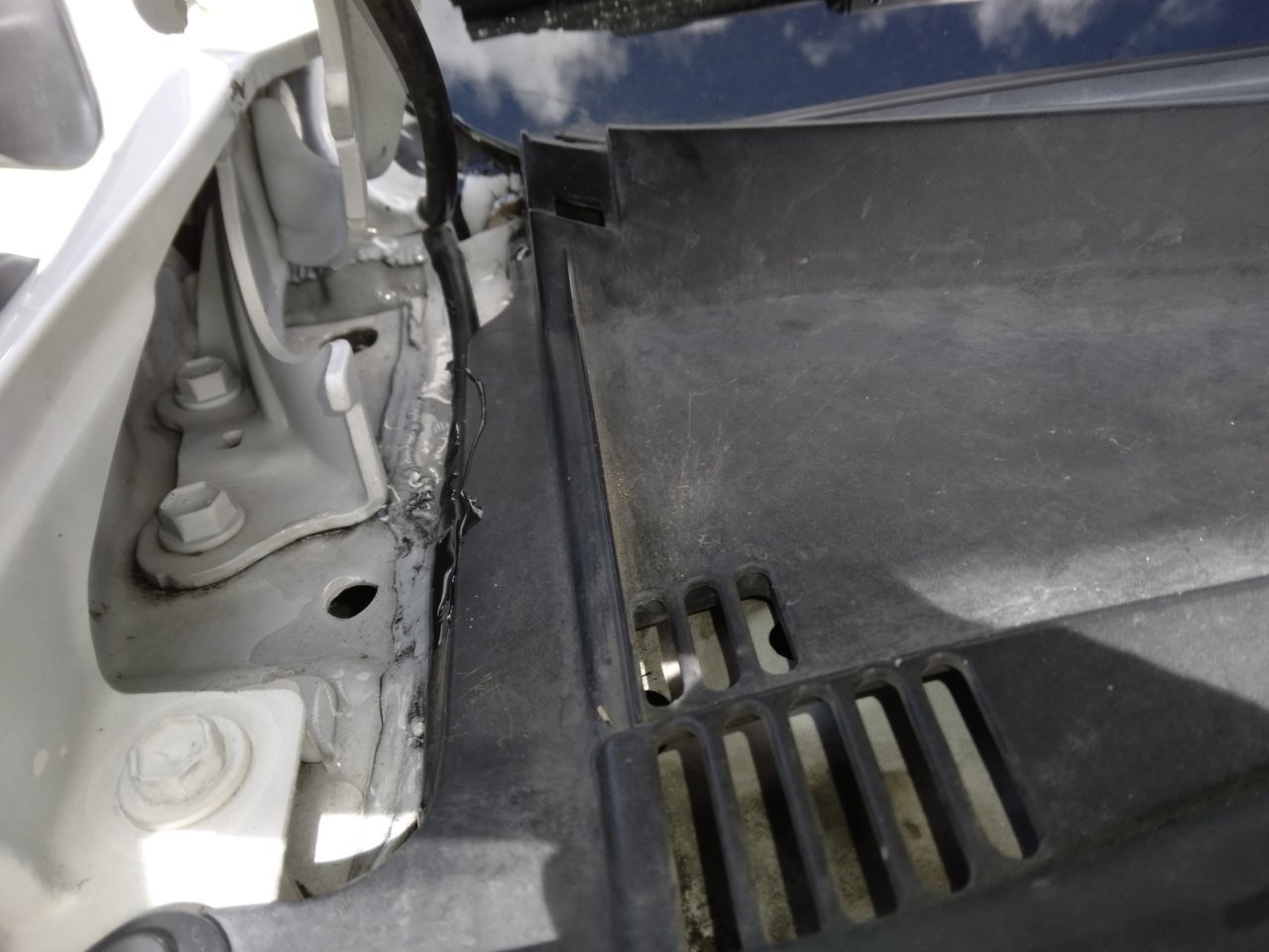

    Went to put in some weather tec mats and found a pool of smoked carpet ...peeled it back and traced the leak to corner of hood/window/hinge ...put some dap on it ....to seal it up ... hope it works will update when dry

    I would check the cowl area for water intrusion. Lift up windshield splash to inspect further. I would also check cabin filter and blower motor area. Common issue on 2nd gens. Best of luck
